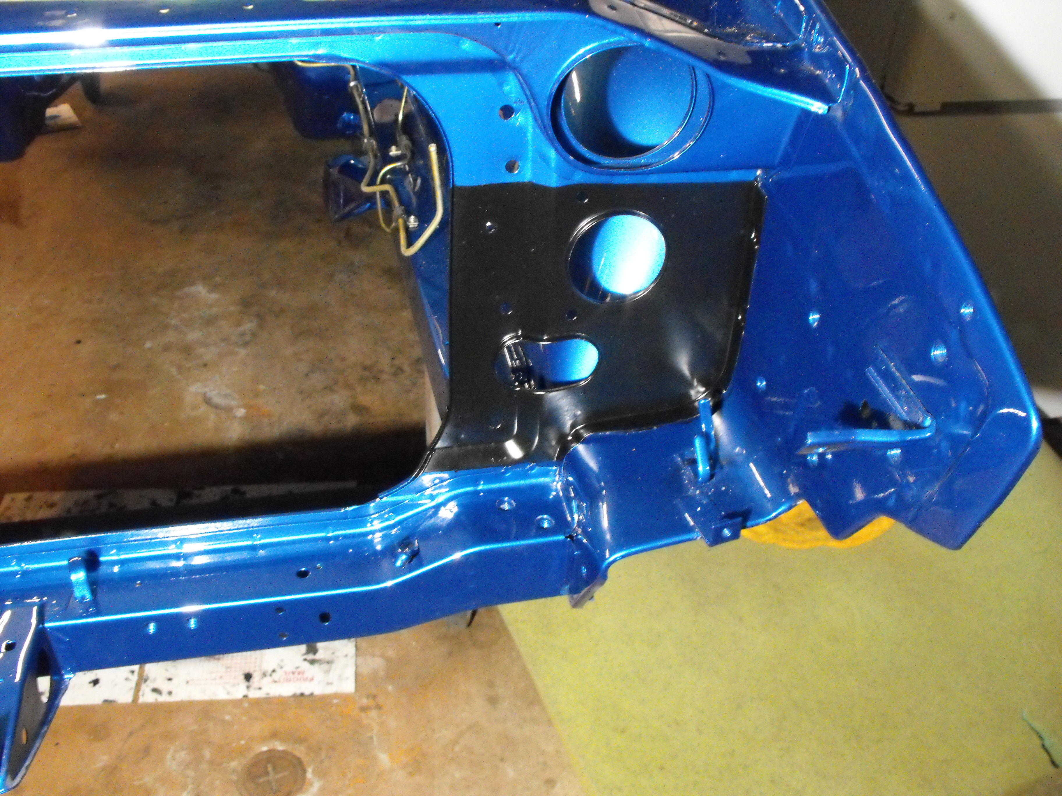

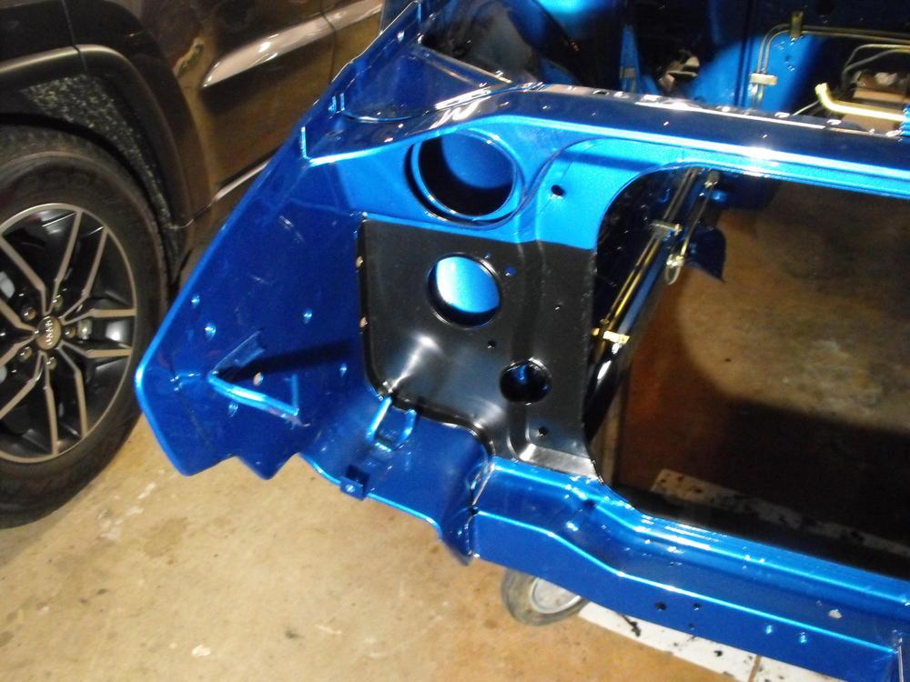

Painted the engine bay front panels satin black.  Also installed a few more parts; coil bracket & hood prop (Just a side note: with fresh paint, pretty much all holes need to be re-tapped before installing screws, otherwise they don't go in very well ?). Polished up and installed the trim that goes on the rain gutters.  Also cleaned up the spare and set it in it's compartment.

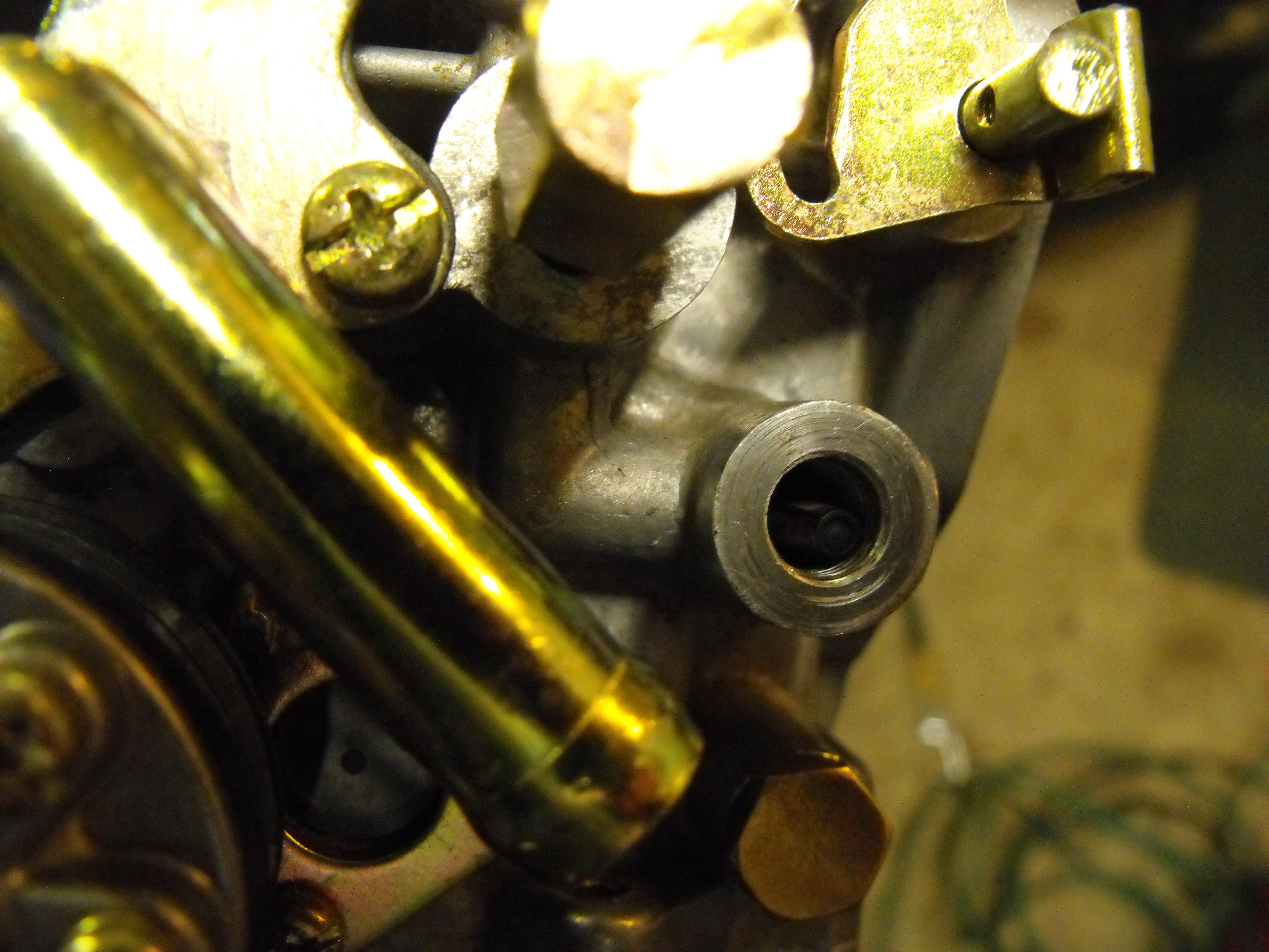

@Captain Obvious you were right about the filter being too long.   I set it in the carb and it is pretty close to the threads as you can kind of see in the picture.  Looks like I will need to find a different method.
