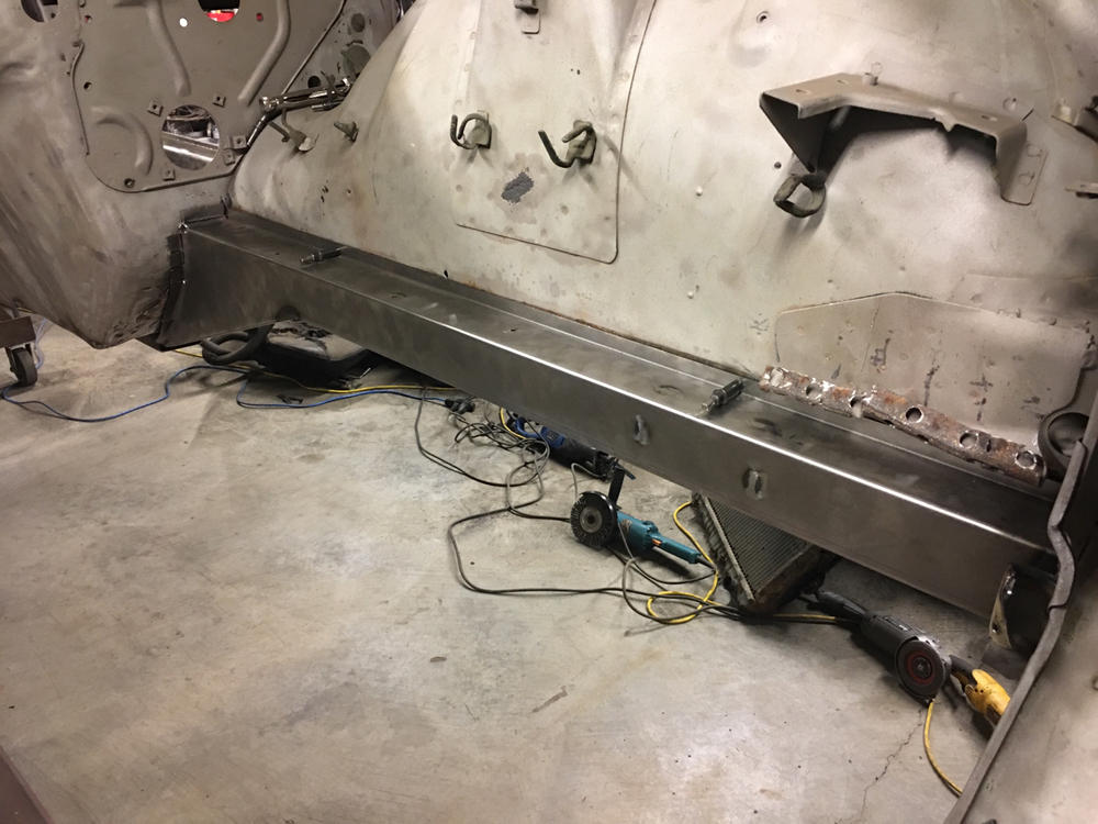

Gotham, any reason you don't or cannot fix it yourself? learning how to use a mig is easy, they can be had for cheap, sheet metal is cheap and besides that...all you need is a hammer and an angle grinder.

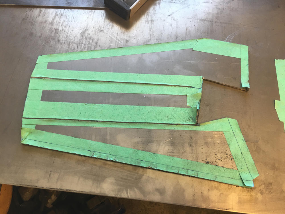

Start by exposing good metal with a flapper or a fiber disc, next draw a pattern to cut and chop it using a metal cutting blade. trim cardboard to the size of your cut, transfer it to sheet metal. if it needs to be curved...that is where the hammer comes in, once you trim/form the sheet to the hole ...line it up and tack it in place, continue stitching it 1 inch at a time to minimise distortion, work on one side then switch to the other. finish cleaning the welds with a flap wheel to perfection..apply seam sealer where needed.
Even a novice welder (that cares) will do a better job then any commercial body shop (that don't). I'll bet you can get it all done for an total expense of about $500...including buying the mig (ok, using shielded wire, no gas) grinder, assorted wheels and sheet metal...unless you score a killer deal on a used mig setup.
It's really easy once you get the hang of it....it doesn't take long to get to "getting the hang of it".

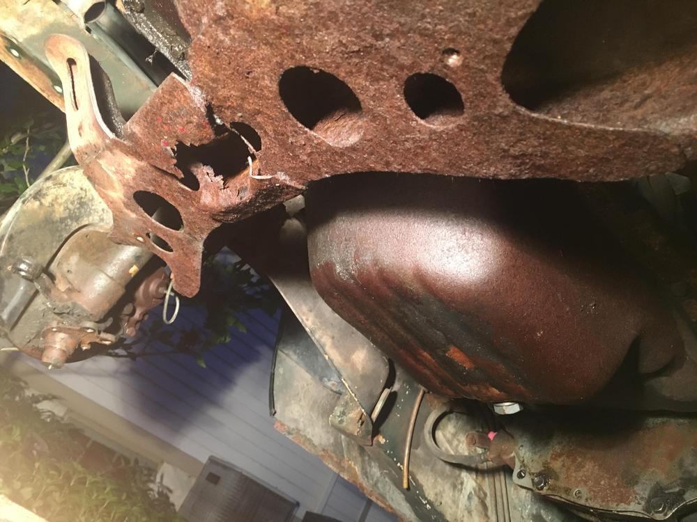

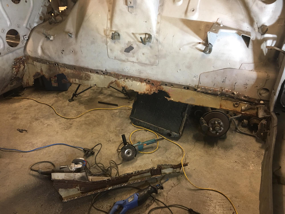

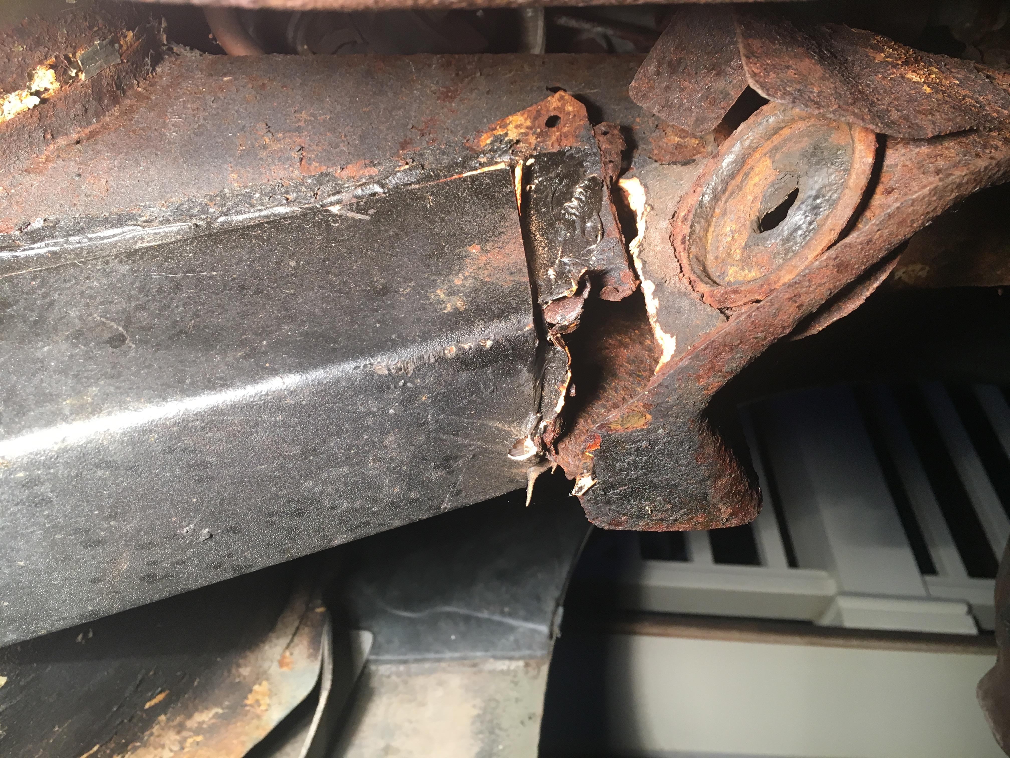

You're not still driving that are you?  The first and second picture are concerning.  It doesn't look like there is any structure left for the tension rod.  I gotta be honest with you, I'd pass.  I think you'd be better off trying to find a shell from California or Arizona and using the parts from your car to make something road worthy.

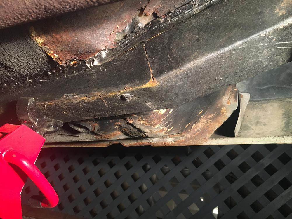

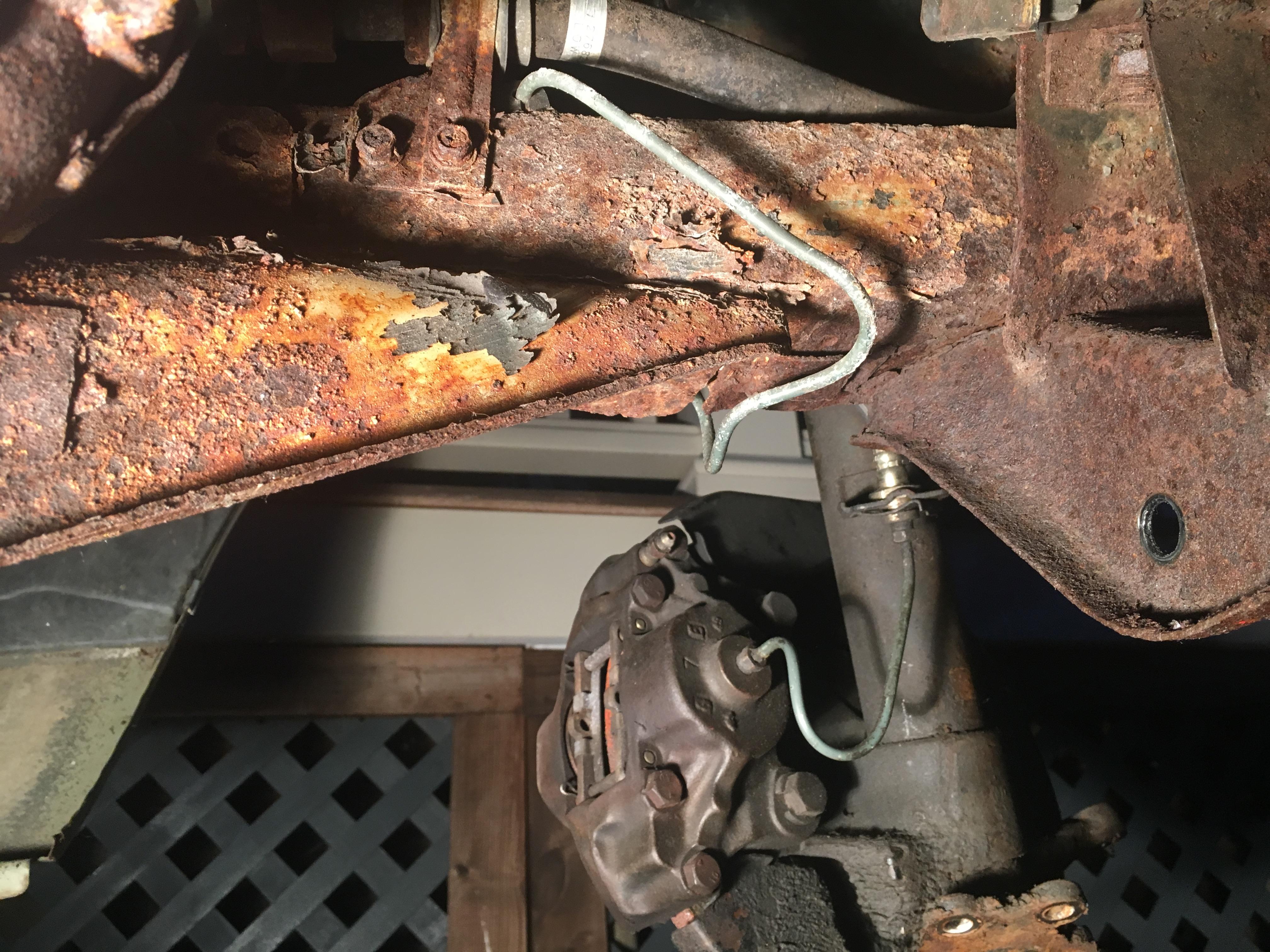

Weird that the one side would be that bad, but the other side looks fine. And I don't see a lot of rust on your floors. I agree that the whole car needs to be evaluated before you continue, if the damage is limited to the driver's frame rail, then I would consider fixing it to be worthwhile. Wonder if the car was in an accident, or if someone was really sloppy when topping up the brake fluid. But that wouldn't really explain the condition of the crossmember.

Also, does the steering cross member need to be replaced?  Or can it be reinforced?
I have an extra crossmember. I will even sandblast and seal it for you before shipping. No hurry $50 you pay shipping. Shipping is maybe $10. Reinforcing it will work if you use the proper gage of metal. Once again it has to be welded into place. Did you ever think about moving away from places that salt or sand the roads? My goodness don't think I have ever seen a crossmember rotted through.
