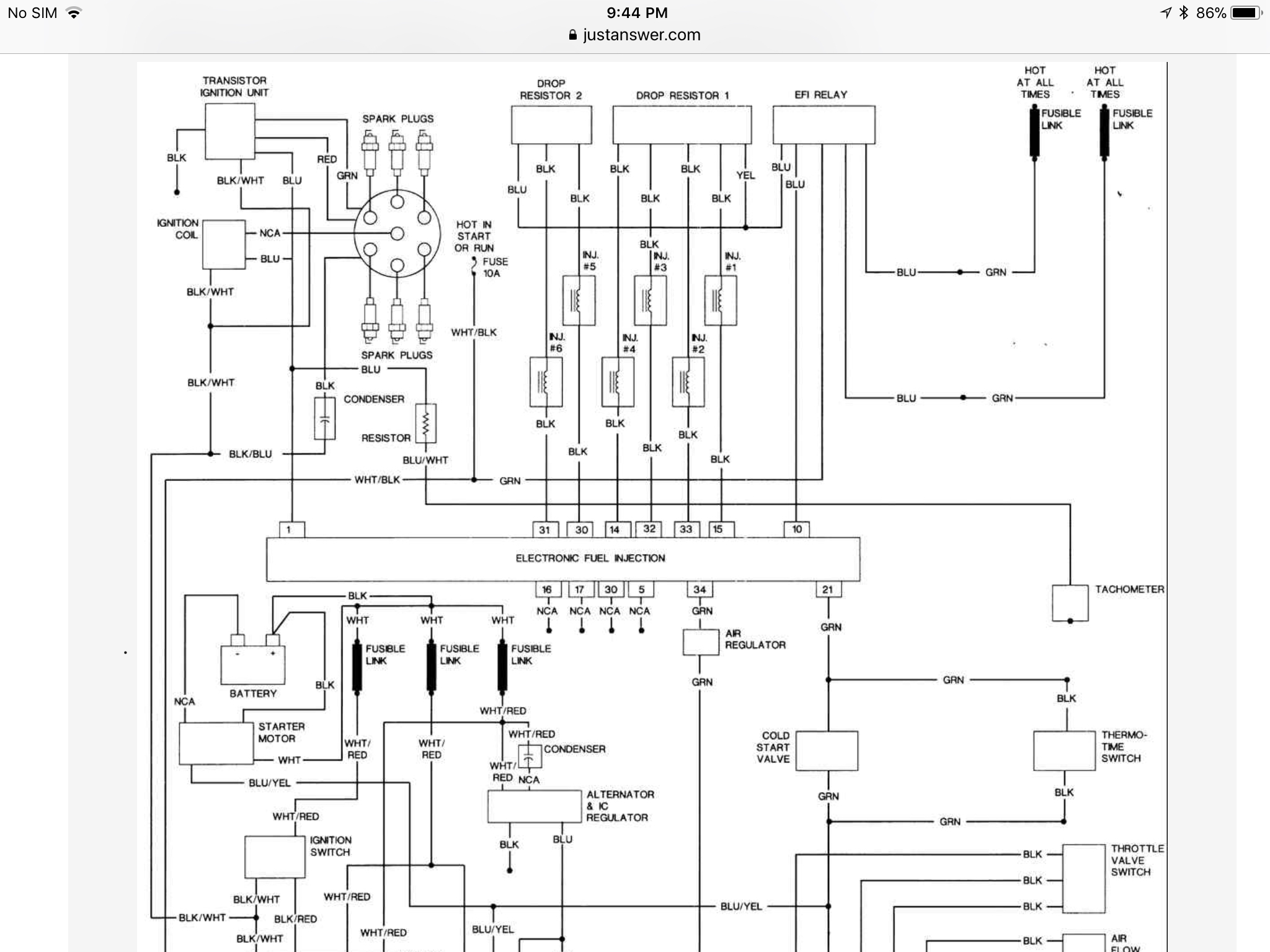

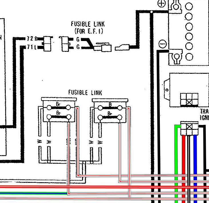

Correct there are 4 fusible links and I have power to 2 of them and according to the FSM schematic that seems correct?

I'm a newbie to Zs but if I read the FSM electrical schematic correctly, jumping the fuse box is essentially bypassing the ignition relay?  Correct me if i am wrong.
I was posing the question in general. I don't know the EFI cars that well. I will have to defer to some of the other guys.
