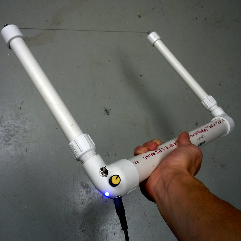

So how about the inside, do you think the headliner foam is soft enough to accommodate the patch panel without leaving a rectangular bump? How about some sort of hot wire foam cutter? you would only need to shave a 1/16"
Adhesive hole fill is what I'll do.
I'm using the MSA head liner, which has darn near a 1/2 thick foam backing. Should hide the bump. Black is the color so even if it's vaguely visible, no one will notice. I could scoop out a 1/16" of foam over the patch if I get creative.
Pretty creative foam cutter there. Got plans for it handy?
No I don't, it's not mine but it doesn't look like it would be too hard to figure out.
