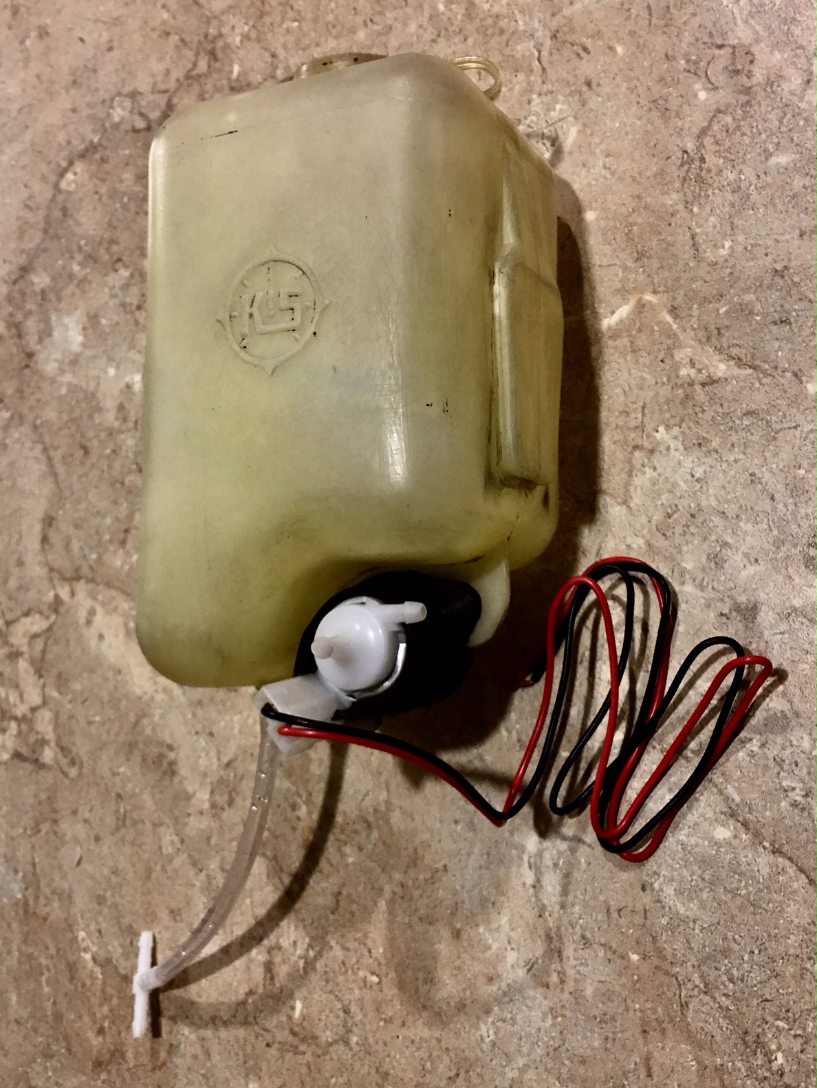

I'd start with a razor scraper and dry sanding with a 220 grit sanding sponge.  Then clean it all up with mineral spirits and the sanding sponge.  That's how I got it off fan blades.  3M makes a safe stripper I've seen at Lowe's, never used it though.  Good luck.
Paint remover to remove paint. Even DOT3 brake fluid works well. Safe on the skin and leaves it with a silky feeling I find refreshing.
Abrasives will scratch plastics. I remember some thread here about treating/bleaching the yellowing. Don't remember what was used, mostly that it was a bit of a process....

Test a small area with MEK or acetone.  If it's a lacquer it might come right off.  I think the tank is made of nylon (polyamide) which should be okay as long as you don't soak it in solvent.
Found a nice reference chart, if you don't have either of those.  Nylon 6 and 6/6 are similar.
http://www.plasticsintl.com/plastics_chemical_resistence_chart.html

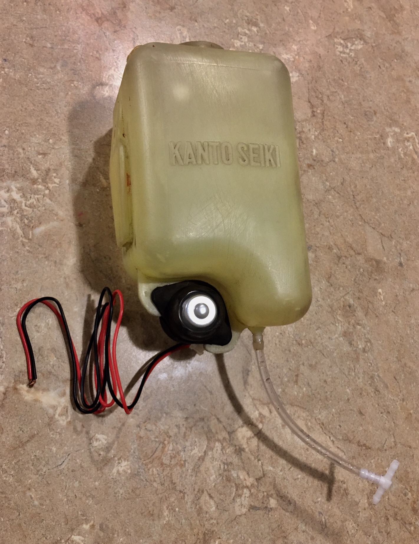

Thanks for the various suggestions (and comic relief as well) I decided to do try the "Chore Girl" suggestion, though now my attention is to research that soda blasting method for other parts of the vehicle ... A small amount of scratching of the plastic was observed, but overall I'm pleased with the results.  Equipped her with a new wiper motor and getting ready to install her tomorrow!

Nice job. Now spread some hair bleach paste all over it, wrap it in Saran wrap and set it out in the sun for a day or two and it'll be nice and white.
Edited by dmorales-bello
This is not the exact application but it covers the basic steps for bleaching plastic. You might find it helpful.
