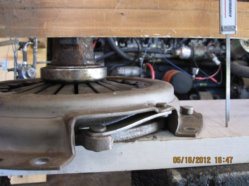

Is it out now?  Take the measurement shown in my picture.  Should be around 92 mm to the surface the fork rides on.  You don't seem to be measuring anything in yours, the tape is just laying there.  The bearing looks right.

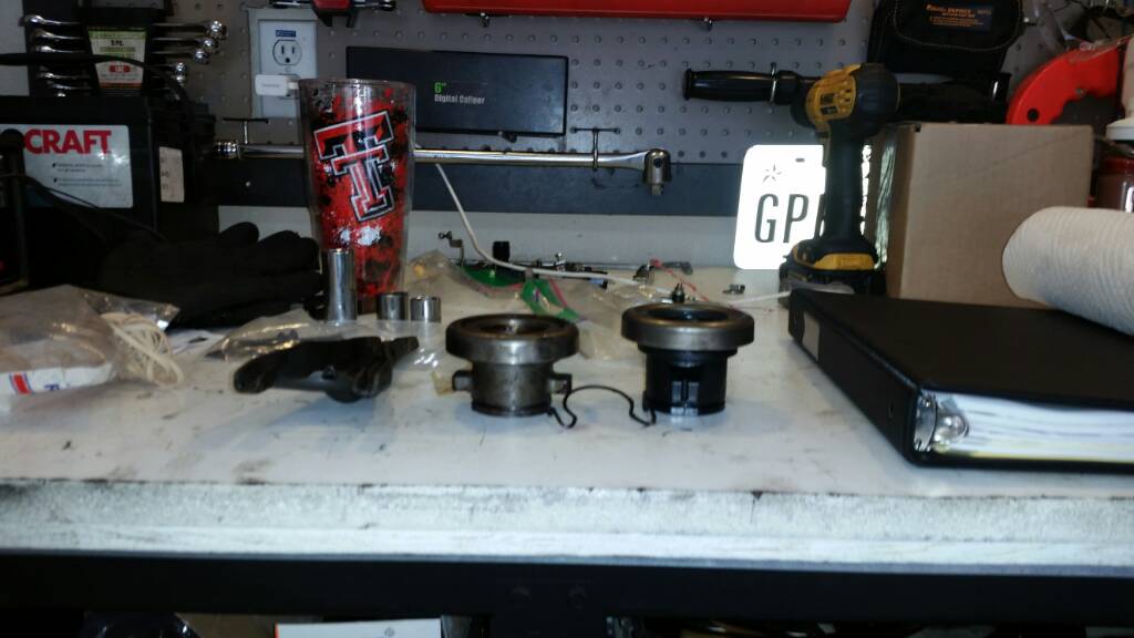

I had the exact same problem when I installed a new performance clutch. I left the original thrust bearing in place and after installing the new clutch I could not get it to engage. I contacted the clutch manufacturer and they provided a new significantly taller bearing. Once I installed the taller unit, the clutch would engage and it just required a little adjustment at the slave cylinder. Works perfectly. See picture of bearings side by side. Shorter bearing would not reach the pressure plate...20170618_095751.jpg

This is what Zhead is talking about....92 mm is what you are looking for....more or less and it's trouble!

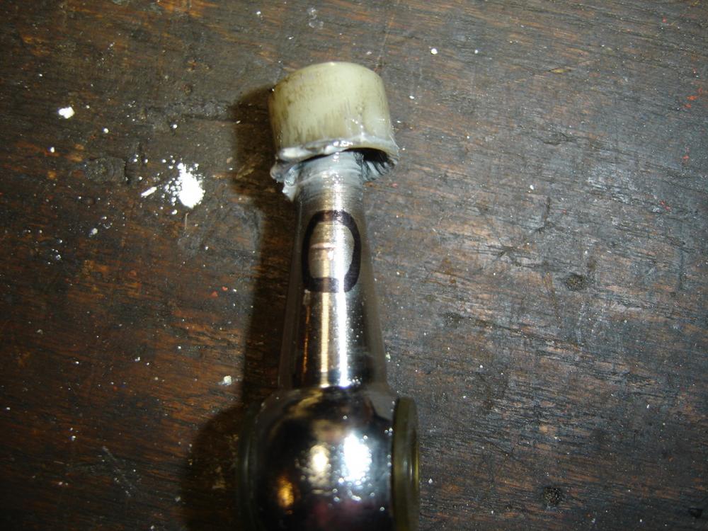

If the taller collar doesn't let it go in gear you may have the same thing I ran into when I put a zx 5 speed in my 240. The shift rod had to be ground a little above the pivot ball on bottom. It wouldn't go in 4th and reverse I think. I'll find the thread and post it in the morning just in case that might have some interference as well.

If your's won't go into any gear it's most likely what Zed head and Diseazed said above, you need the taller collar.  Mine would go into a few but pop out of the rest when I released the clutch.  Anyway, here's what fixed mine.
Here's the attachments I found.  The Sharpie circles are where it was hitting.  I ground those spots down.
And the fix for me.

The measurement is 3 5/8 in. - which is 92.075 mm.
 The measurement in post #5 shows the top of the fingers being the reference point.
I think that's where his steel rule is sitting.  Looks right.

But, the pressure plate and collar look like a good matched set.
p.s.  You know, if you put the wood on the top and the steel rule on the side you wouldn't have to do the conversion math.  Just saying....
