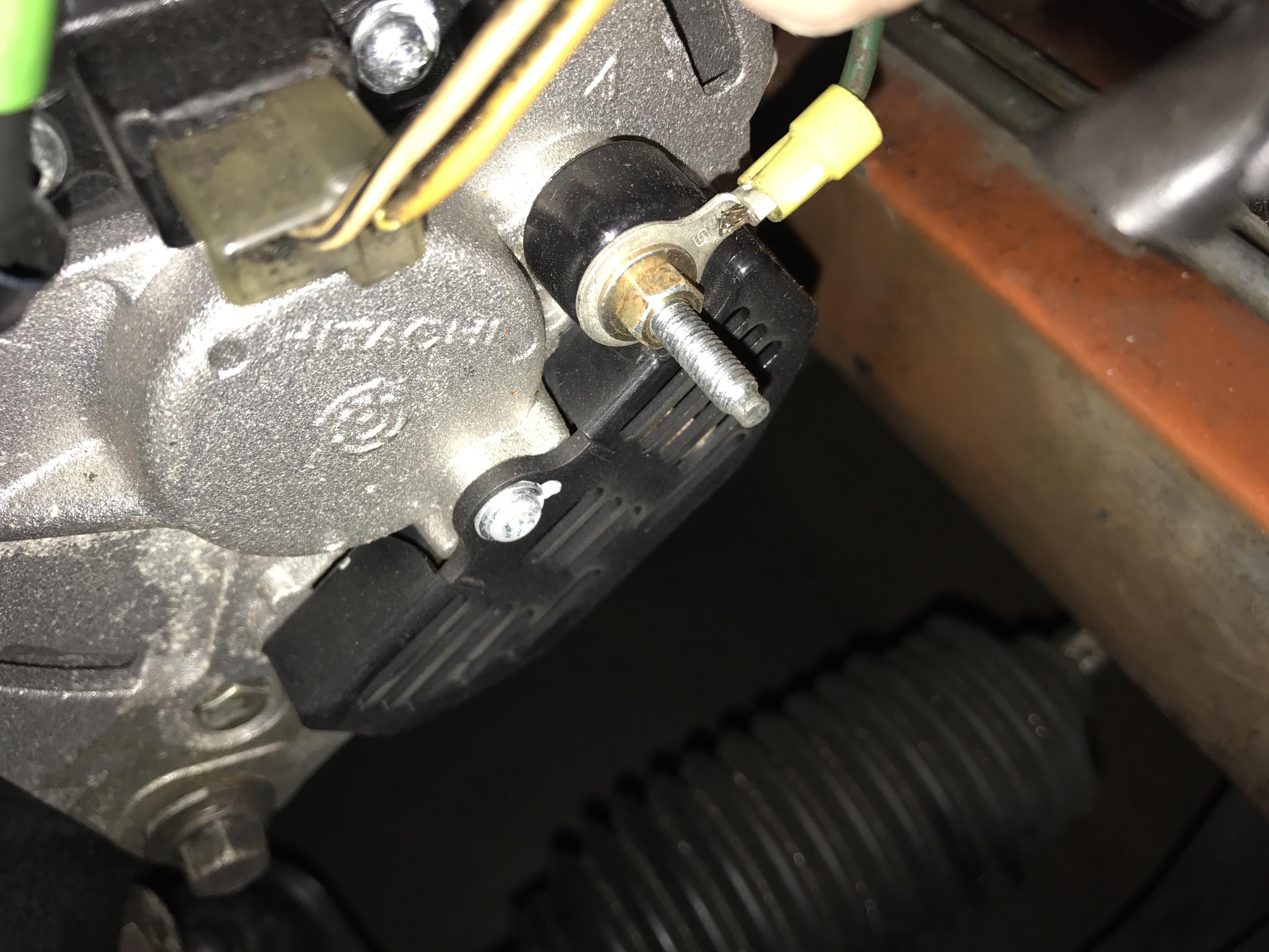

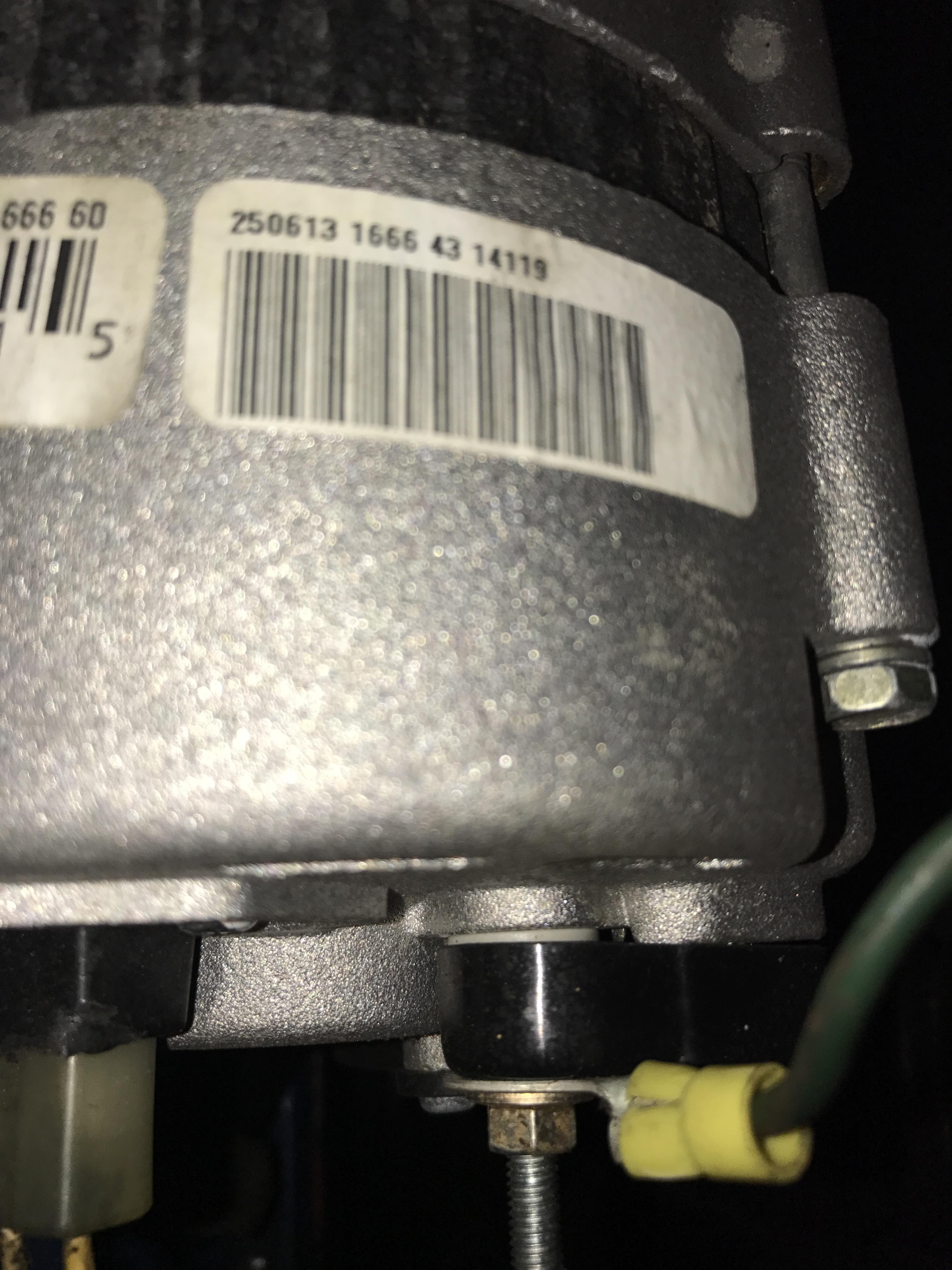

What is the rated output of the alternator? Is there a part number on the housing?
Attached pics of the alt.  Hard to get a pic with the coolant hose running right over it.

Should there be a silver capacitor looking device bolted to one of the holes in the back of the alternator?
That looks to be only on internal regulated alternators..from what I'm seeing?
Looks like the alternator I have is a 50 amp?
I'm thinking of upgrading to MSA's 60 amp internally regulated alternator...that would trouble shoot the alternator and VR it seems....
