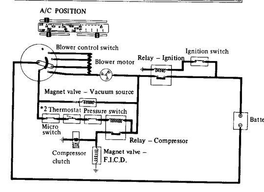

Did you get one of the old timey mechanical VR's?  Or sold-state?  From Rock Auto?
I don't see that anyone measured voltage at the AC compressor power wire.  That would be good to do.  The compressor clutch grounds through the mounting points, apparently, actuation comes when power is applied through the wire.  There's two relays involved.  But you can start at the end of the line and work back.
2nd edit - I had wrote something about the blower motor then second-guessed myself.  but it looks like the blower motor is in series in the circuit that actuates the second relay.  It's an interesting diagram.  Still, test at the end and work backward.
