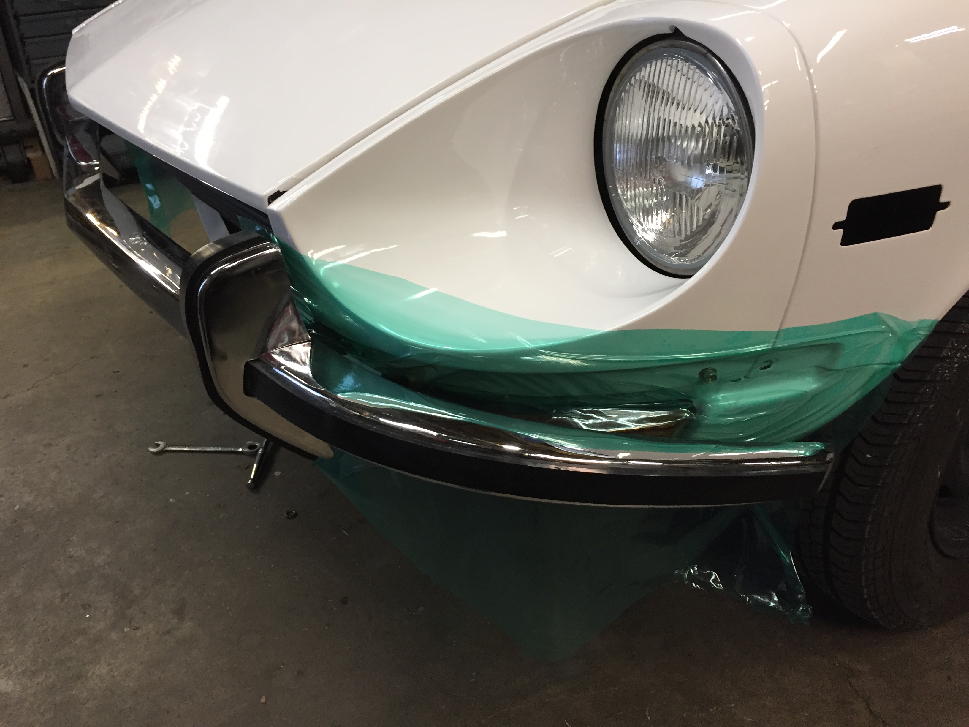

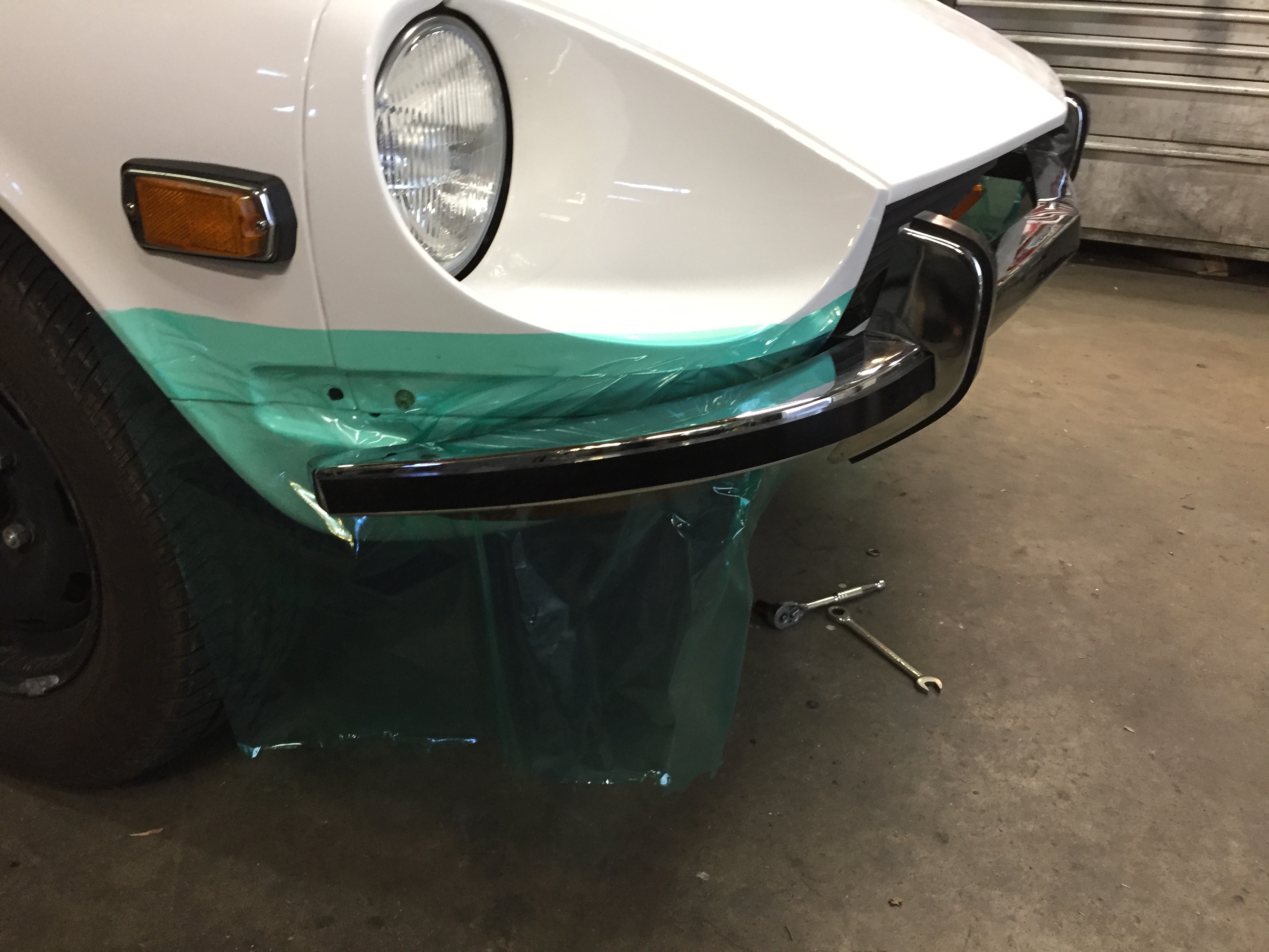

Today found another use for this stuff.
I'm putting the bumpers back on after some "improvements" (rubbers, more on that later), and as usual when doing this, I'm concerned about the corners scratching the paint on the fenders as the bumper is placed onto the mounts. I would typically wrap the bumper ends in towels or something or tape sheets to the car.
Not today. I just cut a couple of 18 x 24 in pieces of this stuff, (reused the stuff I used on the fender yesterday) stuck it to the car on both sides, and slammed on dah bumper. Then peeled those pieces off and put them on the back to do that one.
Check out those rubber strips. They are not stock or repro's. They are however, cheap, lovely and easy to get and apply. Meat for another thread.
