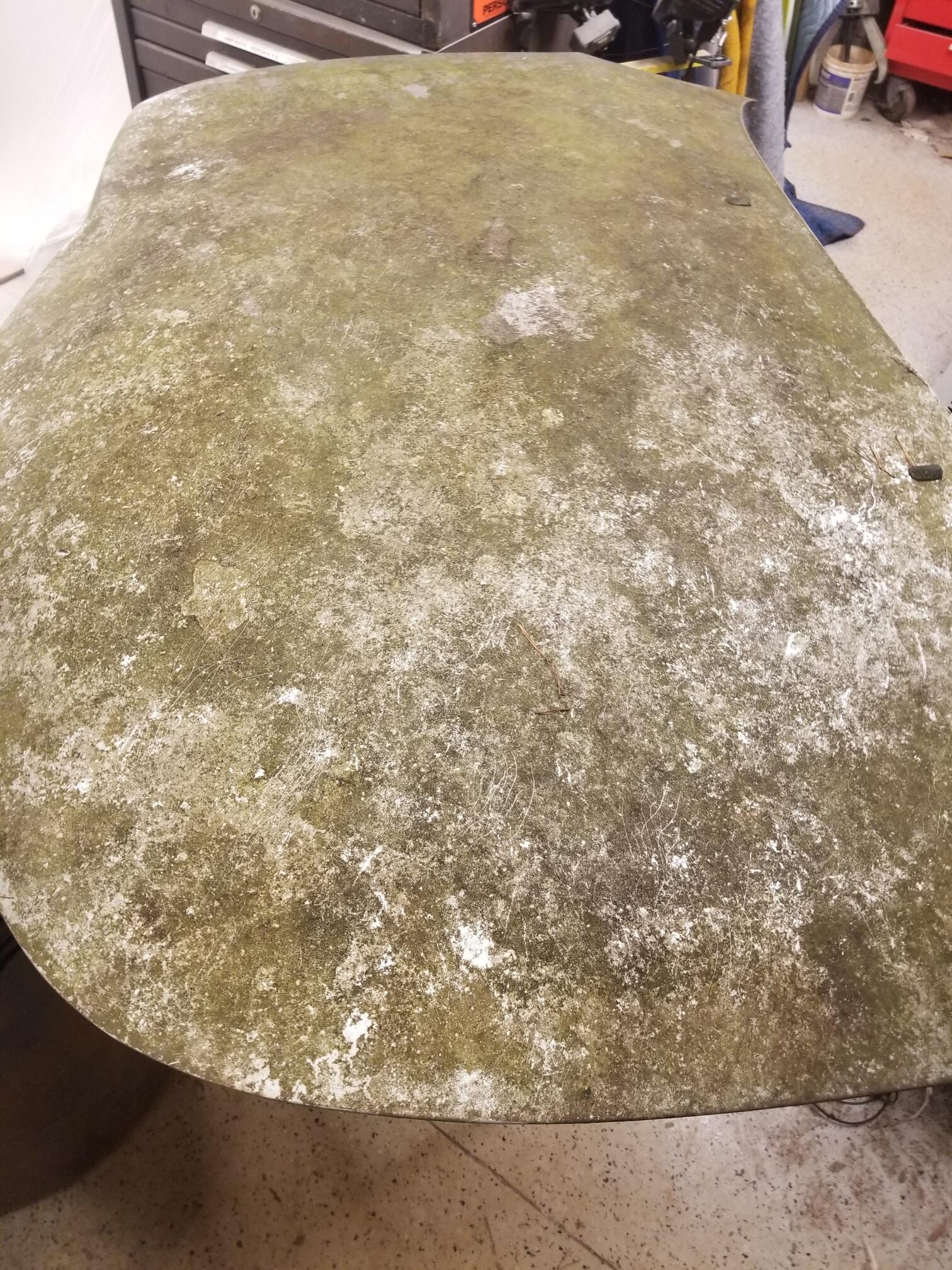

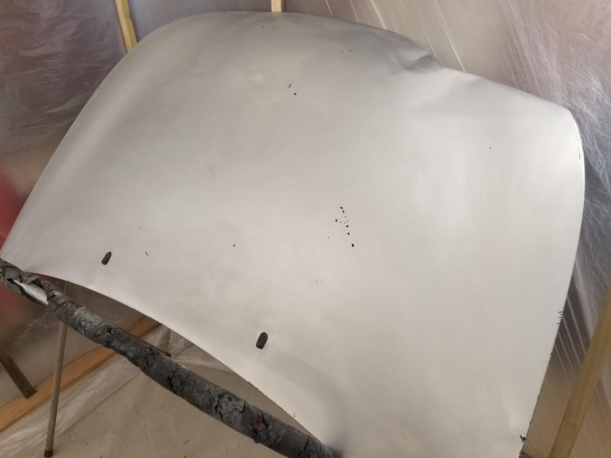

I made a test panel today. Pulled an old junk hood out of the yard. Covered in green funk.
Scrubbed it with warm soapy water, degrease, wet sand at 600, then sealer.
Still have some funk in the sealer but maybe not as much

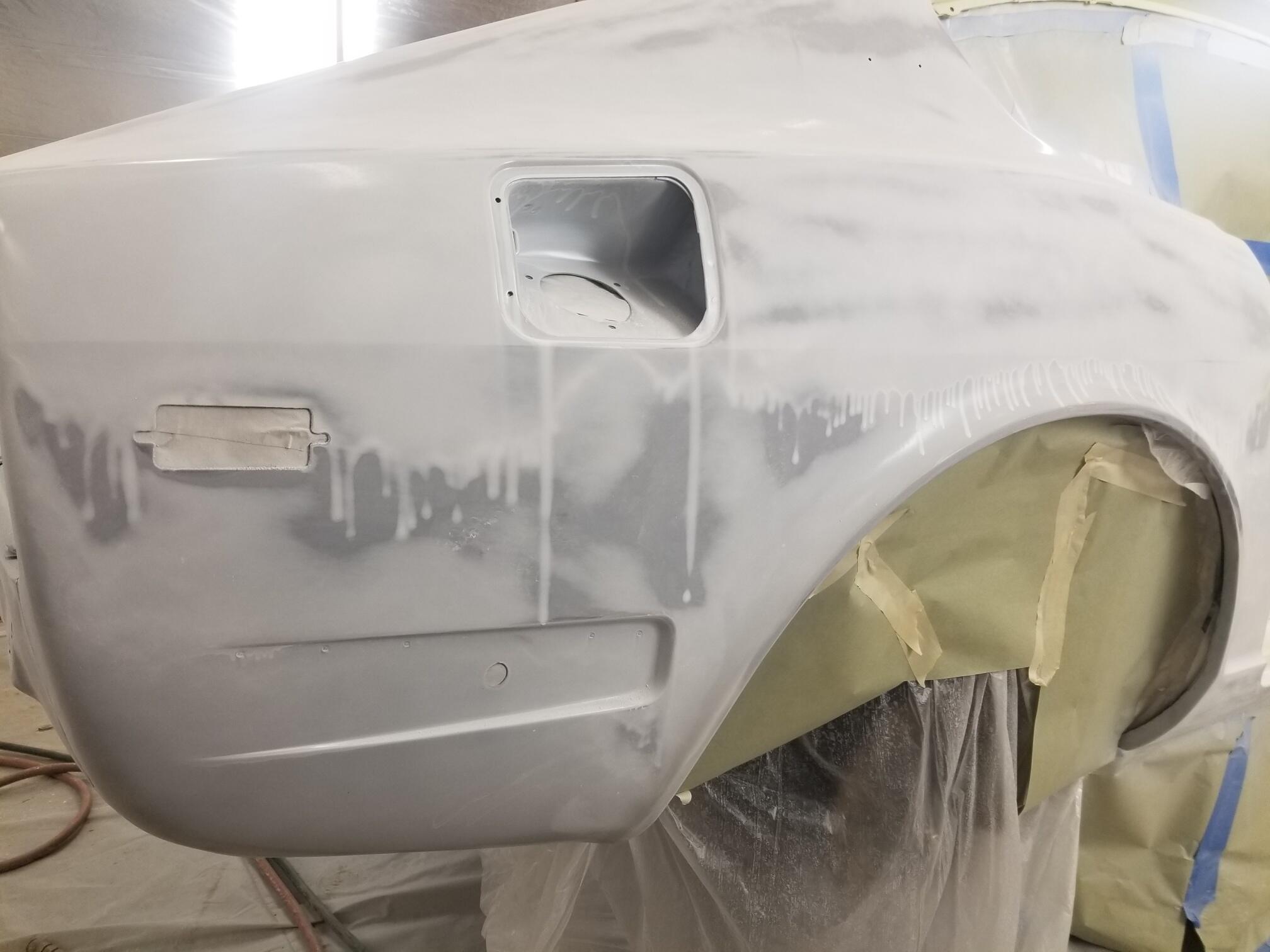

So I spent over an hour at finishmasters today. The general consensus is the sealer wasn't mixed enough but we can't account for the specs. He did some testing on the can but it didn't show a problem. It's possible the catalyst is going bad. Either way I'm not going to use any more of the sealer going forward. I will use white base coat like I originally did. The bad news is all of the white sealer needs to come off. It's not very thick but it's hard! I've already cut through in some areas and my blocking is already ruined in many areas. So I won't have a car ready for Zcon this year 😞
I have pushed pretty hard this fall to get the car ready for paint and now I have 60-100 hours of sanding to get back to GO. Then I will need to reprime, block, retape, rebuild the booth, etc.

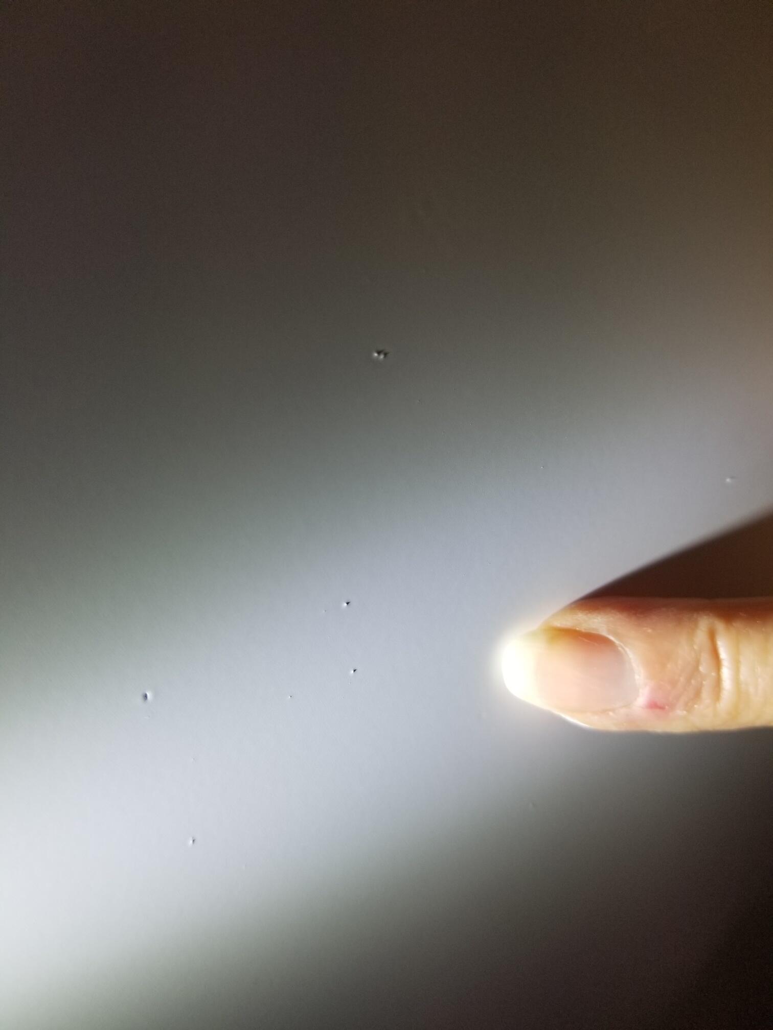

I always have some trash in my paint no matter how hard I try
Just a thought.. could it come from lose (rusty) dust from a compressor tank?  Is there a airfilter on the system?
I also can feel your pain.. i once had to paint a bike (motorbike) and i had terrible problems with silicone in the paint... after 4 ! times i was happy with the result... pfff... 4 x high gloss black..
Have you asked the boys on autobody101.com? Got to ask, are you filtering the sealer through a 50 micron mesh cone filter into the cup? Do you have dry staticy conditions at the moment that could be attracting trash ?  A ground cable to the frame and a final alcohol wipe can help.
I have had so many problems with sealers that I just don't use them anymore, high build urethane primer sanded to 800 then colour coat on top of that.  I feel for you man, get Cody in there and put a block sander in his hands.

I don't think air could be an issue. I have a very high quality redundant air filtration system.
I am filtering through cone filters that are evidently 150-200 micron filters. I haven't seen 50 micron filters
It is possible that static is an issue sometimes. Although it had rained the day before and was fairly humid so static risk should have been low. I have not been onto Autobody 101 to ask. I guess that could be an option. At one time I did have a ground cable to the chassis but have not done it in a while. The alcohol wipe is a good idea.
I don't know that I will use sealer again after getting burned like this.
