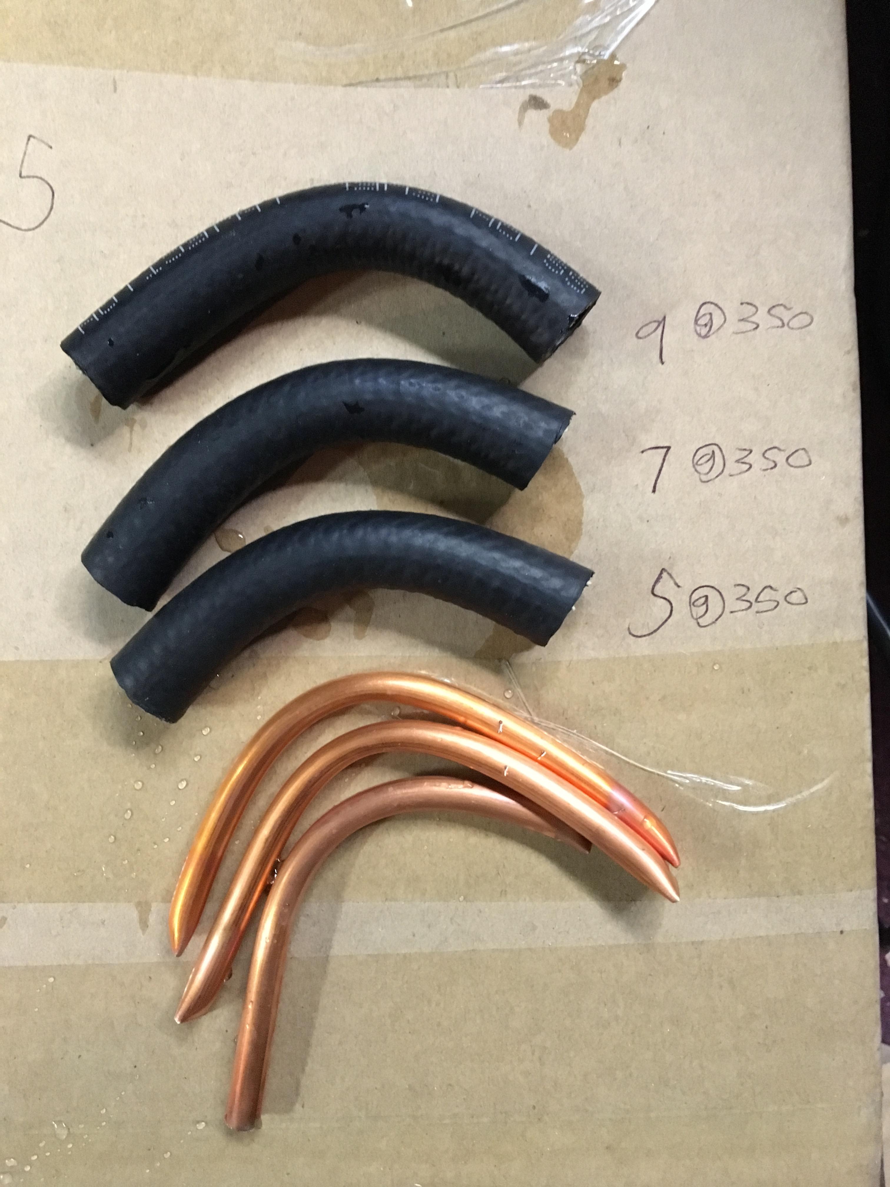

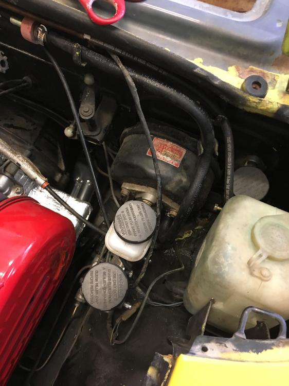

I know this is a really old post, but I thought I would follow up with what I learned. I tested baking hoses and it works quite well, here is what I did to form my own brake booster hoses.
I started by testing a few pieces at 350 degrees for 3 different times with 1/4 od soft copper pipe to hold the shape, the first one I tested with my tire pyrometer to see how hot it was (hotter than 200 degrees in the middle of the rubber and that is the limit of the pyrometer, so I didn't test the others). I decided to go with a 7 minute bake, as you can see all three held their shape, 9 minute stunk a bit more so I went with the middle of the 3 for my final bake.
I used 3/8" fuel injector hose which fit perfect, and has thicker walls than some of the other vacuum/fuel line hoses. For the real hoses I greased the copper tube so it would be easy to get out. I baked at 350 for 7 minutes, and the hoses stayed quite nice, not quite as tight as the factory lines, but they kept their shape well enough for what I needed.  I think the trick is to  bend them a little further than you need, and when dipping them in water, to cool them, hold the hose a little tighter than the tube holds it while pinching the other sides so it doesn't have a tendency to crush to get perfect bends.
Well, that is what I did and I am satisfied with the results, it gave me a good looking formed hose without the cost of the braided ones, and if I need a new one down the road, I can easily make one for like $15 worth of stuff.
The integrity of the hoses looks great, but I didn't test them in any way other than driving it around. I totally recommend this for vacuum line hoses, but I would want to test a little more before using this method for fuel injection or other higher pressure and higher risk applications.

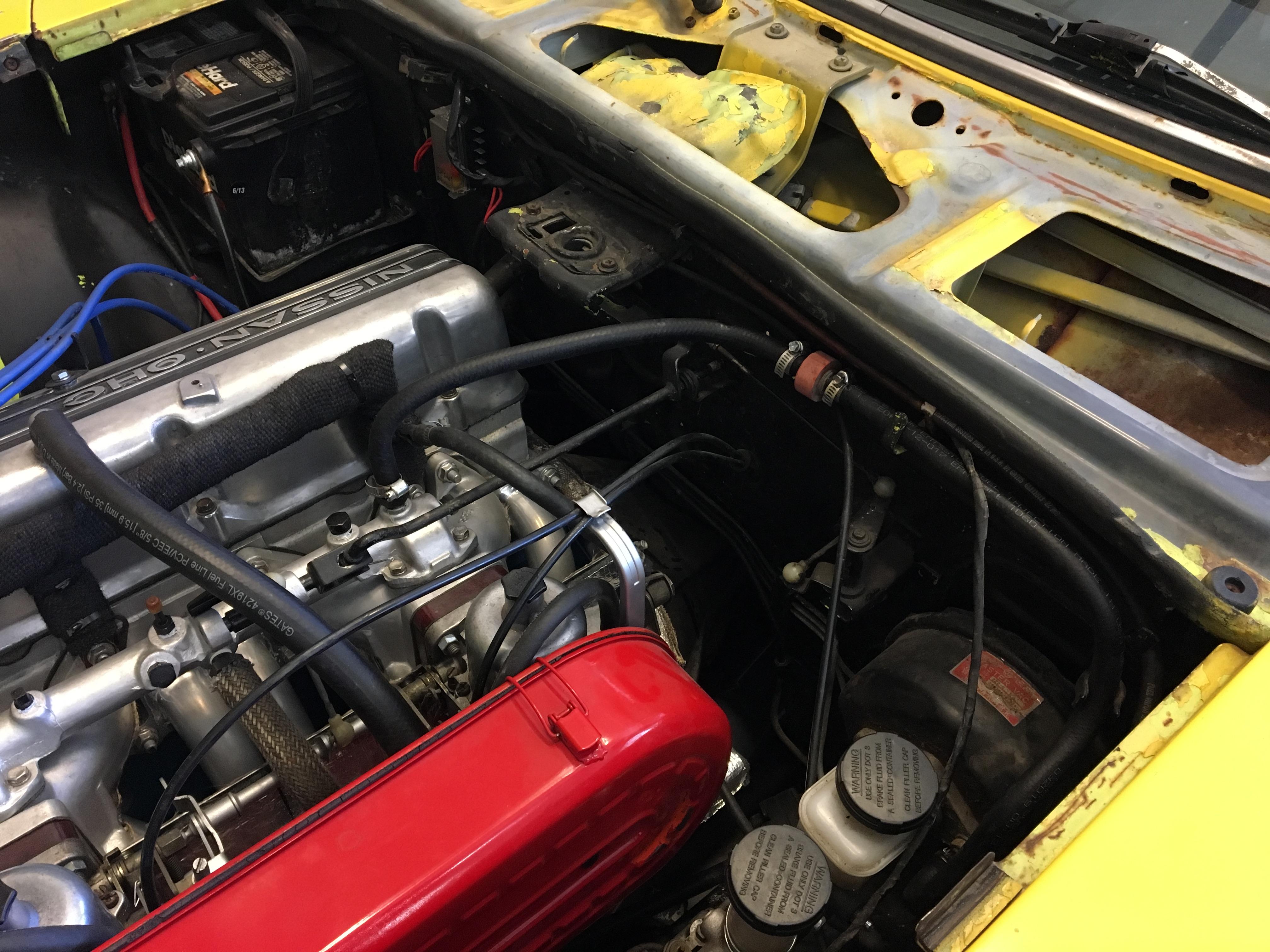

The fittings for the S30 vacuum hoses measure 10mm OD.  That suggests that a 9mm hose will be the correct size.

I was able to buy an OE molded hose at a local swap meet, so -- even though I bought a length of 9mm (ID) braided hose from Bel-Metric for the purpose -- I never got around to trying out the idea. No reason why it shouldn't work, although you might not be able to make the straight braided hose flex quite enough to match the radius of the bends molded into the OE hose. Unless you're trying to build a concours winner, though, I doubt whether anyone would notice. CORRECTION: I just went down to the workshop and pulled out the hose that I bought from Bel-Metric. It's quite flexible and can be easily bent to match the curves of the molded OE hose... and without any signs of the walls collapsing. It also fits nicely over the nipple of the check valve (the one that fits between the engine-side and mastervac-side hoses). The actual ID of the Bel-Metric hose is 9.4mm, so the best size of copper tubing to use as an insert would be 5/16" OD (7.9mm). 3/8" (9.5mm) tube would be too big and I don't think you'll be able to find 11/32" (8.7mm). In any case, the quality of the fit doesn't matter much because there's no fluid flow happening here. It's just a vacuum hose. The only thing that would cause a problem would be if the hose walls collapsed or got pinched off.
