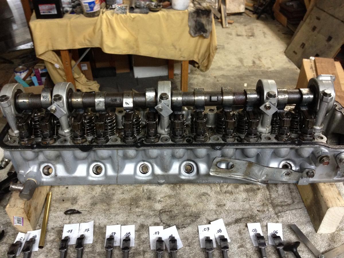

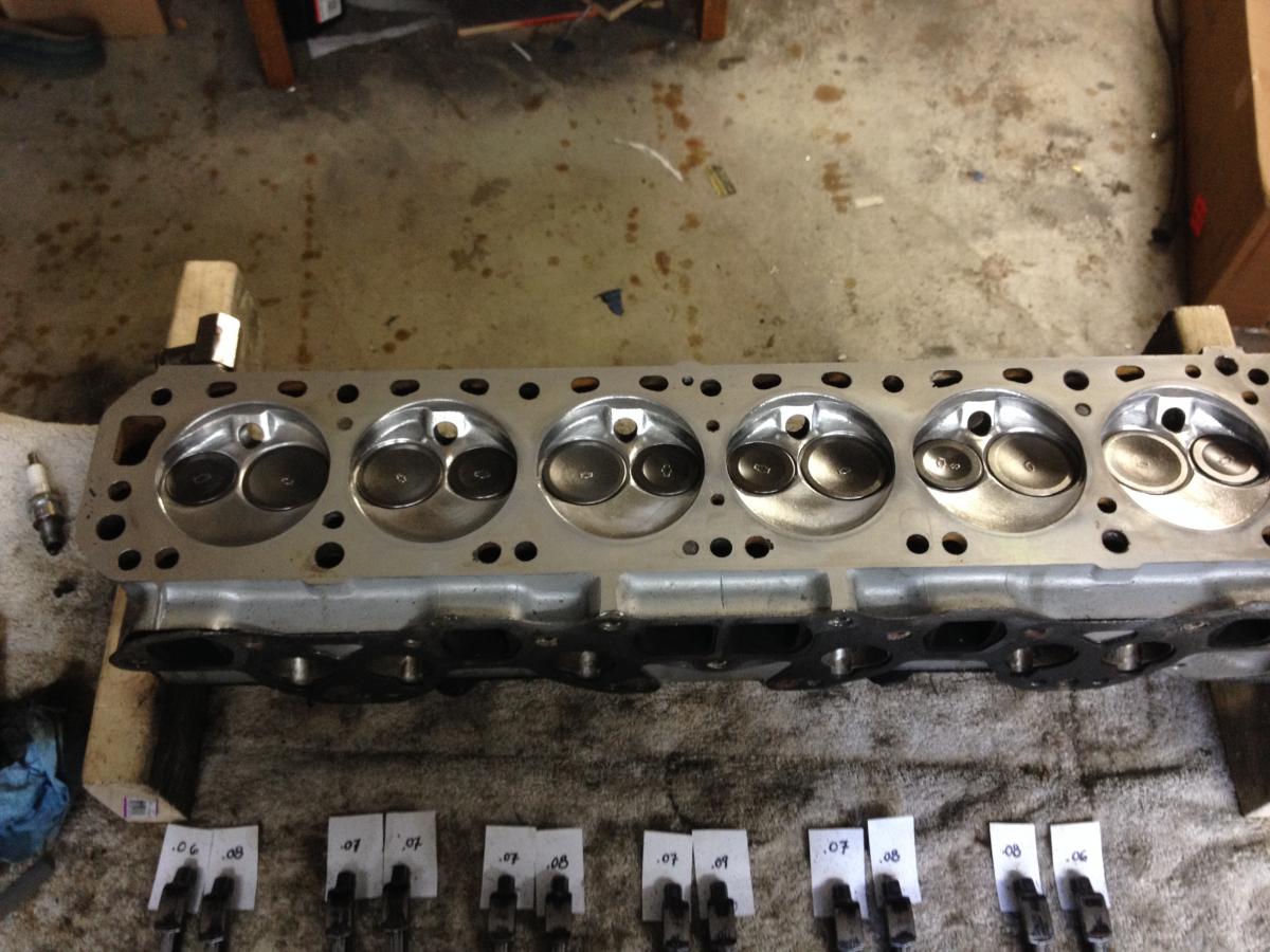

took a moment to think about it and realized the one thing i hadn't measured was the cam... turns out it was the problem - it's a re-grind with higher lift and smaller base circle, and they dropped it into a stock cam setup. i measured every lobe and compared them to the cam in my original N47 head (the one that came with the car) and put all the data in a spreadsheet to figure out how they related to each other.
then, just for kicks, i pulled the cam, rockers and lash pads from the original head and put them in the new one and see how the geometry worked. i kept all the assemblies together (lash pad & rocker w/same cam lobe) and marked the rockers with sharpie to check the wipe patterns. the result: perfect! every rocker wipe pattern lined up exactly as it was on the original head, right in the middle, as set up by the factory in 1978.

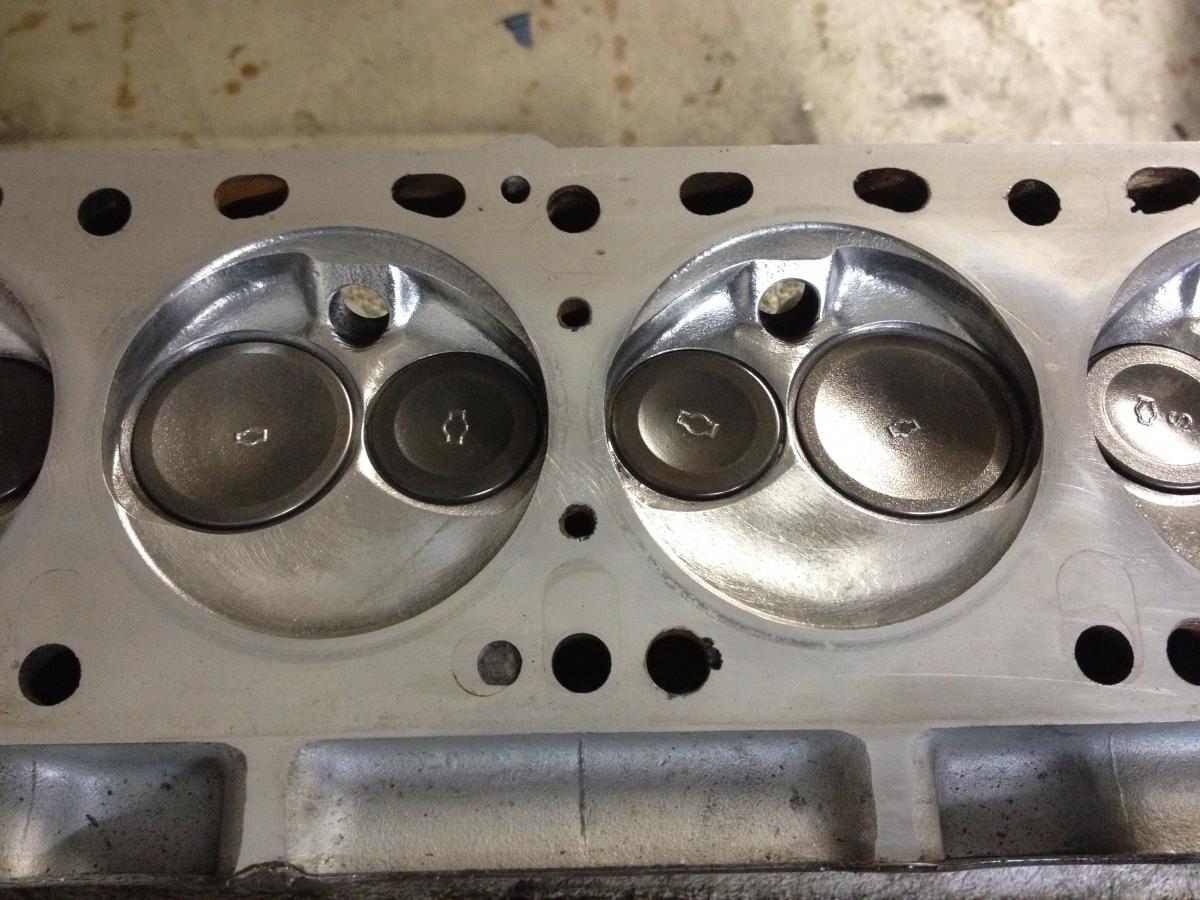

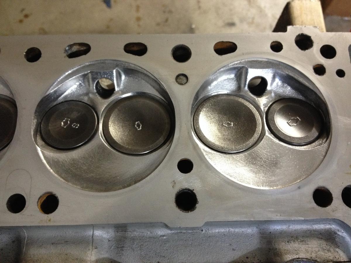

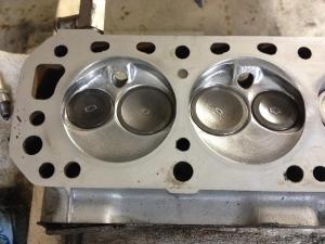

chambers all cleaned up
post-28907-0-39765000-1424667277_thumb.jpost-28907-0-29759300-1424667282_thumb.jpost-28907-0-53053800-1424667286_thumb.jpost-28907-0-81296200-1424667290_thumb.j
well, i don't know if it's the "nail" or not... i was worried that the valve job was done poorly or that the valves were dressed improperly, which in my opinion would have been worse, but the issue was one of somebody grabbing the wrong cam, assuming it was a stock grind and slapping it together without checking the geometry. still a big QC issue, but a more understandable mistake i suppose.
fwiw - i've been in touch with them during this whole fiasco and he's been very open to hear about it and wants to know my findings so he can discuss w/his machine shop. i'm sure he has a shop that does all his heads so hopefully the feedback will assist in keeping this from happening to others...
