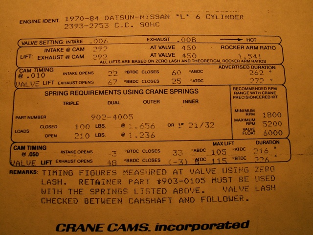

F54 block, N42 head, port and polish, port matched,
Crane mild cam grind on a Nissan blank cam,
Flat top pistons, not sure which ones,
Cylinder bored 0.020" over, 10:1 compression,

You should have full advance before 3500 RPM. 24 + 10 = 34 total. Are you using projected tip plugs? I've read that because they start the flame closer to the center of the chamber it's like adding 4 degrees of advance. That would put you at 38 total. I think that worn weights and the pins they ride on can let the advance move further than stock. A timing light would tell you what you are getting, but 24 + 5 is still 29 total. The pros would say you should get some dyno tuning to find what you really need. Do you feel like there's more power to be had, or are you looking for cheaper gas?
Also, have you measured cylinder pressure? We all talk about CR but it's really the cylinder pressure that matters. That's why the longer duration cam can help, it lowers static cylinder pressure. It will give you a better idea of your starting point for cam changes or head work.
