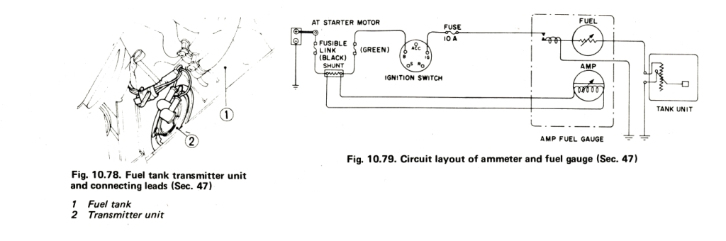

On the thread mentioned above there was the following post:
Nissan man: Refer to the thumbnail attached:
The gauge terminal of the tank transmitter can be temporarily connected to earth and that should force the gauge to read maximum scale, if everything else is working OK.
As mentioned, there are a fuseable link and a fuse to be checked in the Fuel Gauge circuit.
There is also a Voltage Regulator, shown at the LHS of the gauge, which controls the voltage applied to the gauge.
These have been known to misbehave and cause erratic readings usually on the Fuel and Temperature gauges.
Cleaning the contacts on the VR and all points in the diagram may remedy the problem.
I have attached the thumbnail that Nissanman is referencing. However, I have not been able to find this fuseable link, fuse, nor voltage regulator in the fuel gauge circuit. Have I followed the wire completely around the car? No, so maybe that is the next thing I need to do. When I searched "instrument voltage regulator for 240Z" on Google, I come up blank.

If that were my car I would temporarily replace the harness ground on the ground connection side of the sending unit maybe with a wire with alligator clips on both ends. Or put the temp ground on the non ground harness wire that goes to the sending unit and drive around and see if the gauge readout is stable. I would be interpreting your experience as an intermittent connection though I could be wrong.
I know this sounds too easy but do you have the sender unit installed upside down?
The only fusible link in a 71 Z is the one between the Starter and the Positive Terminal on the battery. If it blows or is questionable the COMPLETE electrical system is inoperative or intermittent.
While Nissan/Datsun DID use a Voltage Regulator for some of it's instruments in the Roadster (Sports) the Z didn't. I am not positively sure on JDM vehicles, but I would be surprised if the JDM circuitry included one while the US did not.
The fluctuating power may be due to a bad fuse or more likely a bad connection since you mention that when you short Y to B it reads Full.
I'd check your grounds before you pull the sender and verify you didn't slide the float adjustment out of whack. It's not upside down since you're not complaining that it's reading FULLer as you drive the car, but that it never deviates from the no more than 1/4 reading.

I was wondering if this issue ever got resolved. I have been chasing the same thing on my wife's 72 Z. From my work it seems the feed to the instruments is unstable. The supply voltage at both sides of the fuse is good but the voltage at any of the three sending units, gas-water temp-oil pressures bounces from 1 to 6 volts. The feed to the meters is a yellow- red wire but some where it connects to a green feed line, does anyone know where the two wires connect or is it internal to the harness?
Thanks
That's normal.
The gauges internally modulate the voltages to the sender units. They do that to compensate for ambient temperature and system voltage.
one thing to make sure is the sending unit is installed in the tank so the float moves in a vertical plane. You need to make sure the sending unit is clocked correctly.
Thanks for the responses but they don't explain what I am seeing. When I turn on the ignition the gas gauge will move up to half full then drop down to about an eighth and then start moving up and down between those two points.
Is it just the gas gauge, or do you see the same thing in the temp and oil pressure?
Also, when you say it moves up and down,... is it regular and continuous, or is it sorta random and happens every now and then?
It is only the gas gauge that I am aware of. The needle moves up and down about 10-20 times per minute. I put a temporary ground from a chassis screw that I cleaned well and hooked it directly to the yellow lead at the sending unit. The gauge will run up to full but will then drop down to 3/4 and proceed to oscillate around that point about an 1/8 of a tank in either direction. I have also by passed the sender lead with an external wire from the sending unit to the fuel gauge connector and no change.
Does any one know what the current through the gauge should be for full and empty readings?
