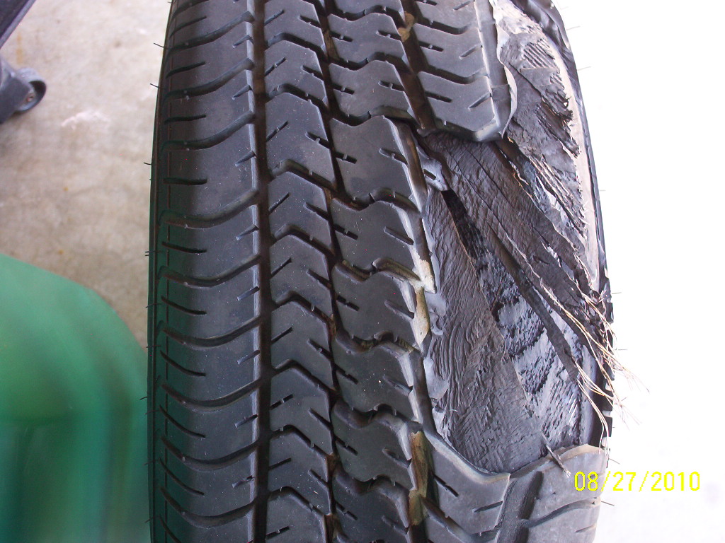

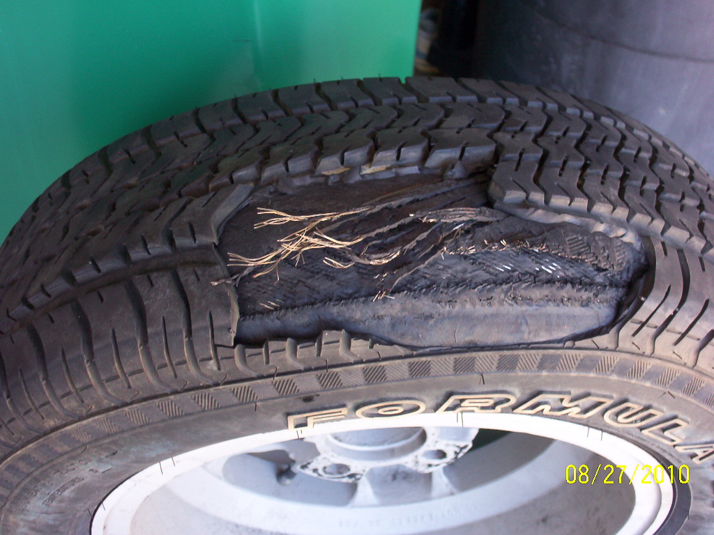

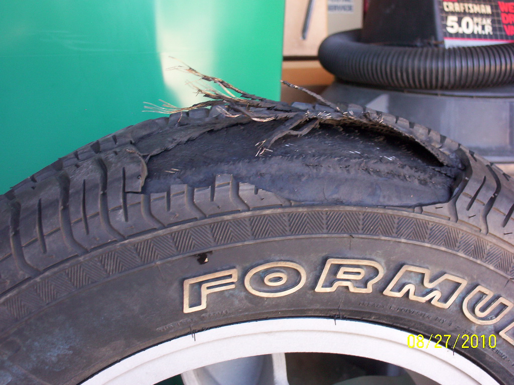

Had this tire come apart on the left rear while on my way home from Z-con in Nashville. No loss of air; no signs of problems on the other three. Happened on I-24S. No indication that I ran over anything; just came apart. Anyone ever have this happen, or know maybe why and how it happens? I didn't trust the remaining 3, so I sprung for a new set.
Looks like a simple case of tread separation. How old are the tires?
Stephen is right. I had that happen with an old set on a Z that I bought from the original owner. Might have been the 3rd set of tires on the car. They separated all the way across the tread on one and about an 8" chunk came off, the other one had a huge bulge where the tread was starting to come off the sidewall, but it didn't let go. Weird part was you could barely feel that anything was wrong from inside the car.
