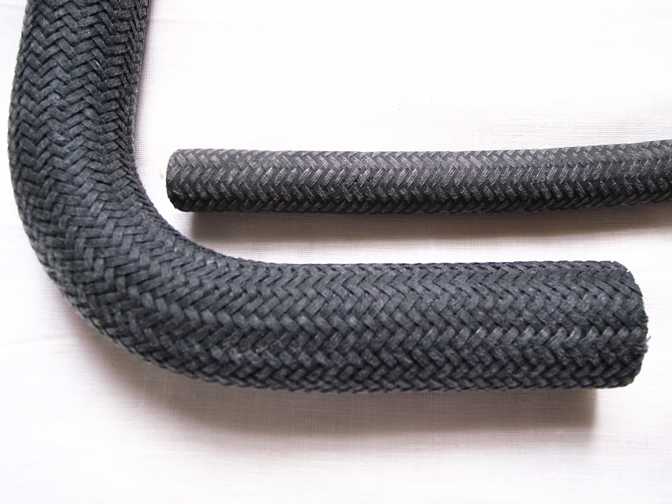

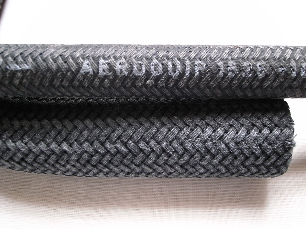

AEROQUIP 1525 in the Grey / Black colourway is pretty good.
Here's a piece of 5/8" AEROQUIP 1525 laid next to a 432 radiator hose. Not too bad of a match:
