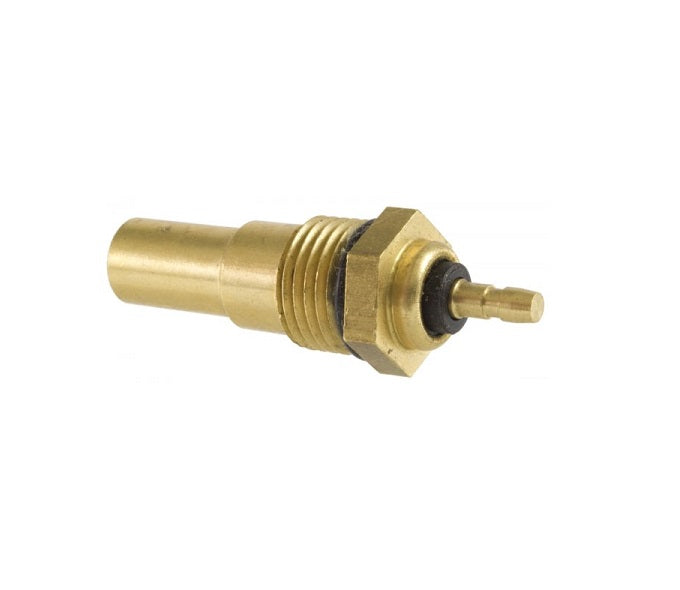

The lates have a plethora of sensors and switches for the t-stat housing and most parts stores don't clearly differentiate. That hole is for the COOLANT GAUGE SENSOR and needs the two-part "coolant sensor (also sometimes listed as a "switch" for some unknown reason) FOR GAUGE". I also see that many of those are sold as the sensor only - as you can use nut over and over - if you're careful. The nut never sees coolant if the sensor is sealed properly. If not (and/or over the years) the nut can be corrosion sealed to the sensor body making you think it's just one part. It's not. In the first picture, the original parts do look fused - but if you take some time you can free the "nut" from the sensor body and see the part you actually need to be buying:
ts-69_front.avif
This pic is from the O'Reilly First Call website and it's the sensor only - use your old nut... Of course it's not available, but the picture is nice.

No, it's not the wrong sensor... It's the aftermarket replacement that is (almost) "form, fit, and function" compatible with the original.
The aftermarket one piece design still seals on the same beveled edge and functions the same as the two-piece original. The O-ring on the new version is not intended as a liquid seal, and is actually not even necessary at all. I think they put it there as an attempt to keep junk out of the threads (from the outside getting in).
So, that said, what is it about the original two-piece design that is not replicated by the aftermarket one-piece? Answer is "the ability to clock the connector to a convenient position" before you tighten it down. With the original sensor, you could turn the body to whatever position you wanted before you did the final tightening of the flare nut. With the aftermarket design, when it gets tight, the connector position ends up where it ends up.
But other than that, they should both work just fine.
