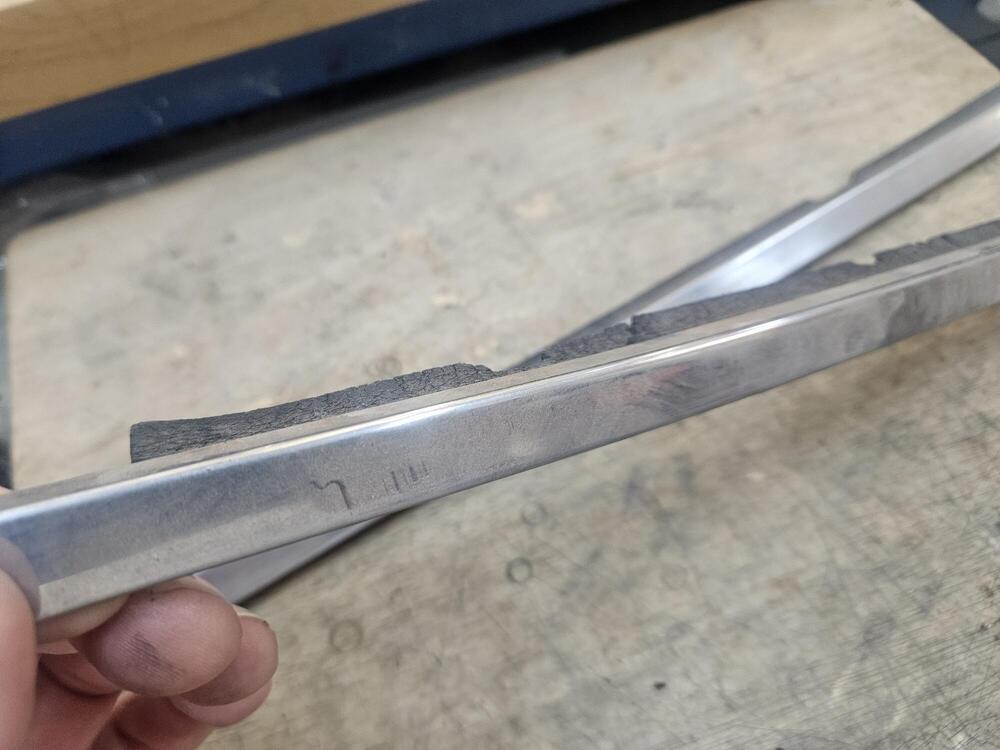

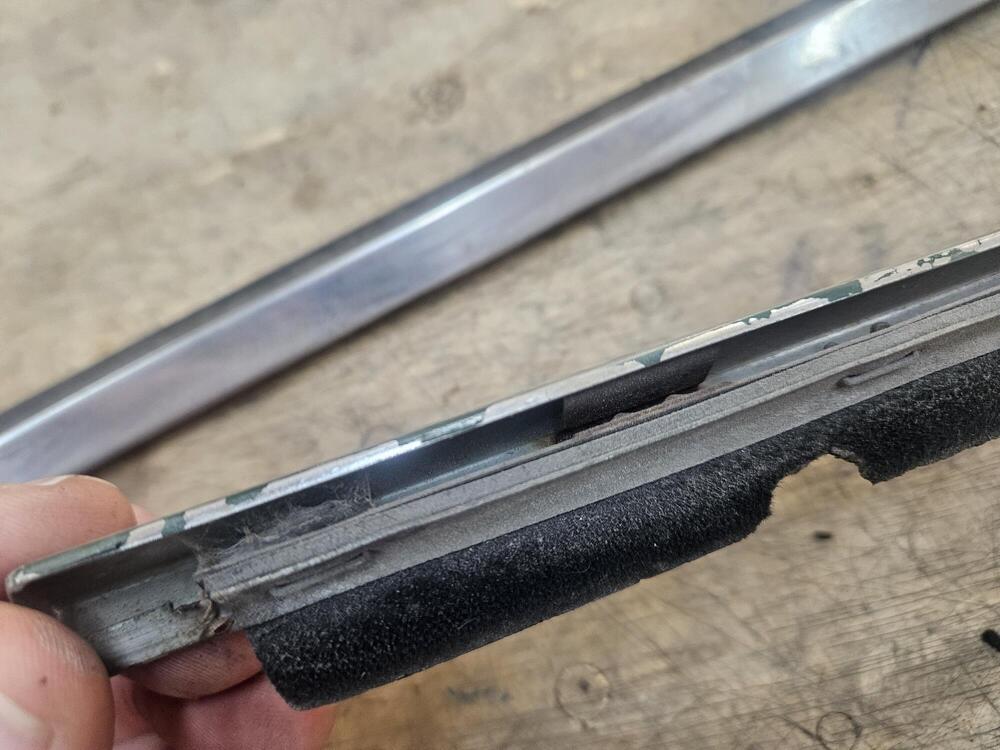

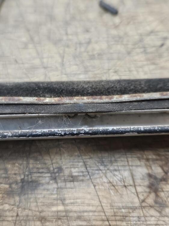

So I have been looking for a stapler to use on the window trim to attach the rubber squeegee to the trim.
It might be usable to attach the fuzzy strip to the top of the door card too.
I have dimensions of the trim to set parameters. An air plier stapler is probably similar to what they used originally.

Most of these types of staplers are designed to staple cardboard. The upgrade to thin stainless seems to be an issue. They can be expensive but if I could find a proper one it would make repairing these strips really easy and factory appropriate

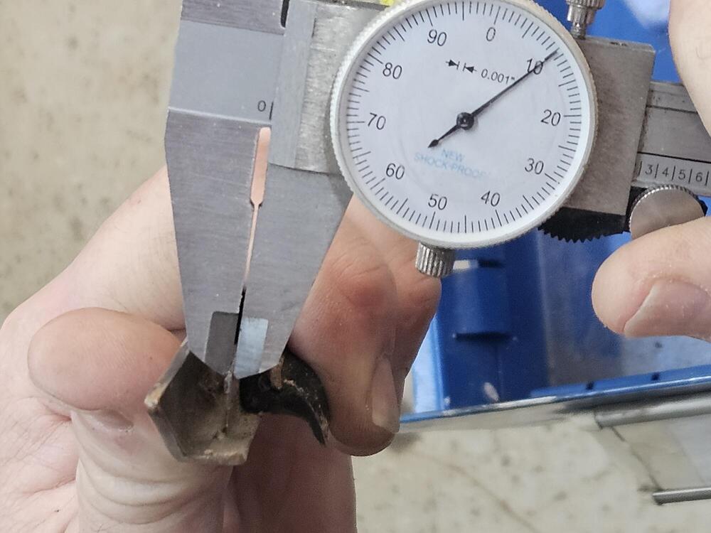

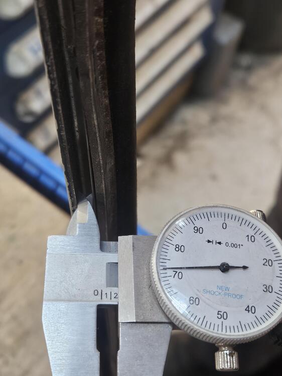

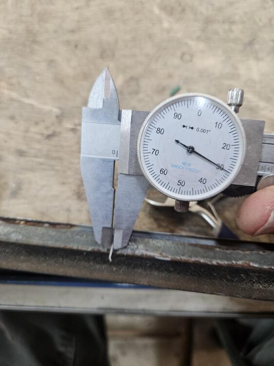

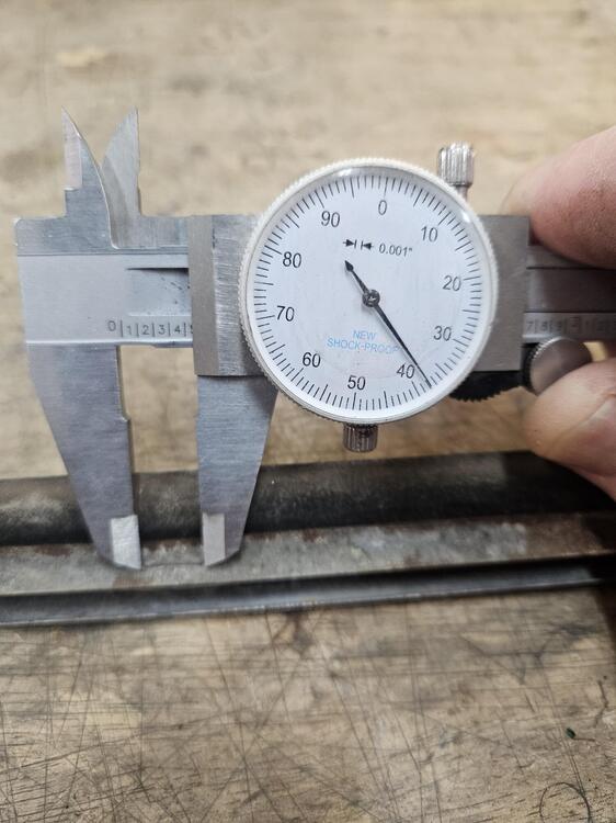

This throat dimension seems to be the biggest problem. One vendor I spoke to needed 7/8" for the stapler he would recommend. While I barely have 0.020"
I have done these by had using wire and folding them over but it's a slow process with mixed results. I have to do four of them for Cody's wagon

My approach is pretty much straightforward: I use 1/8" aluminum pop rivets instead of staples. The rivets are spread about 4 - 4 1/2" apart except at the front end. To avoid denting the belt molding when drilling the hole, insert a flat surface such as a putty knife to stop the drill bit. Installing the fuzzy strips on the top of the door card is similar, no need to use a flat surface. I did pick out all the fuzzy hairs from under the under the pop rivet head to ensure it was seated as deep as possible. Here's some pics of the belt molding. I did this about 12 years ago, purchased complete repro belt molding assemblies from Black Dragon but did not like the metal molding so I removed the squeegee strips and installed them on my own moldings. That's why you see staples securing the metal reinforcing strip to the rubber sqeegee in these pics. These staples do not go thru to the molding. Sometimes the bottom of the pop rivet has to be slightly trimmed to get clearance to fit the molding on the door. If so, a Dremel with a cutoff wheel is a good approach. Hope this helps you with your project.

The staples that Nissan's supplier used are STOUT. Must have taken a hell of a staple gun. They're like spring steel. Anyway, I knew I'd never find a staple, and I was afraid to use pop rivets, SO... I used paper clips.
No, not like that. I cut them with a wire cutter and bent them into a "U" that matched the holes made by the original staples, pushed them through the holes in the stainless steel strip, then pushed them through the rubber squeegee and folded them over like a staple. Took a bit to get the "arm" length right so they didn't overlap. I did it 7 or 8 years ago and haven't had any issues - and when/if they wear out, it's just a paper clip.
