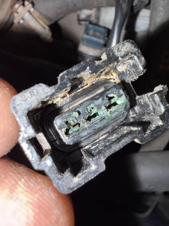

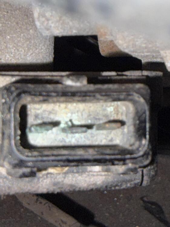

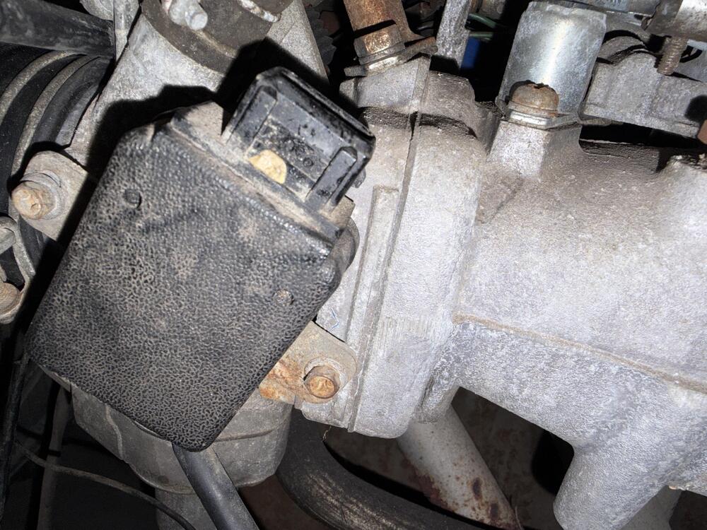

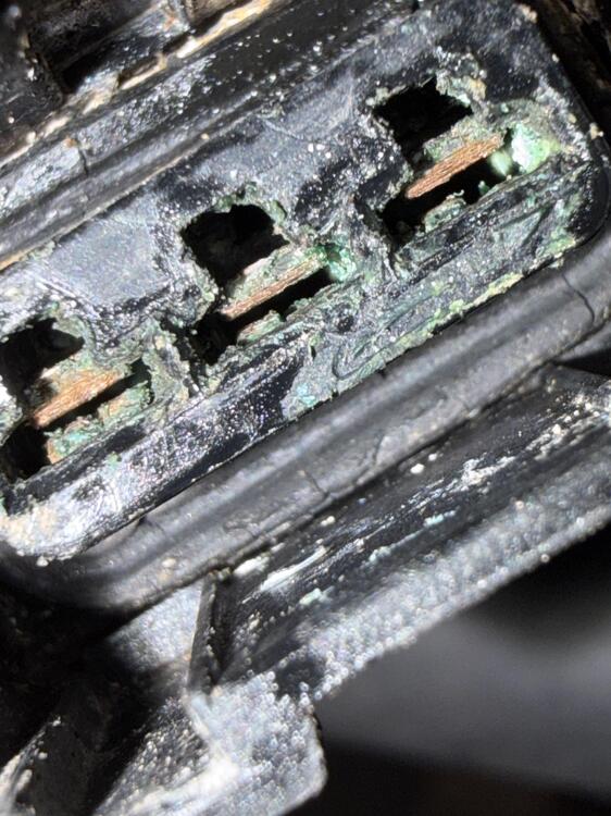

SOLVED:
After chasing a no-start, I narrowed it down to no injector pulse. Decided to stay focused on the EFI harness instead of jumping around.
Went through and unplugged/inspected all EFI connectors and started cleaning them. One connector stood out—pretty corroded. Hit it with a pick and CRC electrical cleaner, plugged it back in, and the car fired right up.
Before this, I had already replaced the AFM boot, coil, plugs, wires, cap, and rotor thinking it was ignition related.
Question is—was that the TPS connector and could that alone really cause a full no-start/no injector pulse?
Edited by dtejada
Edit
My only response is I went through the same situation. I replaced every connection on the RFI system due to corrosion. Fix one another pops up. Including the AFM connection. It’s not fun, Takes time but worth it.
Was the same with my ’77 280z. A good start is to clean all the electrical connectors in the engine bay with contact spray and a brass brush. The brass brush is firm enough to clean the connectors and really get in to them but not damage the plastics.
These EFI systems are a bit weir sometimes. Mine ran really rich on idle no matter what I did but I started her yesterday for the first time in a couple of months and the AFR was right on the mark for both idle and power. Maybe she just didn’t like the cold?
