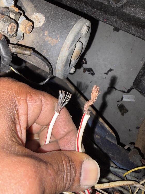

Two white/red wires that came from the fusible link box towards the front of the car. Which one looks bad and or burned? The thick white/red wires feeds multiple circuits from my research. One of these is why I have starting problems, again.
I see some corrosion, but for a car that's about 50 years old, that's not unusual.

Are you sure? Do you have a cranking problem, or a fueling problem, or a sparking problem?
I think I see the evidence of a wire nut on the thick one. Regardless, if it's not connected it's a problem.

Not so sure. Originally the fusible links had been bypassed with wire nuts. I removed those and installed a Stinger maxi-fuse box and cut the wires back to clean copper before reconnecting everything. After that repair the car started and ran and the interior fuse box now has full power on all fuses.
