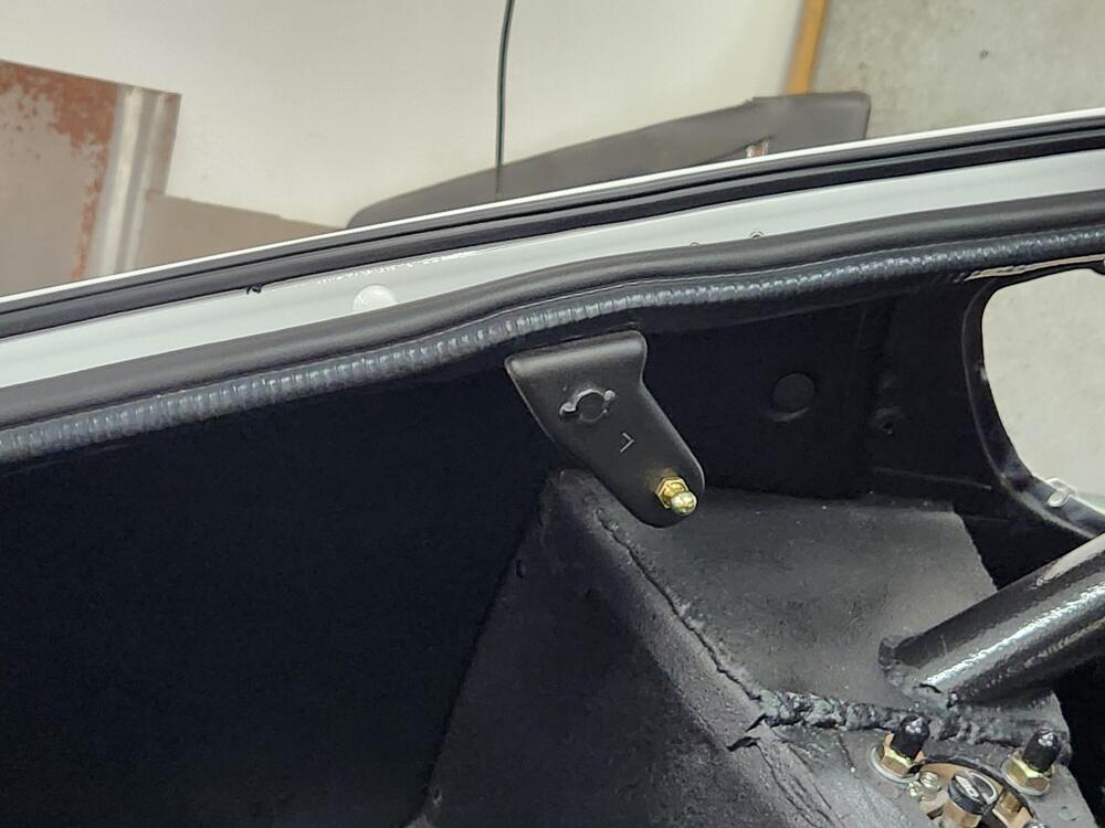

I am running into a slight problem with my Kia weatherstripping in the hatch.  The spot where the weatherstripping runs over the hatch lift mounts is too tight and forces the weatherstrip to sit higher in that area.  This is making my hatch not close correctly.
I could either:
1) grind down the removable part of the mount.  This might not even totally fix the problem as the non removable part may also be interfering
2) cut away the lower portion of the weatherstrip.  This should alleviate the fitment issue but that small (~2") length would not be attached to the body.
Has anyone else had this issue?
