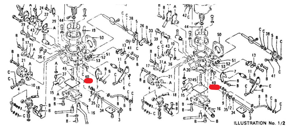

May 9, 20241 yr comment_665243 https://www.carpartsmanual.com/datsun/Z-1969-1978/engine-240z-260z/carburetor-240z-(l24)/from-jul-72#1 It’s part #40, good luck finding it….. Link to comment https://www.classiczcars.com/forums/topic/68963-su-flat-top-bowl-drain-screw/#findComment-665243 Share on other sites More sharing options...

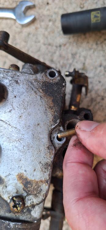

May 9, 20241 yr Author comment_665244 Better yet I want to take these flat top carbs off either to clean or to replace with round top. How in the world do you unbolt these bolts from the manifold the top ones are very easy. A couple of the bottom ones are easy but there are some bottom ones that are unreachable absolutely impossible to get here is there’s something I’m missing here. How do you get those bottom bolts undone on the bottom of these flat top carburetters can anyone tell me who has done this or knows how to do this? Link to comment https://www.classiczcars.com/forums/topic/68963-su-flat-top-bowl-drain-screw/#findComment-665244 Share on other sites More sharing options...

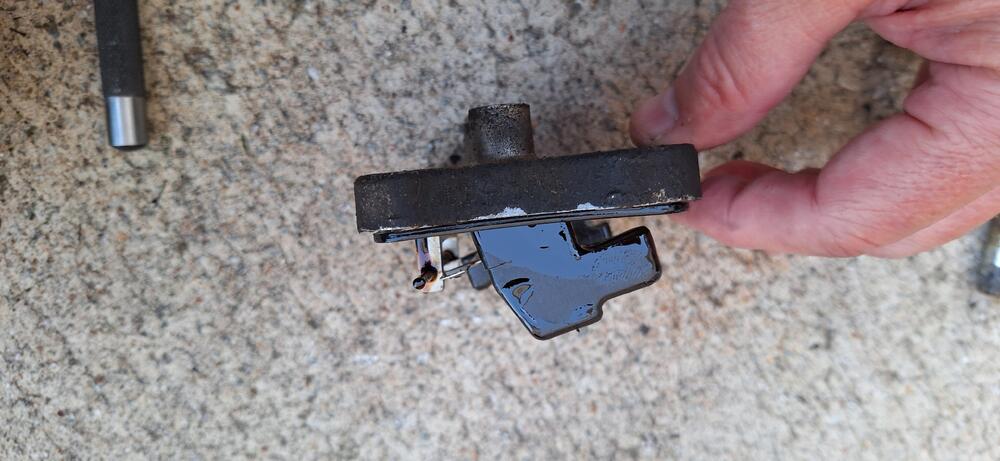

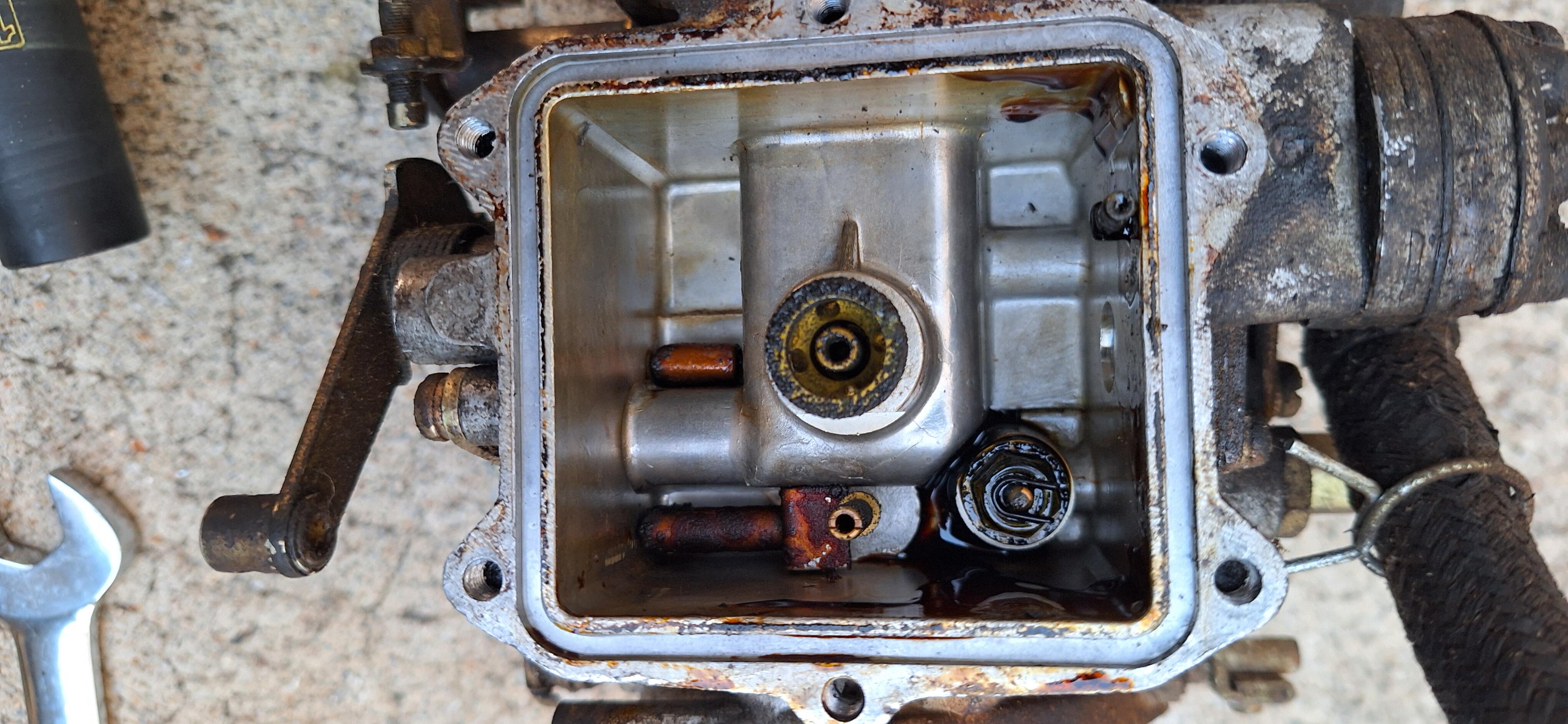

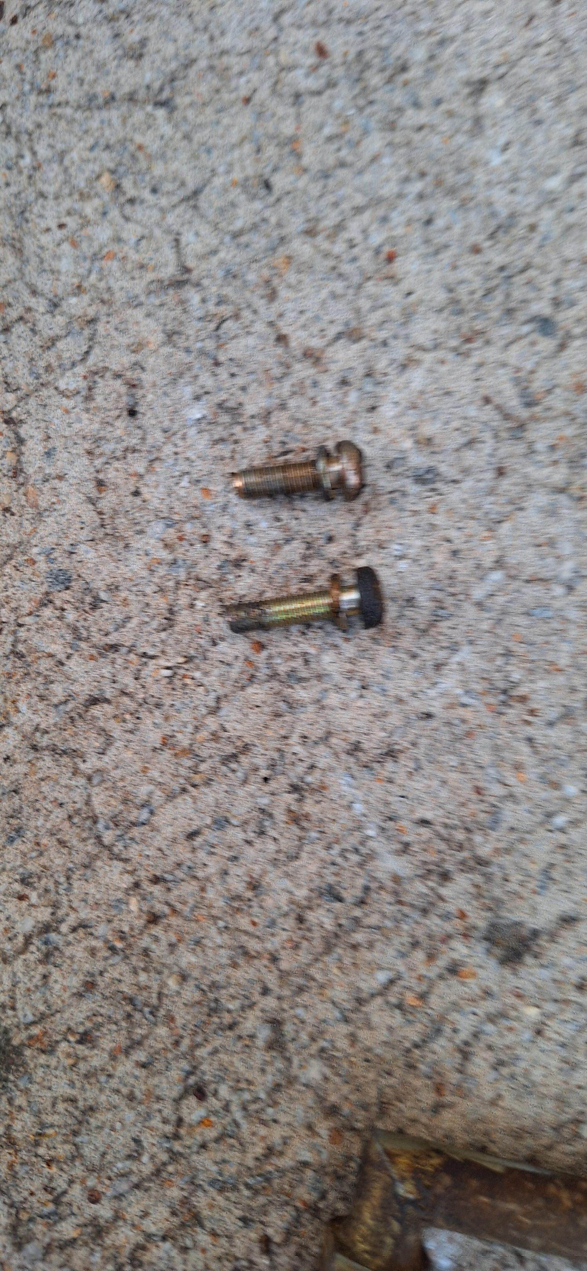

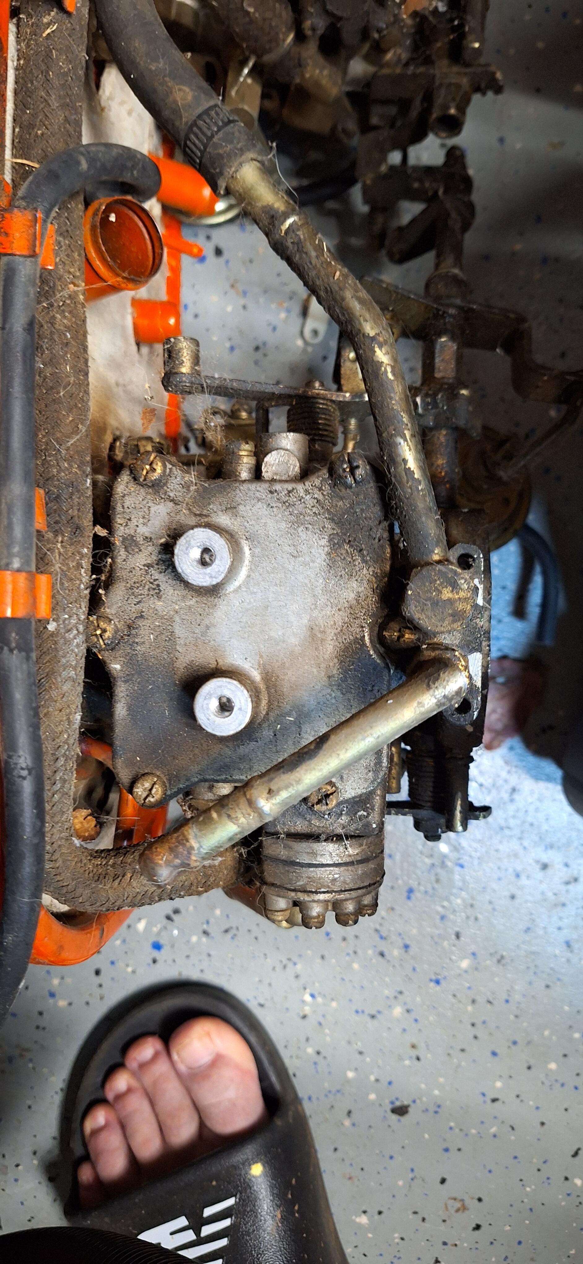

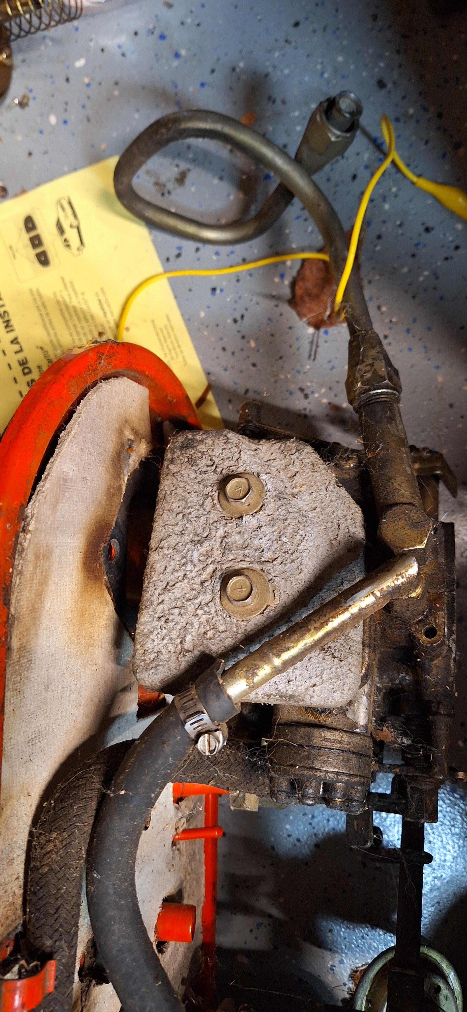

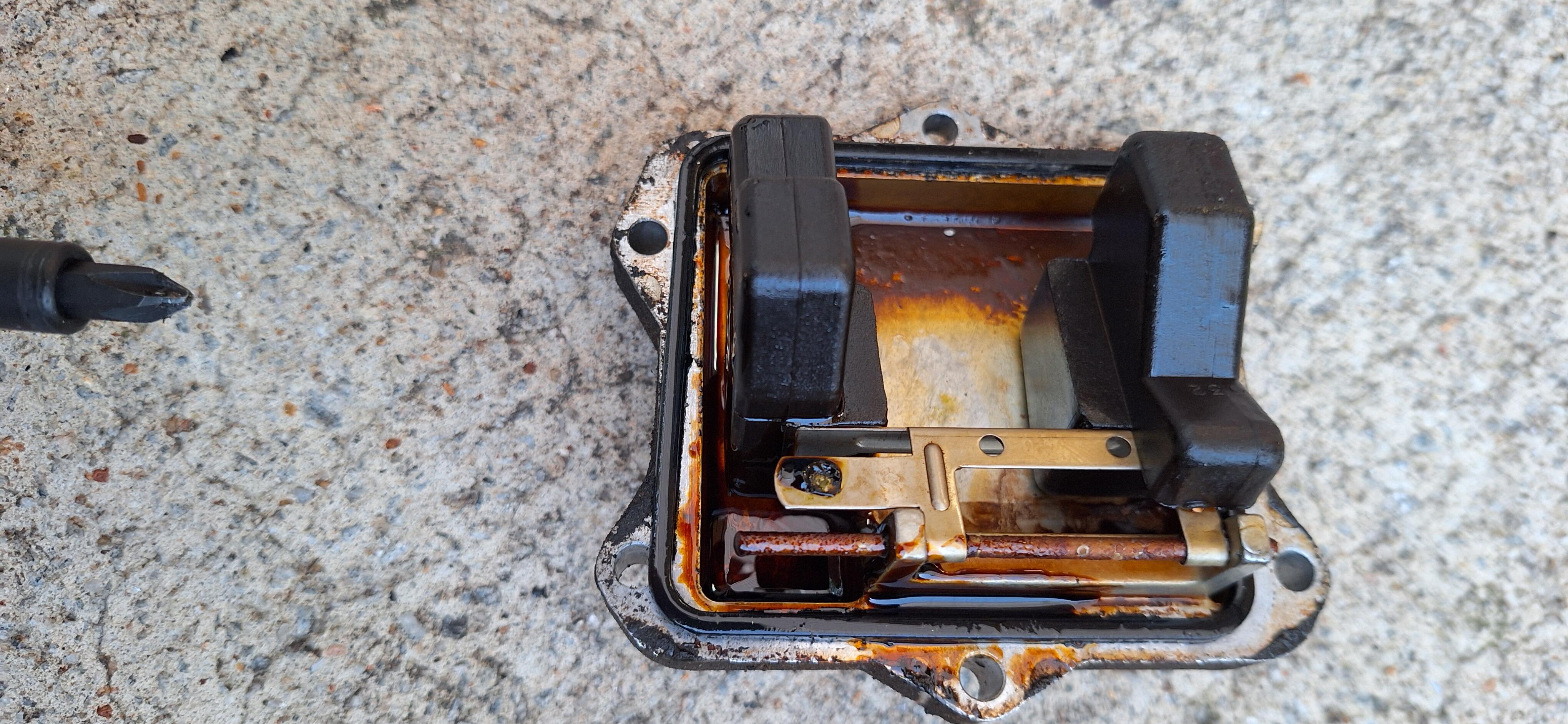

May 10, 20241 yr comment_665248 Nope. No drain screw, at least not on the set I had handy. There was a heat shield on the bottom. The shield covered this: Still no signs of a drain screw, so I took off the bottom of the float bowl. Nice and gunky! Here's a side view of the floats. And the float bowl chamber. No penetrations on the sides that I could see. I'm thinking that valve is TOAST. Anyway, when putting it back together, note that 1 screw is shorter than the rest. The short screw goes where there is an indentation on the bottom cover. Don't dismantle unless you have a new float bowl gasket on hand. And don't buy the cheapest kit since that kit does not have as many gaskets. (2 needed) https://www.rockauto.com/en/catalog/nissan,1973,240z,2.4l+l6,1209170,fuel+&+air,carburetor+repair+kit,5964 Link to comment https://www.classiczcars.com/forums/topic/68963-su-flat-top-bowl-drain-screw/#findComment-665248 Share on other sites More sharing options...
