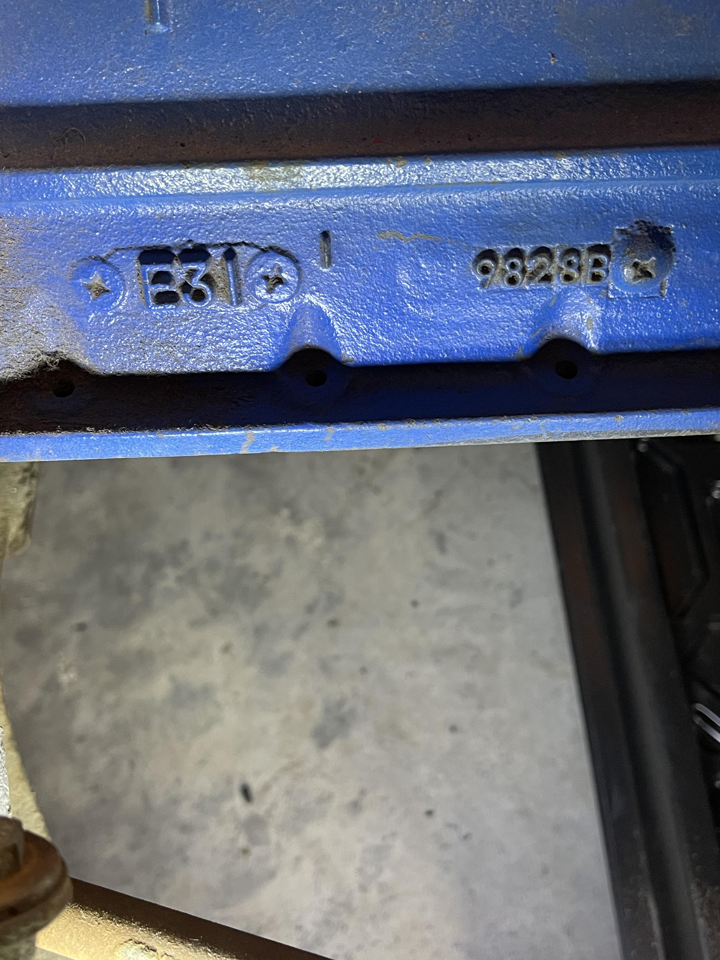

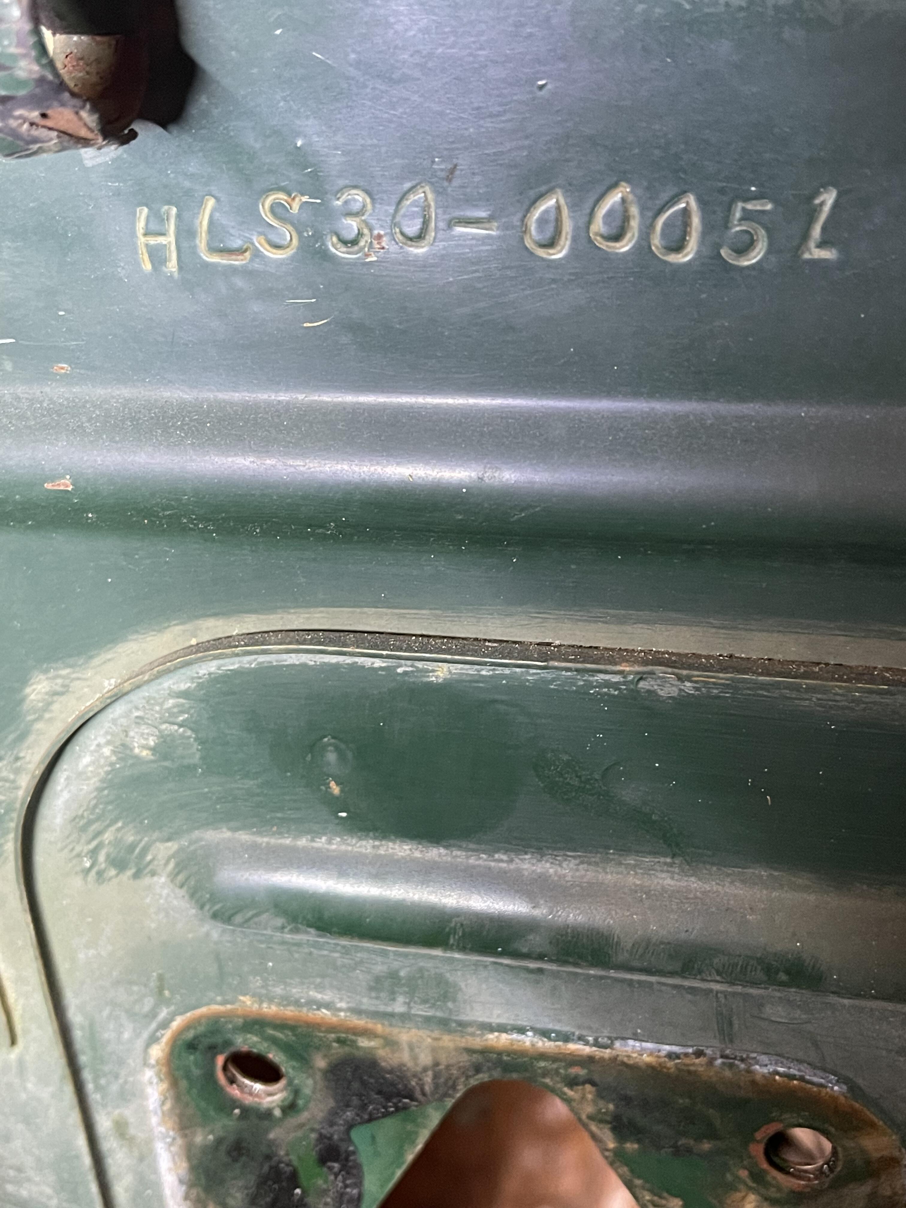

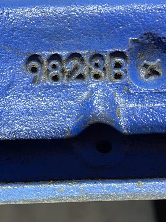

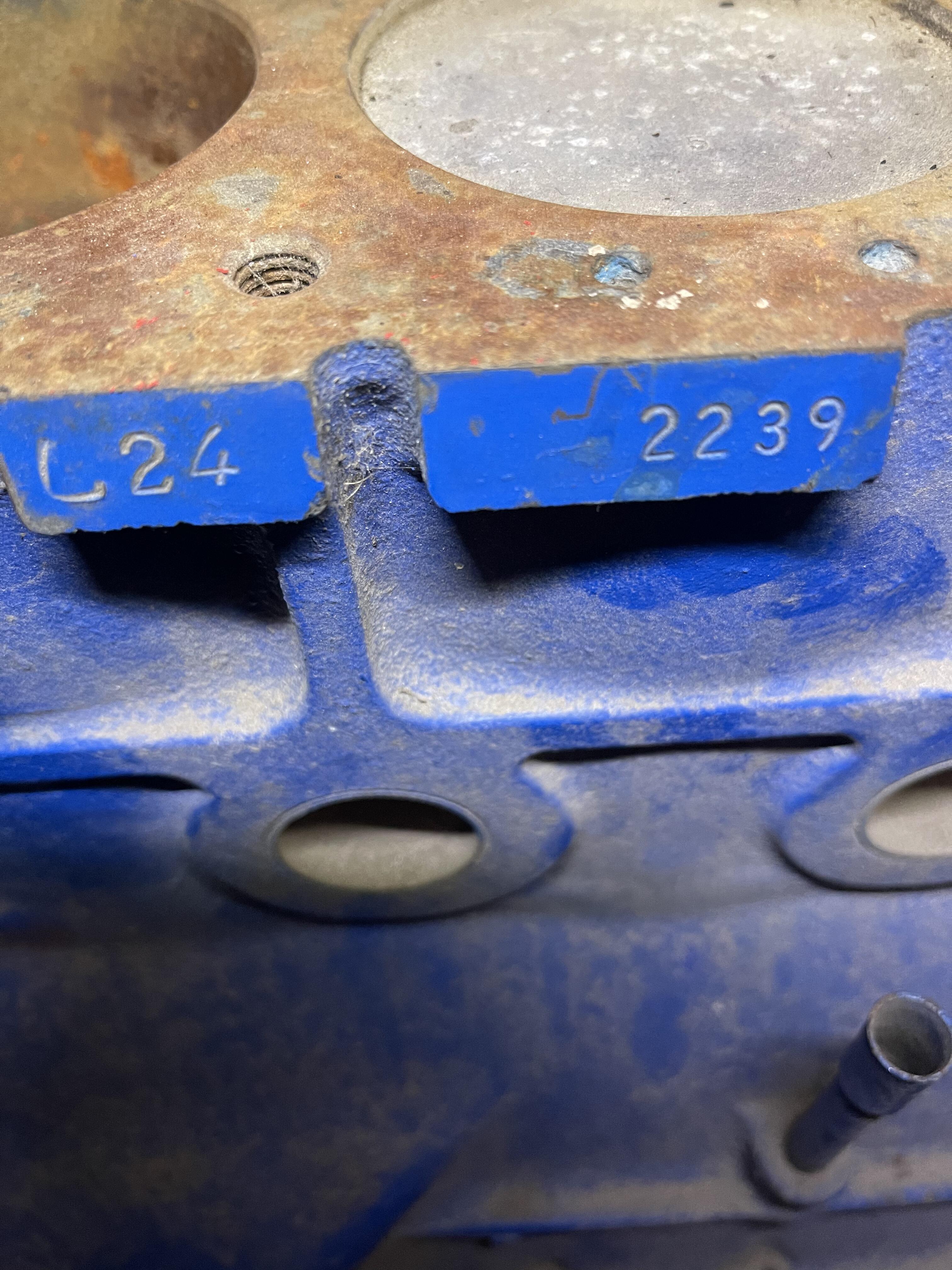

Quick Sunday post to hopefully legitimize and  state with pictures of “matching numbers” or as I would say “all original 240z”……
Vin..00051   October 69 car
  Block L-24  2239
  Engine casting # 9828B
Deciphered  as block born on date of August 28th 1969. Which is in line with what to be expected.
    I mention this because of some discussion over the years, on BAT, and on this site about this car being a legit matching numbers car.   I can understand the concern and the reasons for the discussion.   Posting this combination of pictures to hopefully dispel any conflicting thoughts…zz
      I do welcome any thoughts about this car in anyway shape or form.07144664-A752-411D-A022-87311A3A33BC.jpeg69FDFC6E-75CB-429F-9287-96946F1452D7.jpegDEA72473-042D-41FD-A527-CBEFA94EC23E.jpeg74509C9E-98FD-4BC7-AC05-CC7BE9318F7B.jpeg

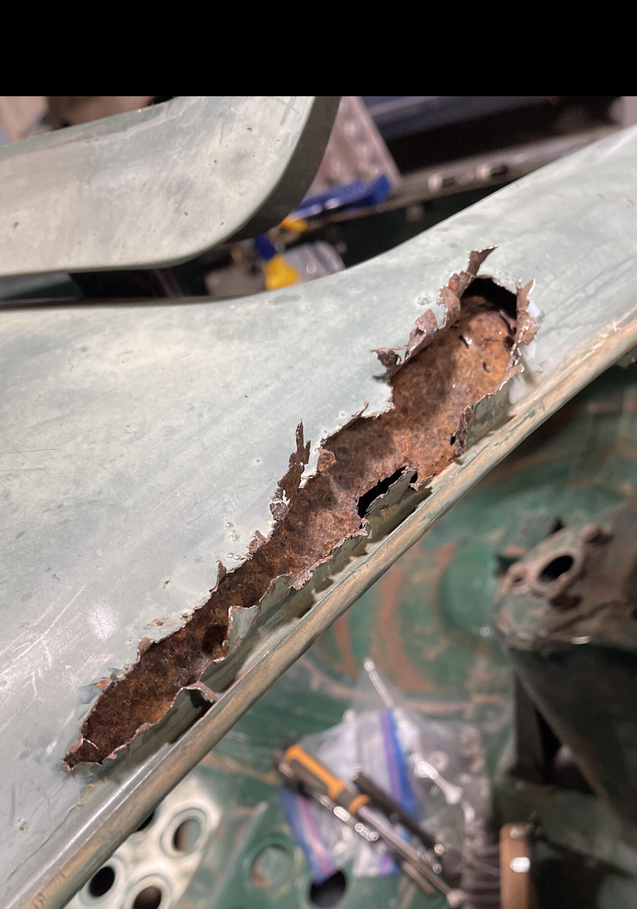

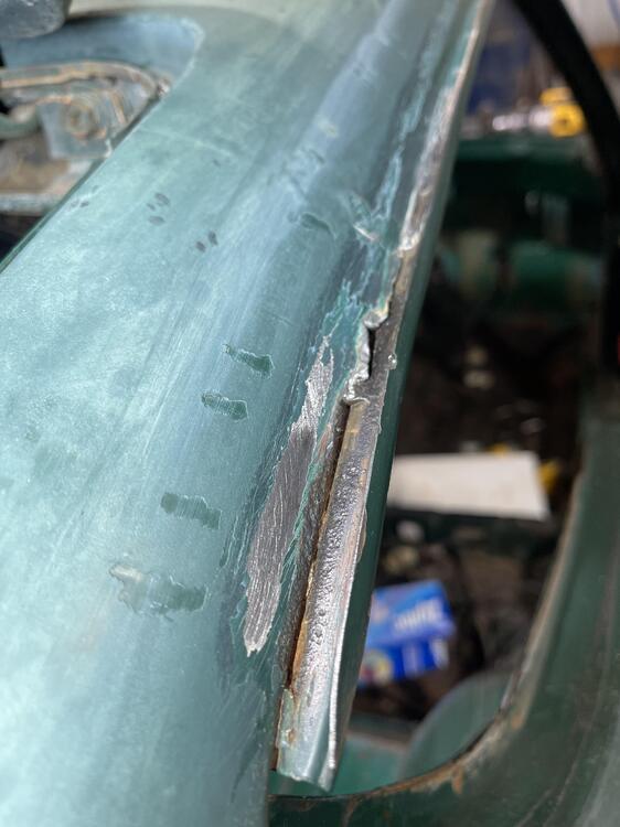

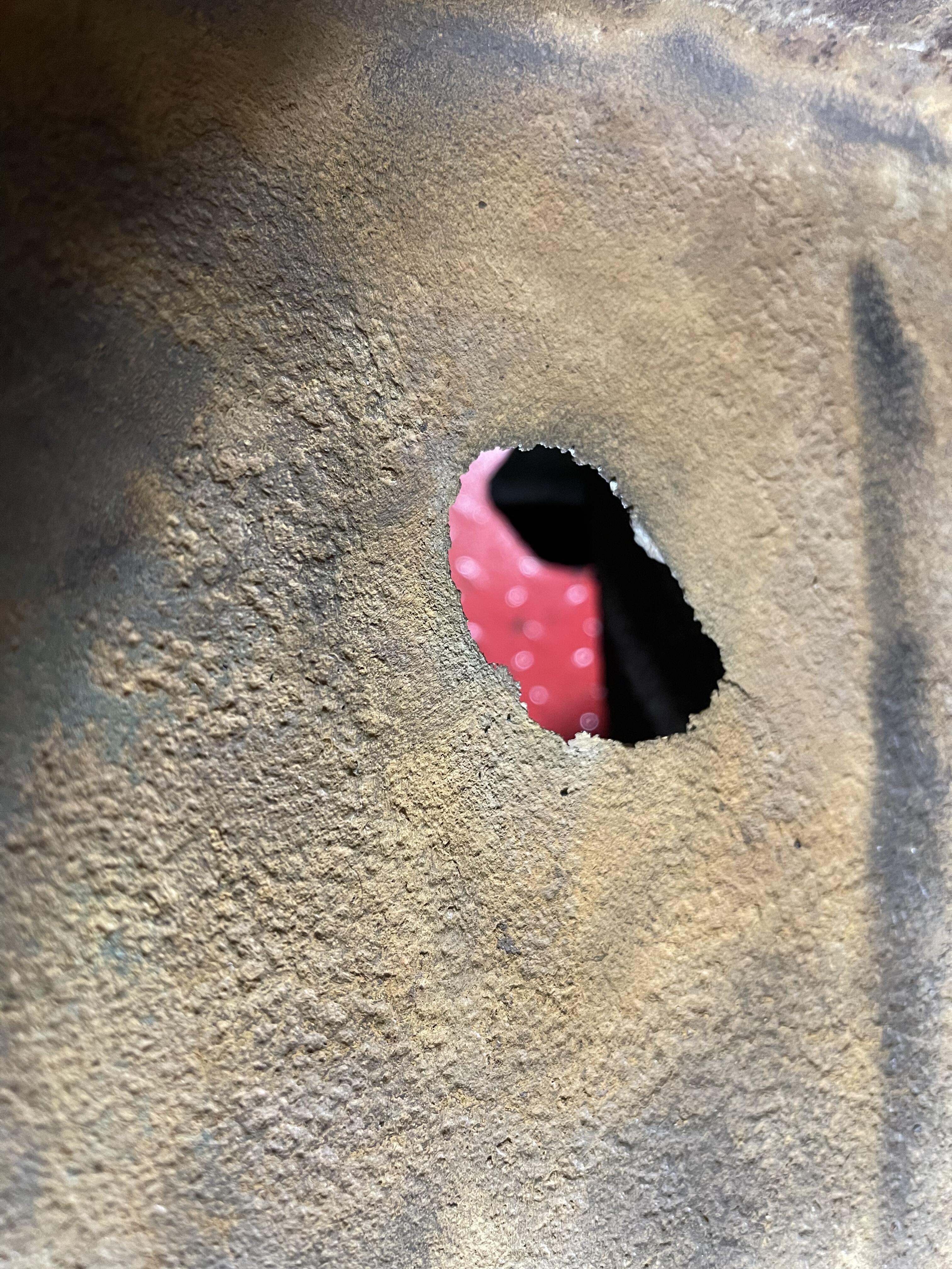

Hoping the body panels would surprise me with no “hard” body work… not to be.
    Driver side over quarter window where roof joint is cut out and repair will be needed. Good news is no evidence of previous repairs here…. At least no filler is present.
     Passenger side shows better…. But with a couple of bubbles , we all know better.
 My early disassembly had me leaning towards not blasting, or dipping, but now this difficult to repair are I think requires to dig a couple layers deeper to expose….stuff.  Layers of untreated , un painted metal from the factory can only result in rust
That rust hole in your pic of the D/S roof is just above where the roof panel and the C pillar were joined, it was soldered together with lead. Some have said over the years that it was done that way to allow some flex in that join, others have said that it was just the technology of the day, they both sound plausible to me.
It is a complicated joint and difficult to open up to remove the rust.  I had one of my Z's dipped because of the same kind of rust and all the leaded joints came back empty. The place I used baked the car in and oven at 600-800F to burn off all the coatings before it went into the acid tank.  I'm still looking for the photos of that car when it came back, I'll keep hunting for them.
Dipping has some definite advantages but the place I used didn't neutralize the metal very well and I was fighting flash rusting for weeks before I could get get primer on it.
 At the Atlanta Z-CON, Charles and I talked with Matsuo-San when that question came up. As I recall he said that joint was intended to flex. The consequence of a stiff C-pillar was the A-pillar flexing instead with the possibility of a windshield popping out. @Patcon What do you remember of this conversation?
And yet...  Hard for me to believe that a broad-surface soldered joint like this one would offer structural flexibility sufficient to absorb the amount of distortion that would cause the windshield to pop out of its frame (which, we should remember, is lined with a compliant rubber seal).  Not disputing Mr. Matsuo's claim, but I wonder whether the flexibility that he spoke of had more to do with positioning flexibility (compared to spot welding) for the two parts during and just after the joining process*, rather than after the car hit the road.
Put another way, just how much would that joint need to 'give' in order to prevent the amount of windshield frame distortion needed to make the windshield pop out: 1/16"?  Is that soldered joint really capable of absorbing 1/16" of relative shear without breaking?
Agreed. I wasn't there when they designed it, but I don't see that soldered joint as "flexible".
I'm thinking they needed to join two major assemblies in an area that is extremely visible. An area where spot welds would have been unsightly. Maybe they thought the solder joint would not only be strong enough, but it would be much easier to hide? Maybe they just couldn't come up with a way to do a spot weld there because of access?
But who am I to say? I wasn't even there.  LOL
The lead-loading is cosmetic. It covers what would otherwise be unsightly joints and is intended to be (slightly) resistant to flexing, but it is not the fixing method of the panels.
