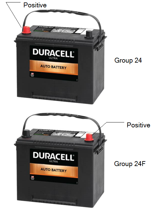

Where is the positive terminal on the old battery?
I prefer to get one that has the positive terminal away from the fender.
Interstate MT24 has the positive terminal under the inspection flap.  Having it the other way around makes sense, but my wires wont reach.
Group 24 batteries are standard. That puts the positive terminal under the inspection door where it belongs. Amongst other reasons, I think the most important reason for keeping it this way is that you should pull the negative terminal off the battery any time you are trying to disconnect the battery for replacement, removal, or servicing the electrical system. I won't put a Group 24F battery in my Z cars, especially after I had a mishap from not securing the battery properly.
I also suggest getting a battery with a flat top if possible. I'm pretty sure that the stock battery bracket would work better. I will probably test my theory in the next month or so. Batteries Plus carries this Group 24 battery. It's more than the Walmart batteries, but I found the Walmart batteries to be hit or miss when I use my battery testers. One holds up fine after 2.5 years, and the other registers replace now, though it still has enough power to turn the starter and fire the car.
So go for a group 24 instead of 24f?  I didn't know there was a difference, I'll grab one, thanks.
The Walmart Group 24F I purchased in 2011 held up for 10 years! But... that was then and this is now, no telling who is making them at this time. Watch the warranty period on your candidates, I think the Duracell is only 24 months.
