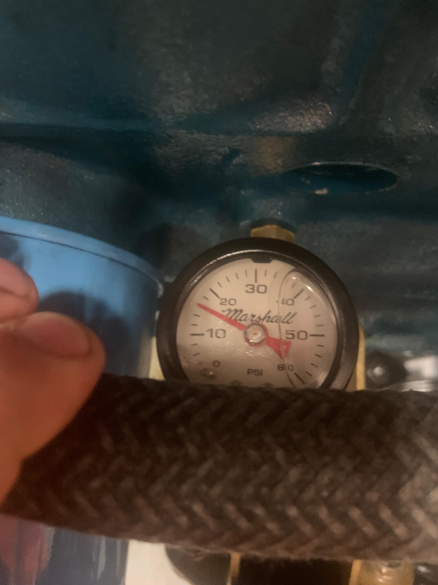

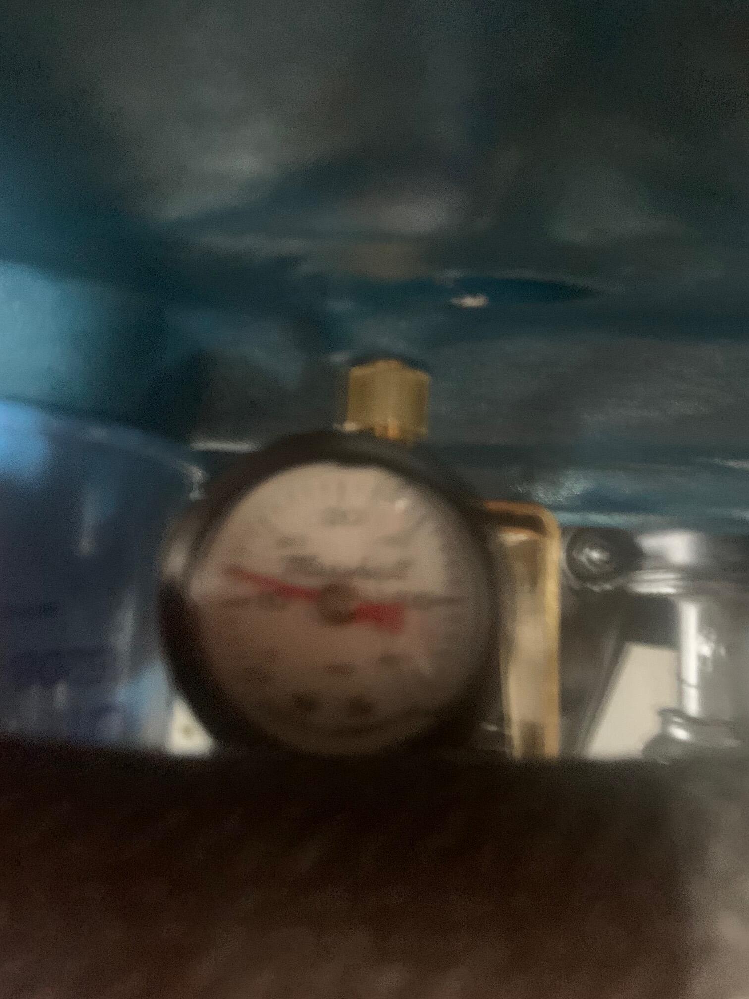

here is an update. I got in the oil pressure gauge Steve recommended. i put it on and you can see results. The clear image is at idle, 16psi. When revved up psi goes down (blurry) to about 13 psi.

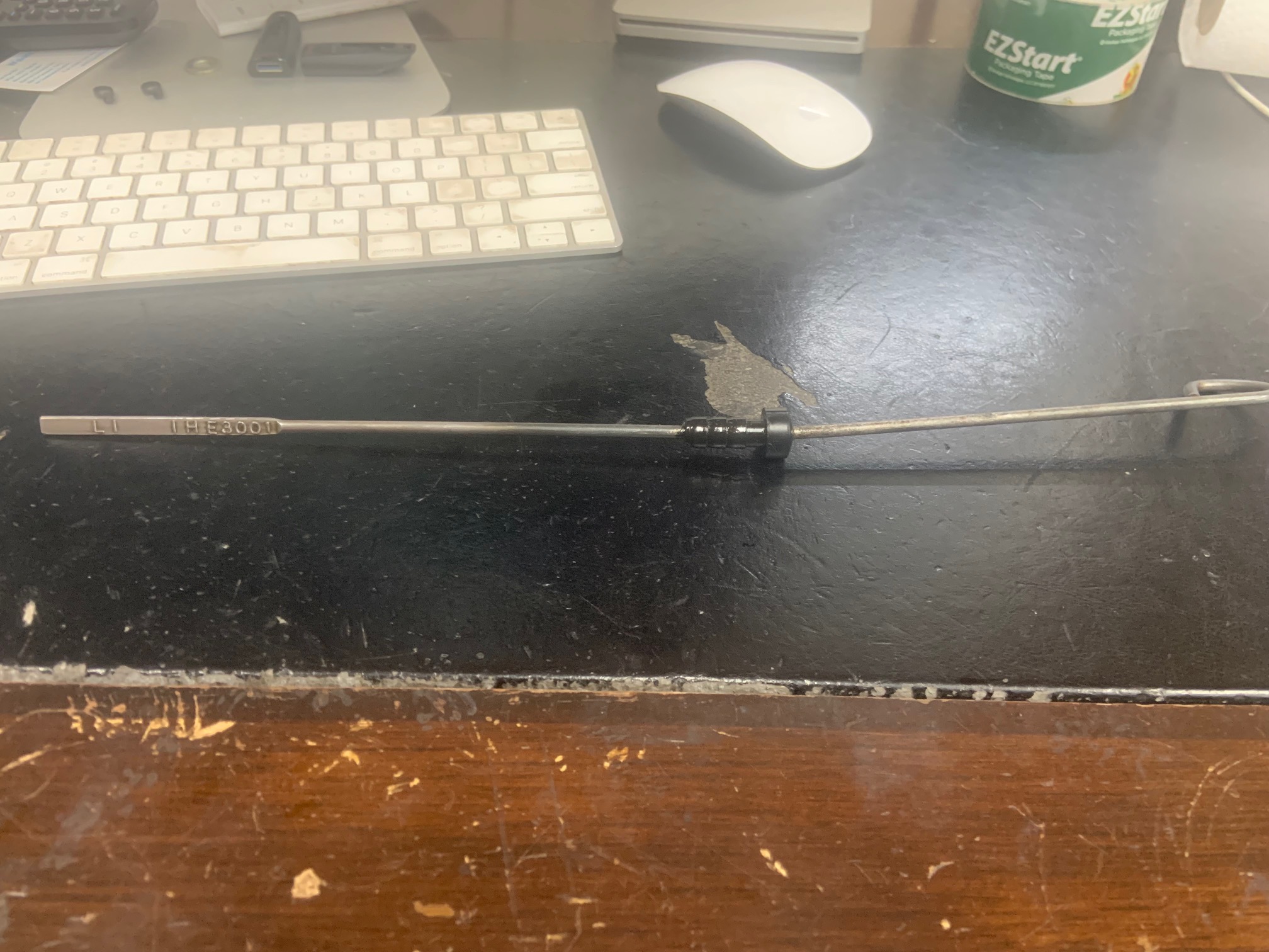

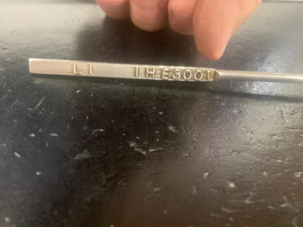

Lot of comments recently to go through but for now here is the dipstick that came with car. Also where finger is is where oil shows. Anyway to know if this is proper dipstick?

5. The correct amount of oil in the crankcase, and the correct dipstick.

(as for the question of the correct dipstick, have you replaced it with the one that was with the engine originally?)

The oil stick that came with the car when i got it is the same one i am using now. I did a google search and looked at the ones selling on ZCD. It appears mine is the same or similar to those. So to me it seems proper one.

Might help to have an illustration of the oil path to ponder.  Pressure is caused by resistance to flow.  Flow starts at the oil pump.  You said that you installed a new oil pump, but who knows about its quality.  The oil pump has a relief valve that could reduce pressure.  The oil filter area has a relief valve but flow will still be resisted by the main bearings and the restrictor at the supply to the head.  So that bypass doesn't really matter.  Hard to know how much oil could pass through that restrictor to the spray bar.  I think that I saw it in one of your pictures.
And, apparently, some engines have another supply passage to the head at the front.  It's not shown in the illustration but I have a vague memory of reading about it.
A thought that just occured - the fact that pressure reduces at higher RPM might be caused by cavitation.  Which could be caused by a restriction in the supply to the pump.  So, it kind of circles back around to the pickup tube.  Maybe you got a gasket on backward or something.  The pump just moves volume.  Pressure is caused by restriction.
