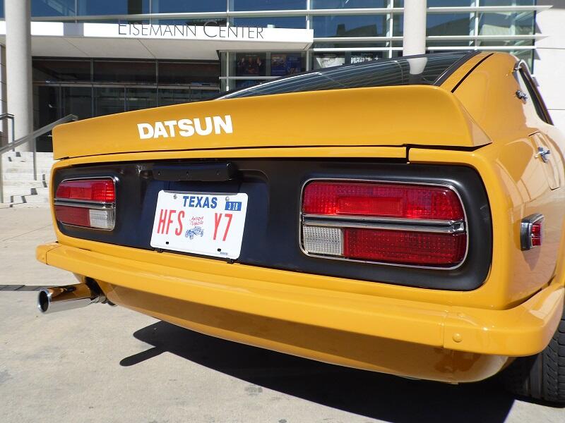

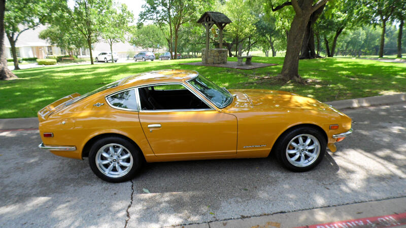

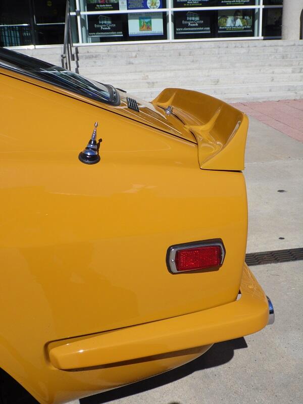

Like @Jarvo2 I also have the 1970 edition of the BRE rear spoiler with the 6-bolt mounting sysstem. It and the 1st generation BRE Spook were already installed by the dealer when I first laid eyes on the car on the showroom floor. The Spook is visible in my signature pic. The original Spook is probably more of an air dam, generating less downforce than the later design. I suspect the air dam you already have will work very well in combination with the rear spoiler. By the way, when reinstalling the spoiler when I restored the car, I added a tiny O-ring as an insulator on each bolt between the spoiler and the hatch surface. That seemed to make the install a bit more firm. The last two pics are older before I switched out to shiny bumpers.
