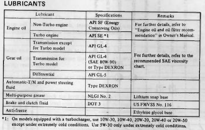

17 hours ago, Mark Maras said:
Dexron ATF or SAE 80W-90 in a manual gearbox?
The name DEXRON does not mean it's automaticaly ATF were they talk about i think?  I sure never heard of putting atf in a manual gearbox!
I always use 80w90 oil.
It's right there in the graphic that I pasted from the 1983 FSM.  I doubt that they were recommending gear oil in their automatic transmissions.
Look at the graphic.  "Type DEXRON" is mentioned twice.
