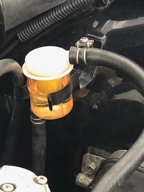

Carbs balanced. But take a look at this...does it look like my fuel level is low in my filter while at idle? Sucks all the way down to the bottom of the paper filter when rpms are increased.

It's time to test the mechanical pump for pressure (psi) and volume (gpm). The symptoms have the feel of a dying mechanical fuel pump. I remember a similar problem with my 71 back in the day.
That's what mine looked like too. Turned out the floats were keeping the fuel level low and starving the carbs. It was very clear once I drove up a steep mountain. The front carb went dry and I was running on the back 3 cylinders. LOL

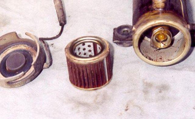

I am pretty positive that the 1973 had a TSB that included installing an electric fuel pump in the rear.
If yours has that mod then that is where the blockage is, if it is fuel issue.
You may need to pull the filter from the pump and replace. Very common on those.
