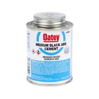

@siteunseen had success with one of the ABS pipe adhesives I think.  He repaired his console, which is the same material.  Maybe get a discount from the seller and try to fix it, if you can't get a refund.

I shipped one of those once. I felt compelled to attach it (tape, screws, packing material support etc) to a thin sheet of plywood to ensure it arrived in one piece. Anything less and you are about guaranteed to have a “problem”. The repo pieces are nice and thick. ABS cement and fibreglass matt will work wonders. Then fill the crack(s), re-texture, SEM black, repeat until happy. Or get a new one.

If you are just going to repair I think the method above would work, Glass in some thin wood strips on the back side, and the SEM spray and texture would cover up the crack seam. Always a bummer to get something damaged in shipping or worse yet have it lost in the mail.
