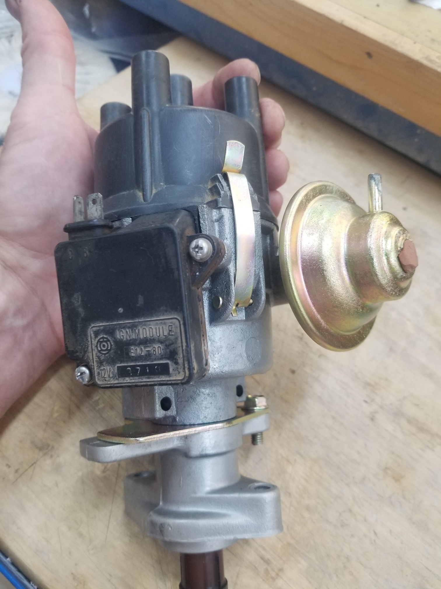

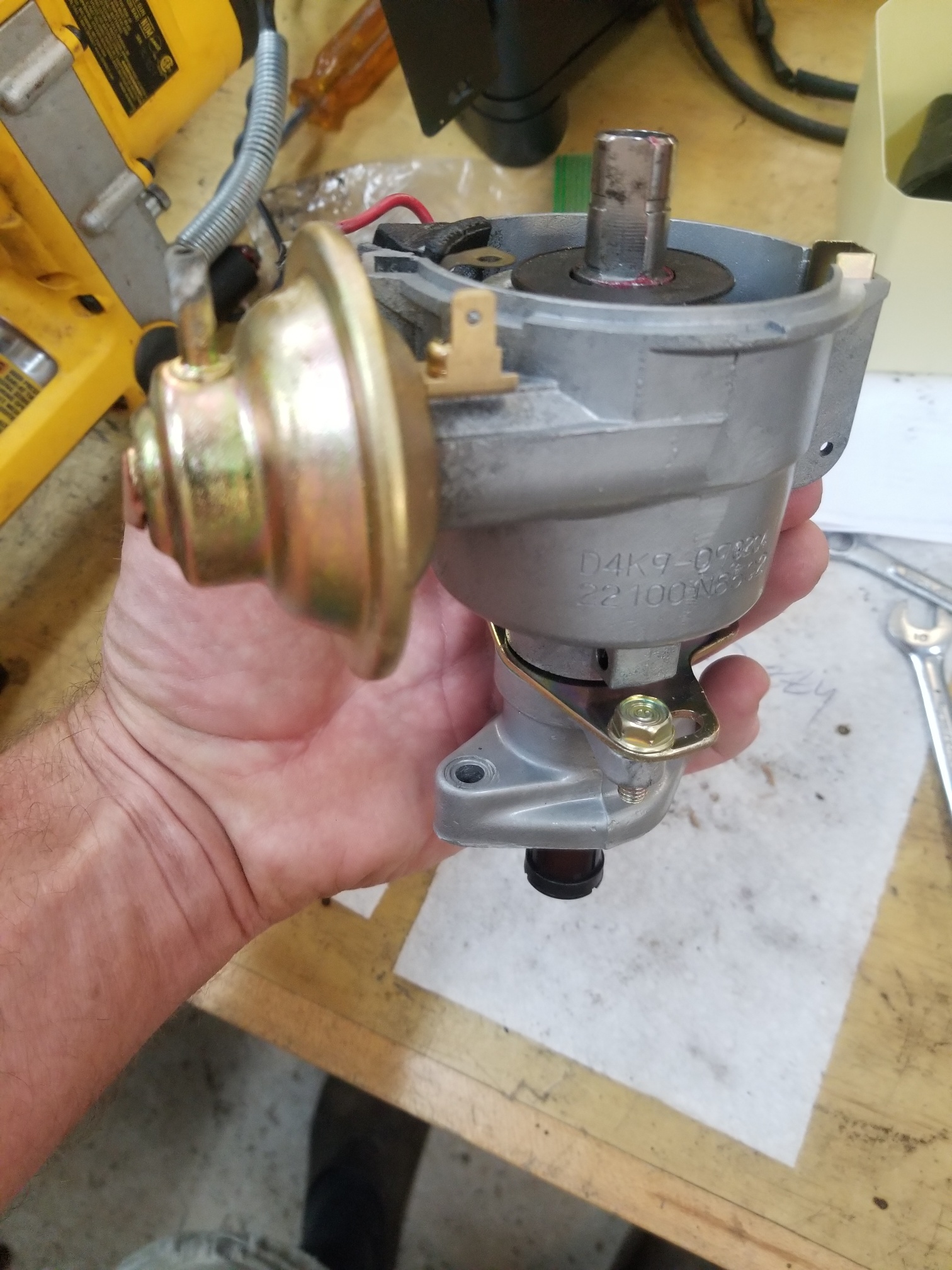

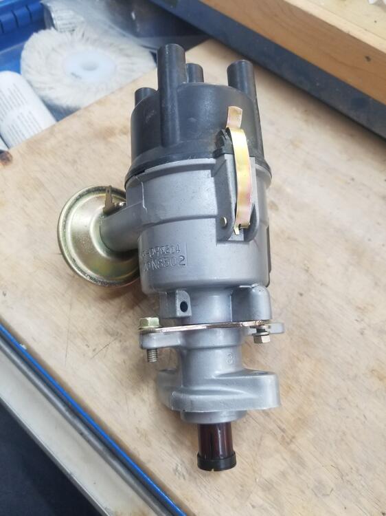

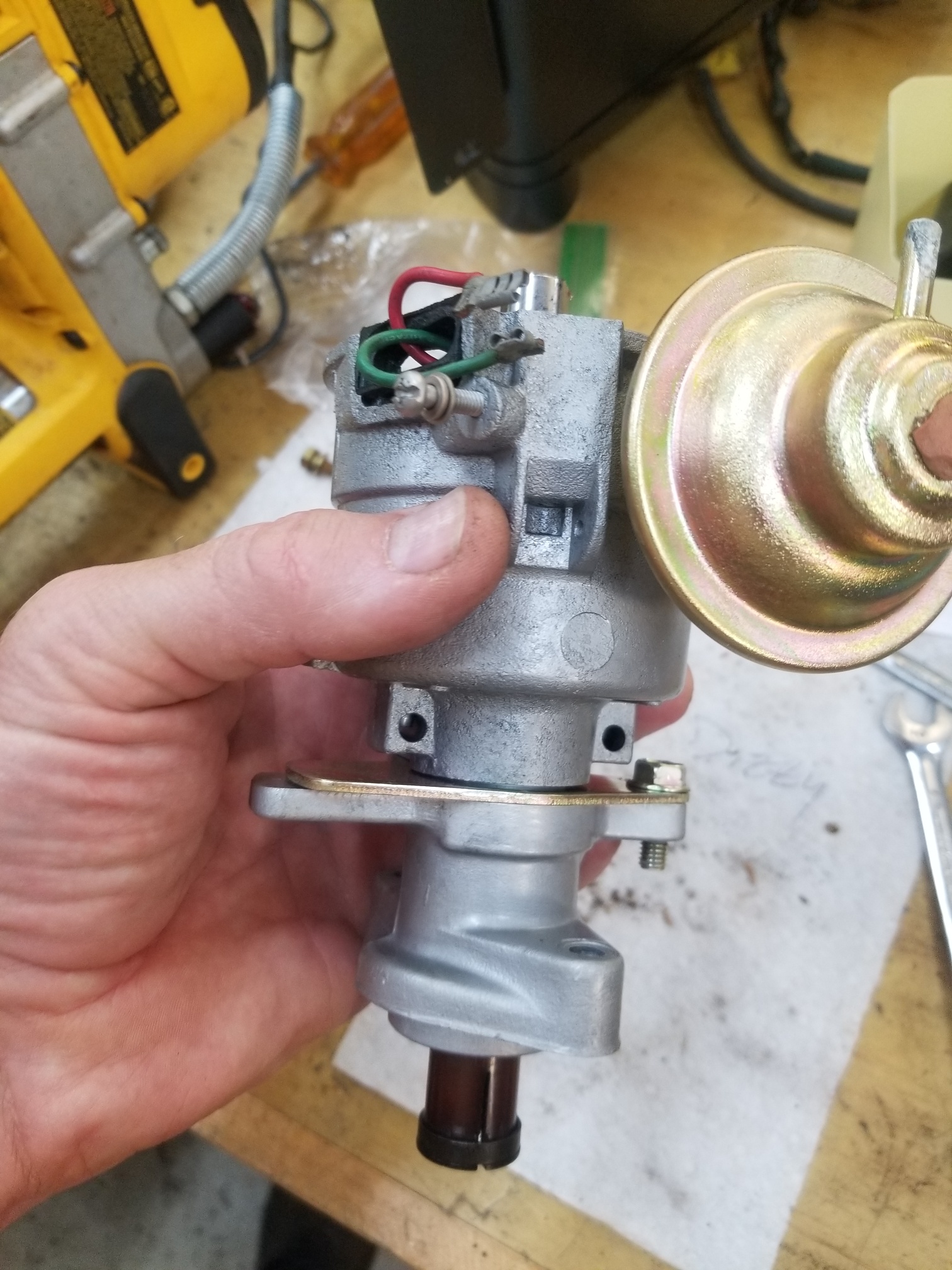

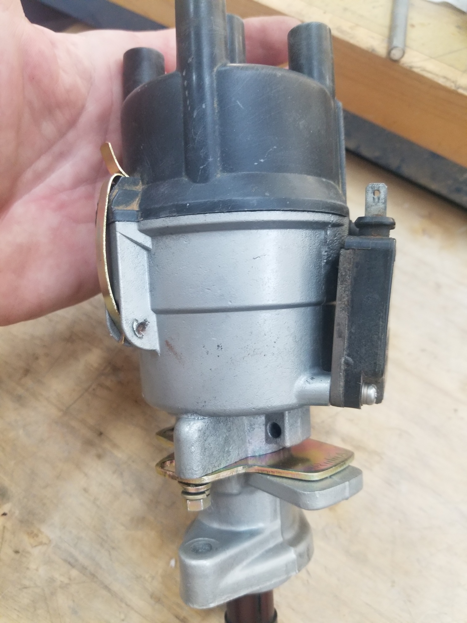

July 24, 20232 yr Author comment_655357 I finally finished the distributor. The cap clips were tough to get plated properly. I did them 3 times. They will have to do... On another note, is there a source for the plug and boot for the module? The one I have is pretty ratty Link to comment https://www.classiczcars.com/forums/topic/64870-l20b-codys-goon/?&page=6#findComment-655357 Share on other sites More sharing options...
July 24, 20232 yr comment_655364 1 hour ago, Patcon said: The cap clips were tough to get plated properly. I did them 3 times. They will have to do... I had a bunch of parts plated professionally a while ago and noticed that the hardened ones came back very different than the non-hardened parts. And not in a good way. I'm guessing it comes down to the amount of carbon in the base steel. Seems the extra carbon makes them harder to plate? Those distributor spring clips would certainly be a higher carbon content than the typical hardware used on the Z. Link to comment https://www.classiczcars.com/forums/topic/64870-l20b-codys-goon/?&page=6#findComment-655364 Share on other sites More sharing options...
July 24, 20232 yr Author comment_655370 You might be right. I have found some bolts like the crank pulley bolt can be hard to plate too. My biggest concern when plating the cap clips were concerns about embrittlement. They also don't like to plate evenly because of their shapes Link to comment https://www.classiczcars.com/forums/topic/64870-l20b-codys-goon/?&page=6#findComment-655370 Share on other sites More sharing options...
