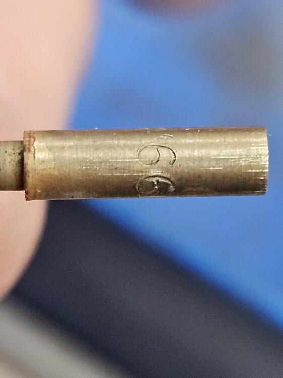

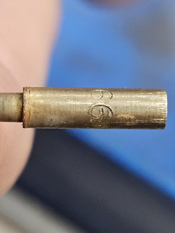

OK, so 0.090 nozzles. Do you know what needles are in there (and what needles are supposed to be in there)?
And even if they are appropriate needles and nozzles, it could still be a problem there. They might have worn from rubbing due to incorrect alignment. Or corrosion over the years eating away at the brass. Those kinds of issues would be most pronounced at idle since the gaps are (supposed to be) so small.
Well I have no idea if the M66 is the correct needle for your application, but I did a few minutes of web searching and came up with a couple hits:
https://ratsun.net/topic/57757-needle-modification-for-l20b-sus/
http://www.team.net/html/datsun-roadsters/2000-07/msg00225.html
https://ratsun.net/topic/52225-hitachi-side-draft-su-needles/
There was some mention that the M66 run rich at idle, but then go lean at higher throttle positions. So yours sound like they are following that pattern... At least the idle part.

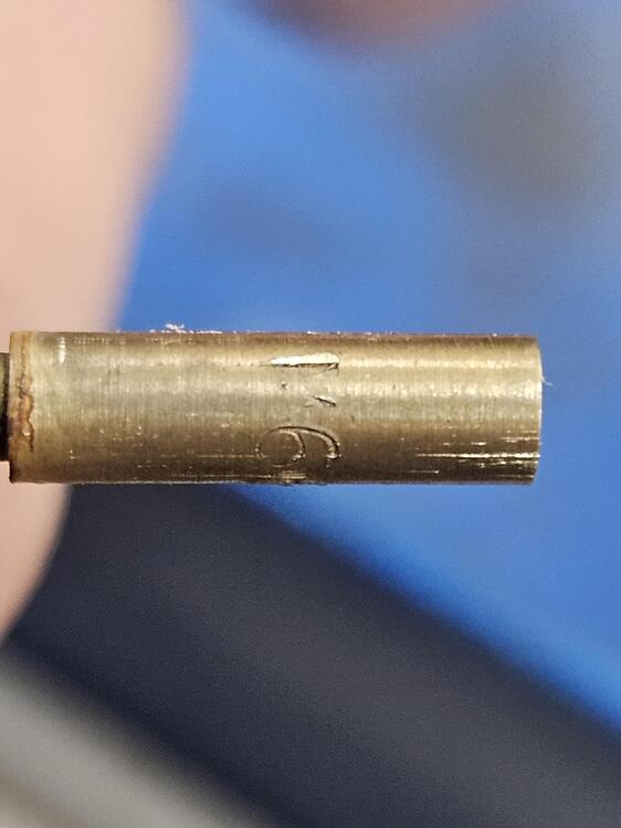

So we replaced the needles and nozzles. That helped some, we can get it to idle around 11.2:1 on the AFR

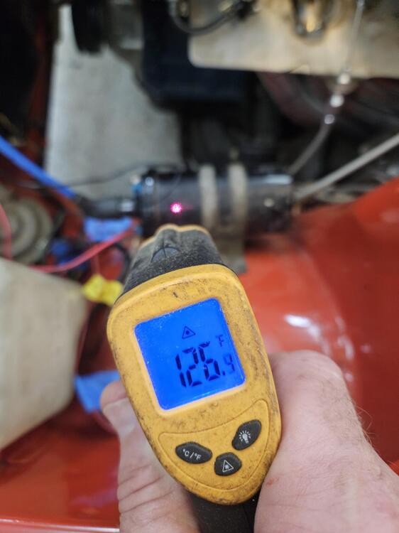

Also, are coils supposed to get this hot? This is after about 30 minutes consisting of three testing runs
Any thoughts on coil temp?

I don't think the coil is too hot. They have to be able to withstand all of the rapid flux changes involved with generating a spark. That's a lot of energy flowing through it.
