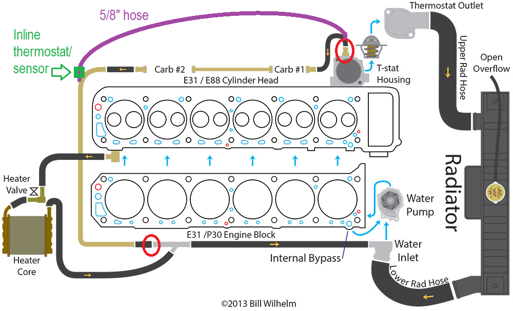

But, my flat tops had some other stuff I'm trying to remove if not needed.  See this pic from that thread, with my mark-ups added in PURPLE and GREEN to show flat top elements I'd like to remove.
The green sensor is in the 2nd pic here:
QUESTION: Can I just get rid of this 5/8" hose and sensor altogether for round tops? That would only leave the coolant flowing through the intake manifold on that side of the engine compartment.

In the other thread, I was specifically asking about that sensor/valve and its removal.  But, the more I look at it, and see diagrams people have posted here of the round top coolant flow diagram, it seems the 5/8" hose is not necessary either. I was not sure if it was there to carry a higher volume of hot water around to the heater coil for climate control.

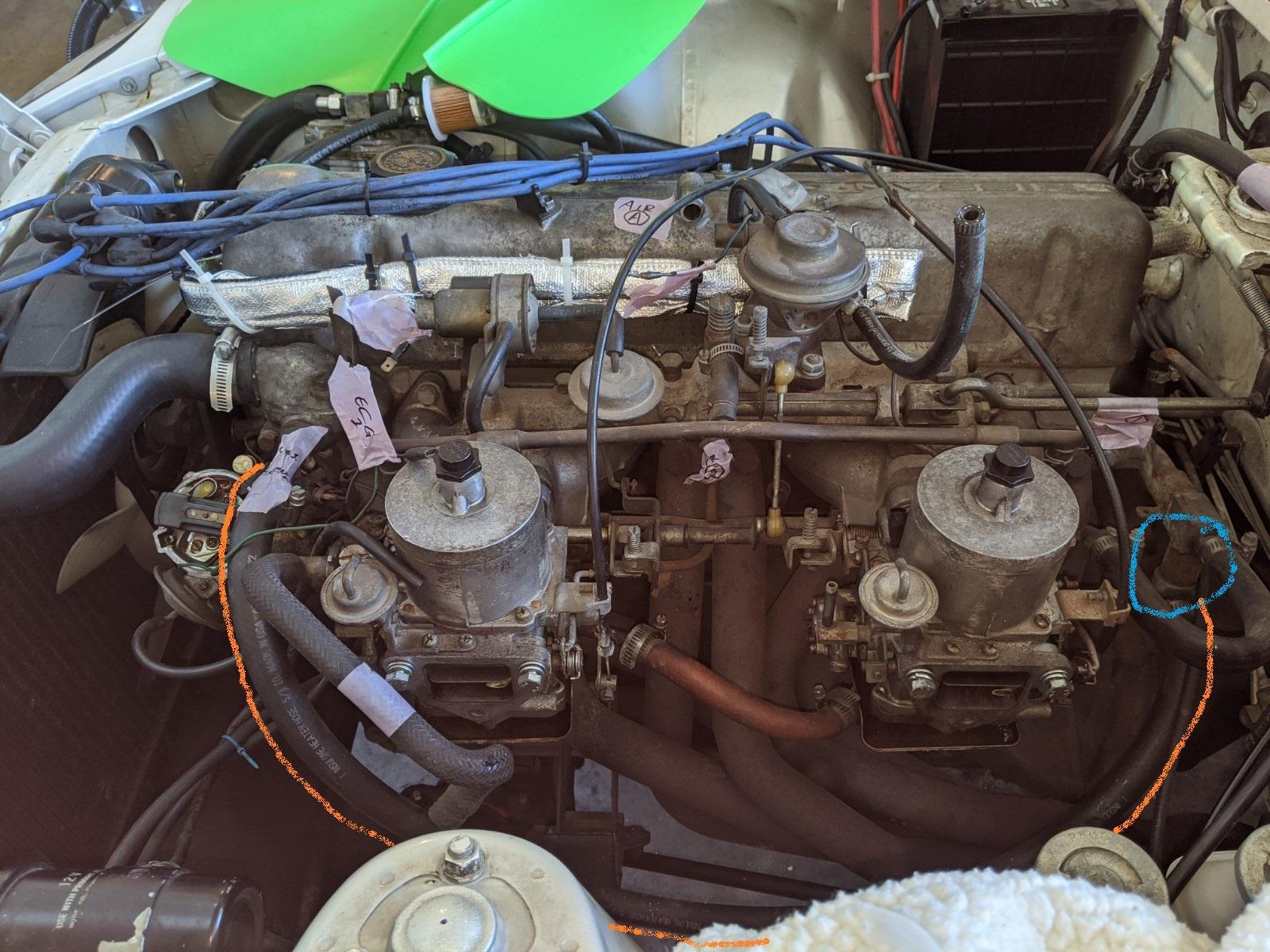

Well, it's all apart now, but I went and found an old picture.  The orange line traces the 5/8" hose.  The light blue circle is where the thermostat/sensor/pressure/valve/backflow preventor/whatever is.  I am calling it a sensor because someone said it may be that. I don't know what exactly it's purpose is. It's all new to me.

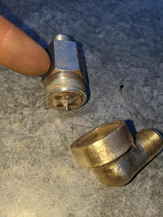

As for making a 2nd thread, sorry about that. My other thread is about the carb conversion, and this was specifically about this large hose that seems to complete the circle (in duplicate to the coolant intakes going through manifold) on that side of the engine bay. btw, that 5/8" hose was actually blocked because the brass elbow (can't see it well in the picture, but it's just below the blue circle) was completely clogged.

According to your diagram it's even worse than the typical heater core bypass.  What your diagram shows is taking hot coolant straight out of the thermostat, after it's traveled through the head collecting heat, just before it enters the radiator and running it back to the water pump with all of its heat.  Might be that somebody just connected a bunch of loose hoses together so they wouldn't flop around in the back of the truck.  Or maybe the engine is from the north and it's the equivalent of cardboard on the radiator.

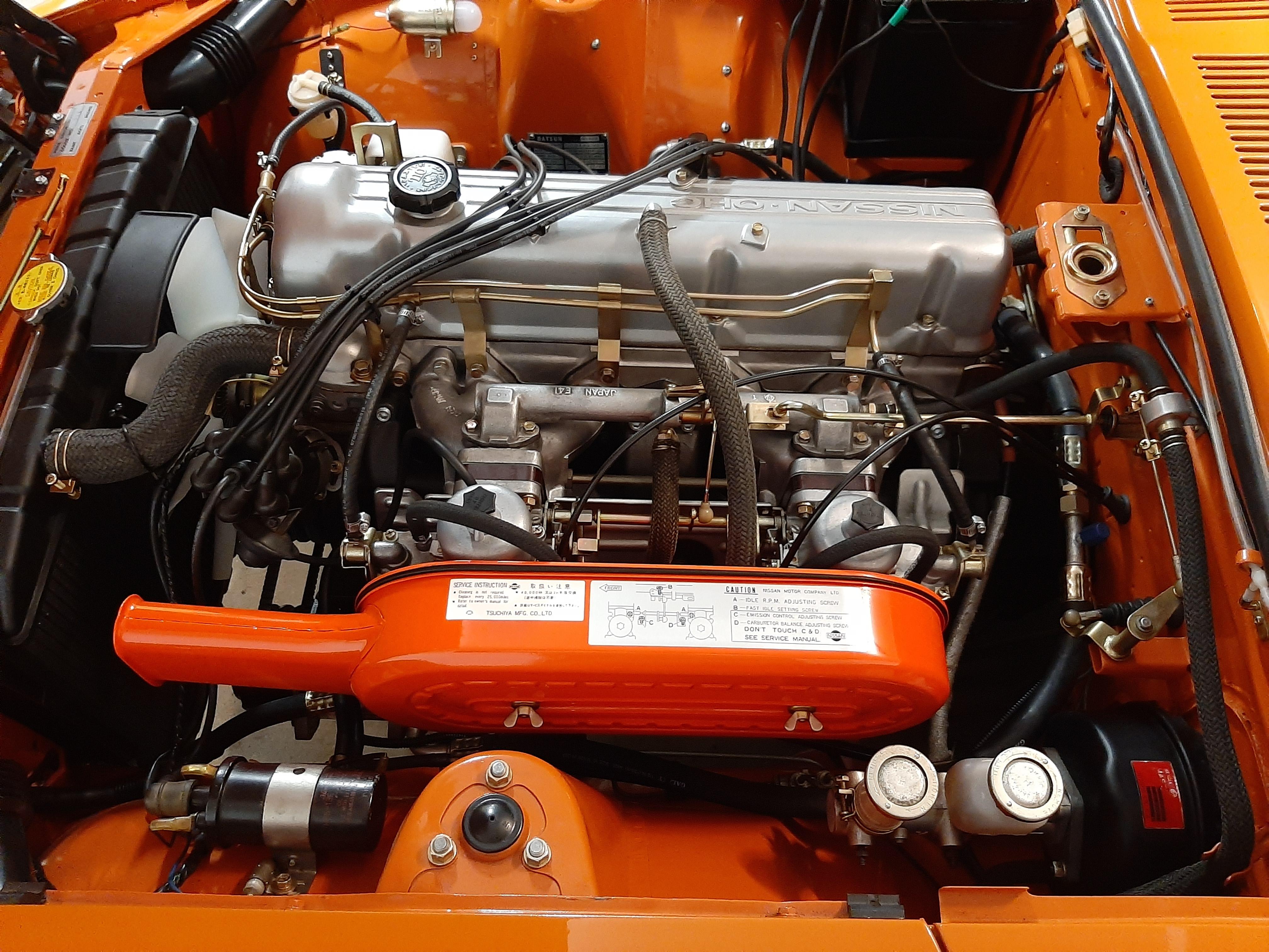

FYI, when I replaced the flat-tops on my '73 with round-tops from a '71 many, many years ago I bought a new thermostat housing and the metal coolant tube that runs around the back of the head from the intake manifold for a 1971. This eliminates the part you call the "sensor" altogether and routes the coolant from the thermostat housing through the intake manifolds and back to the water pump.  Using the 1971 parts also eliminated the need to plug the extra connections as there is no provision for coolant being supplied to these carbs. I have run the car this way for over 35 years and have had no problems; so my answer to your
"QUESTION: Can I just get rid of this 5/8" hose and sensor altogether for round tops? That would only leave the coolant flowing through the intake manifold on that side of the engine compartment."
is yes, if you are installing 1971 round-tops as that is the stock configuration.
