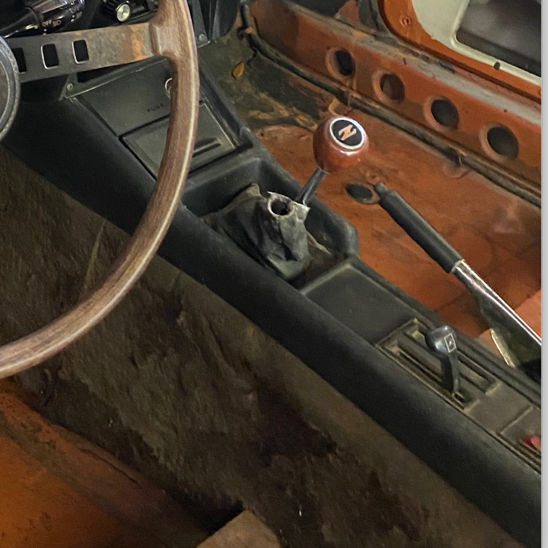

Not sure what an A style is but here is the center console it came with?
Long time ago i had a 72 and it had a different console...so i assume what i have now is an A style.
That is what I call a series 1 style console.  If you add a 5 speed you will have to make some changes to the metal in the trans tunnel and on the front edge of the shifter hole where the boot attaches the the console. Some people also add new bends to the shift lever. There a few threads here with photos of different ways to accomplish it.

If you plan on keeping it a stock original car by rebuilding the A transmission you would not want to cut the tunnel and mod it for a B transmission. (A on bottom B on top in pic. Longer tail housing, different shifter, different mount, different gearing)
If you plan on modding things anyway there would be no need to rebuild the A transmission, as the B or C style are a step up. Then you might also consider the 5 speed as 7tooZ says.
