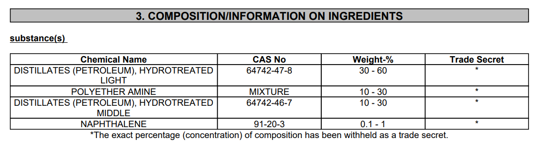

It's basically light oils and the PEA.  I found the MSDS on the web, below.  Like diesel or kerosene probably, hence the smoke.  No offense, but youtube is full of videos that show that those products don't really do much.  The carbon is baked on and condensed from years of heating cycles.  Found some cool stuff about petroleum distillates also.

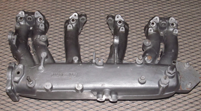

So on my test stand engine I rigged up a bottle with a feed control valve to the brake port in the intake manifold.
Did you check all six cylinders?  The booster port is offset to the back.  I wonder if all six got the same wash.
Picture from here - https://www.autopartone.com/products/79-80-datsun-280zx-oem-2-8l-intake-manifold
Edited by Zed Head
only looked at #5, yea it was prob a waste of time and money, boredom gets me in trouble sometimes.
