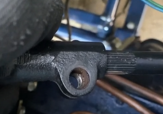

Well, the fun of the keep her on the road jobs continues.
I’ve been investigating a little slop at my steering wheel. At first I was afraid, I was petrified, thinking I’ll have to leave the Z car outside. Song over, I was sure it was the rack.
Then I discovered a little movement in the lower UJ ....
Having gone to bed thinking about it, I decided there must be more slop somewhere else. I had read about the splines in the collapsible steering column playing up but before condemning it, I decided to look further up the shaft and found something scary ...
Once I looked deeper, I was utterly horrified and went cold thinking about what could have happened. Thank God it didn’t and I may have to go sacrifice a goat as an offering of praise!

So did the clamping bolt fall out and the shaft was working its way free?
Sorry, I like to know the answer first then back fill with the details.
Edit - so I watched the third video and see that it was loose with the bolt in.  I didn't see the fix though.  I think that you could probably push your steering wheel in to get more bite on the clamp.  It probably has a gap up there somewhere inthe cabin.
I have vague memories of realizing that the shaft and wheel could be pulled in to the cabin once the coupler was detached.  From when I replaced the the coupler with a urethane unit.  I think that that is how I made space to get the old one out and the new one in.  It might be a wrong memory though.

So the issue I found was that the bolt was tightened very tight but from the wrong side!!! Meaning that the bolt was tightened against the threaded part and doing nothing at all in closing the clamp.
I sprayed the shaft in situ when I transplanted the new engine a couple of years ago, so the rusty 1cm or so has moved since then - I am assuming I can get it back to where is should be with what you mentioned.
The moral of the story was really that the clamp joint having zero tension had expanded enough (or splines / rust worn away enough) over time for it to become massively noticeable at the driver end. Just think what that would have done if it had let go on a hard 40-50MPH corner! Or worse still at silly speeds on a track with other cars around. My confidence in driving the car has been totally shaken, so the front of the car is slowly coming apart until I am totally happy with all bolts and the metal work being solid. Then I’m staring on the rear. Thankfully we have a week of sun forecasted so she can stay on the tilting lift on the driveway.

Yup, that’s new one I haven’t ever seen before. I can see how it could happen.
i do have to note that no matter which way you put that bolt in, there is a large cross groove in the splines that the M10 bolt has to pass through, that locks the splines from slipping out of the yoke. Yes, if its in the wrong way, or is loose, the splines can come loose and there could be play, but I don’t see how that joint could come apart as long as the bolt is still in place through the groove. If the bolt falls out, then yes, it can come apart.
If the splines were not inserted far enough so that the lock bolt can pass IN FRONT of the entire shaft, than that is a real problem, but I think the over all length constraints would make it hard to assemble all the components without realizing something was wrong.

Thanks for that. I did see the flat but hadn’t thought it through - it’s a clever fail safe. [emoji106]
