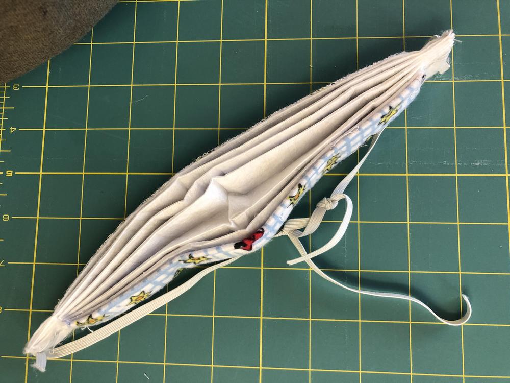

The pleats in the material is the secret to it’s expandability and easy fit to any face. The face fit on me is very very tight. All air goes through the fabric, nothing around. The nose bridge area will reveal a leak in 2 minutes if you wear glasses, as they will fog up.
There is also a small strip of soft formable aluminum in the nose bridge to make it a custom fit. The only such material I had around was some old Z door threshold plates. Had to sacrifice one old rusty one. The strip is 3/16 by 3.5”

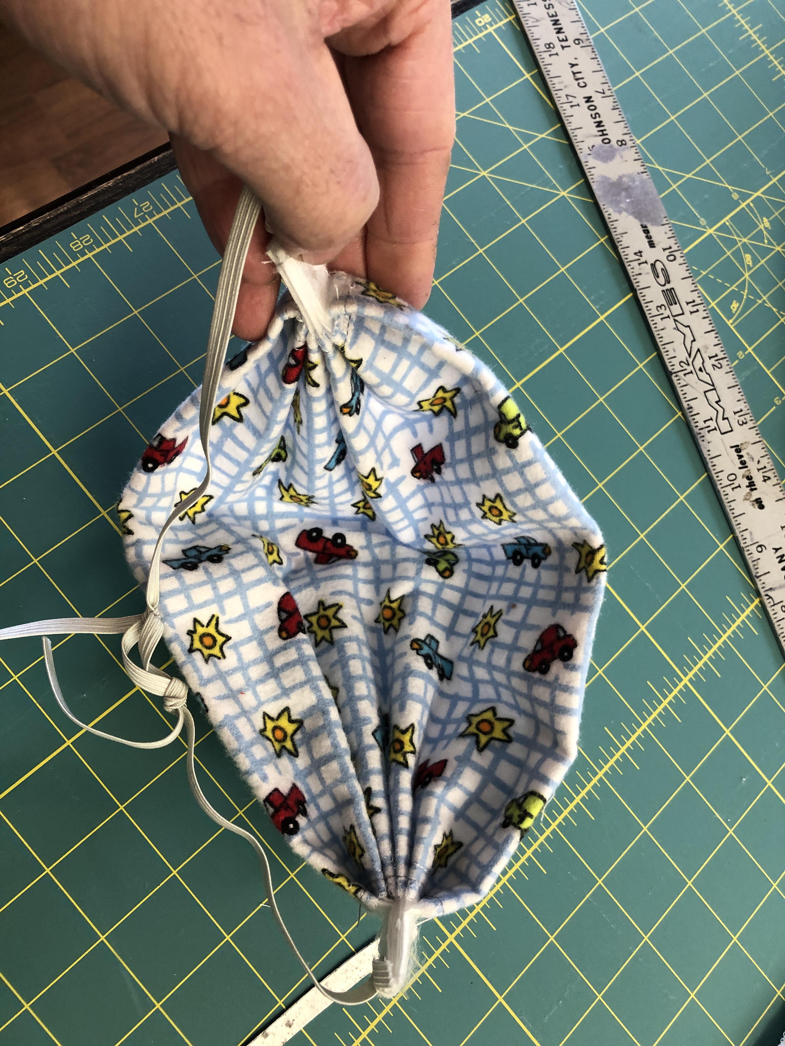

We lined the second proto type with flannel (baby patterns are the only thing around.... sigh...). The filter material is made of very very fine strands and will be form a bit of a raised hairy mess after some handling that will tickle the crap out of your nose. We added the flannel layer to give you something soft over your nose and chin and to line the INSIDE. This also gives an extra layer of virus trapping.
The top pleat is sewn shut and the formable strip is placed inside. The bottom pleat is also sewn shut. It forms the chin seal at the bottom.
The single elastic goes over the back upper part of your head. It provides exactly the right force vectoring to pull on the nose and chin section to keep them snug to the face.  Doing the ear loop thing did not provide enough tension.
The ends are sewn over with the pleats collapsed. Then I punch a 1/4 hole with a gasket hole punch to tie the 1/4’ wide elastic through.
