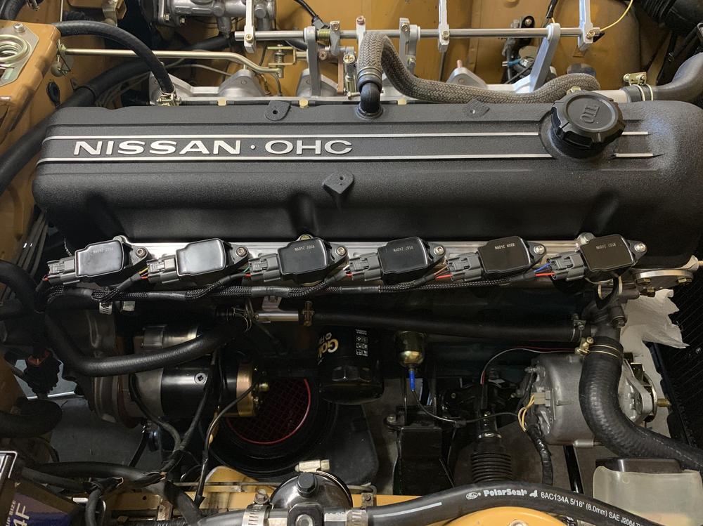

@duffymahoney  has the most local (this forum) experience I think.

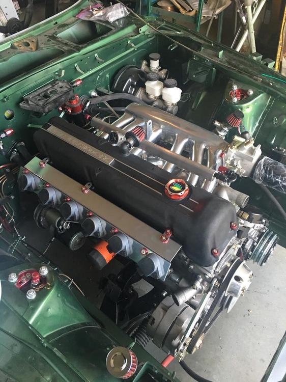

I used RB coils.  lots of guys have used LS or ford coils. RB is a stronger coil then the LS unless you buy the AEM version
I like Duffy’s set up for sure . His is prettier !

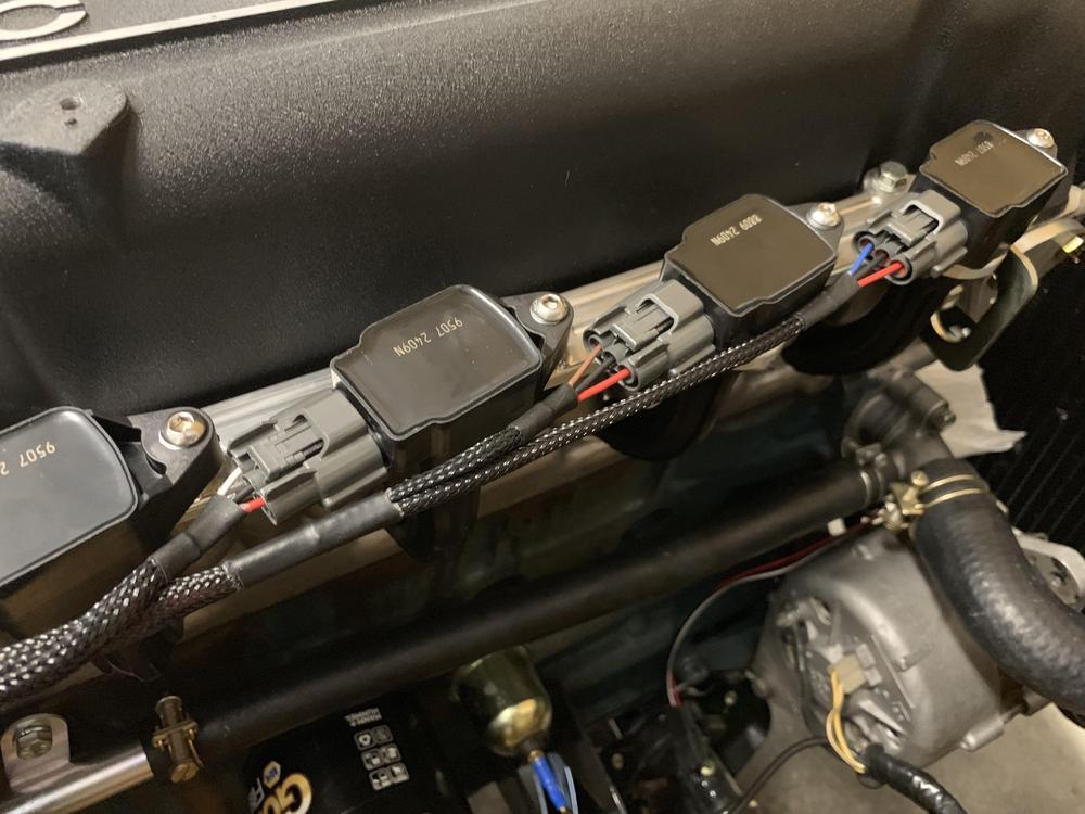

Heres the LS version - d-585 truck coils to be exact
