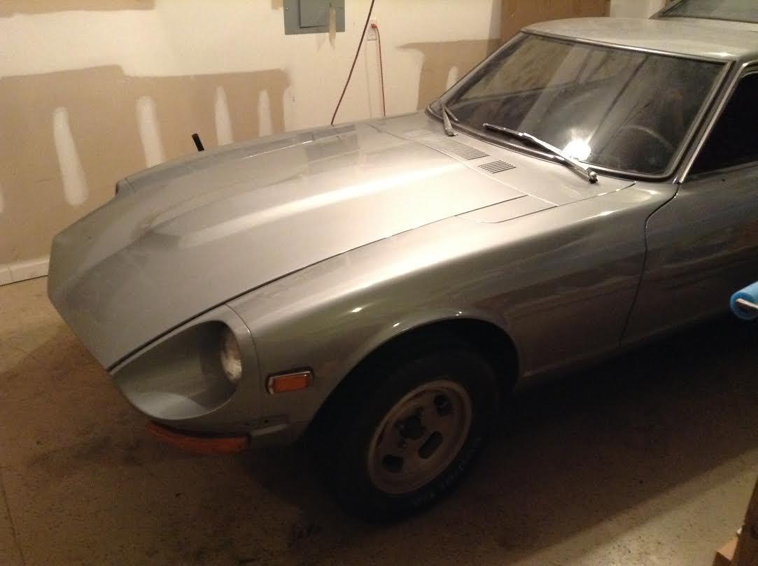

So I'm reassembling a 240Z with a restored body.  During the painting process, the body guys installed and aligned the hood with the fenders and cowl BUT without the torsion springs in place.
Now that I've got the torsion springs back in, they preload the front of the hood and pop it 3/8" or so above the line of the fenders.  See attached image.
Front-to-back and side-to-side alignment are perfect.
The hinges are slid as far down as they can go using the 3 bolts.  And the fenders and headlight buckets are pulled up as far as they can go in their bolt slots.
Is there anything else I can do to adjust?
Thanks for any and all help!
