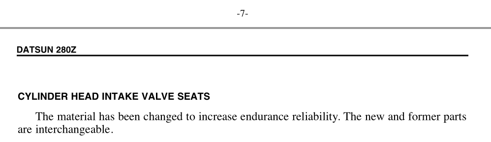

On the valve seats, I think that they might have went to the harder seat material for 77.  I think it's in the 1976 Bulletin.  Maybe somewhere else.  Vague memory again...
My  early 75 California model had a N42 head, the gas gauge says to use unleaded fuel and the exhaust system has a cat. I wonder if the bronze would have been used on that head? was it generally known that unleaded fuel would be an issue?. should know soon since I pulled the engine with the intent of finding the cause of the excessive oil consumption.
