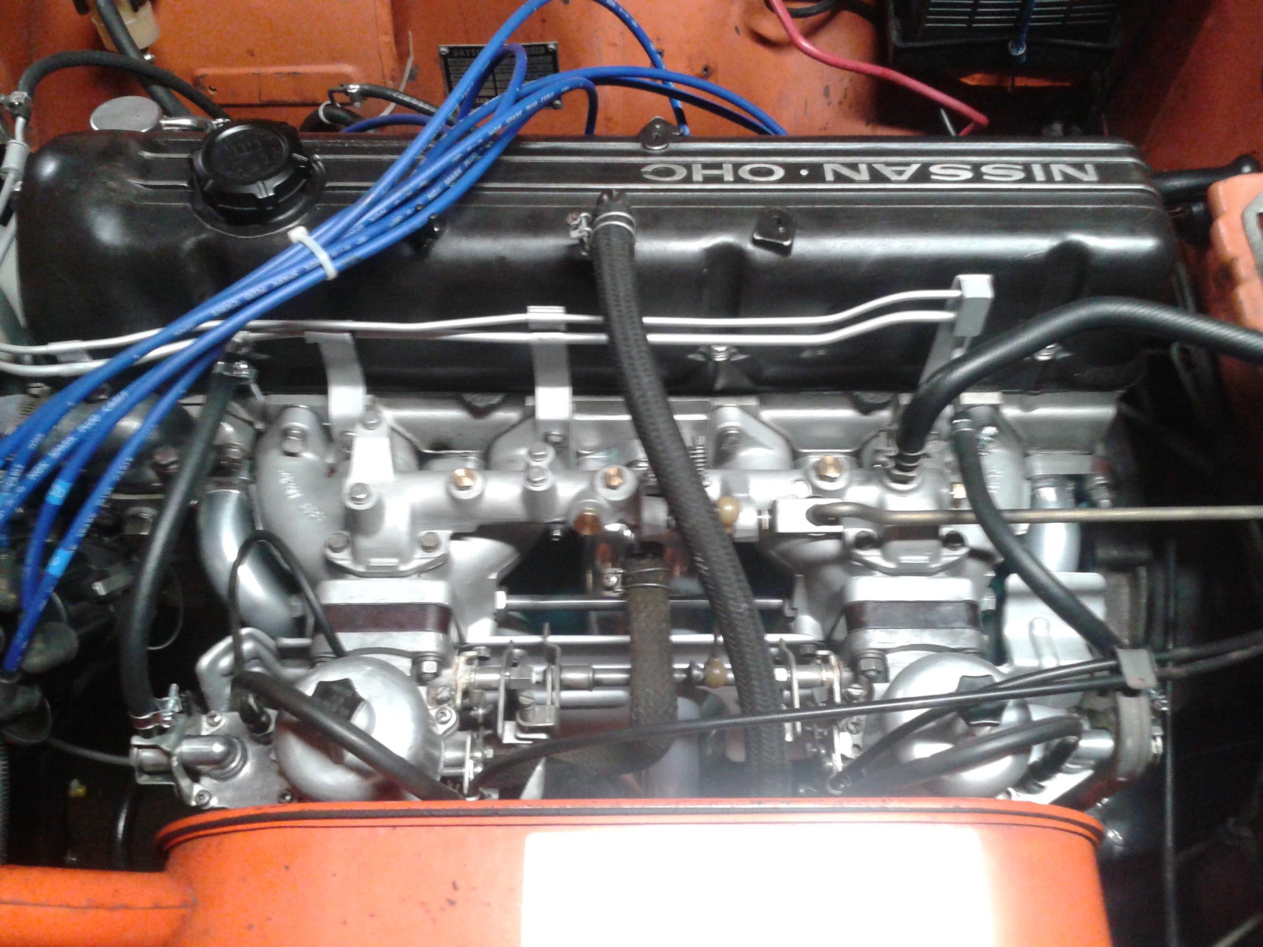

I put brass plugs on my 72's. Works great and looks pretty good. Not as good as rossiz's but good enough for me.
Gratuitous pic...
