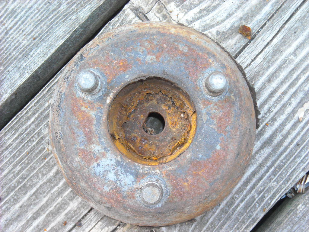

What I have seen happen, is that there is a D shape to the strut hat. The strut piston has a corresponding D shape to it. That is what keeps the inner shaft from spinning when you tighten the nut. If the D shape gets rounded out the nut will spin the piston shaft and it will not tighten. (I just grabbed this pic off the web to show the D notch in the hat).
If you look under the fender at the strut while turning the nut and see the inner strut piston turning as well the the hat is probably rounded out. Like what @siteunseen indicated.The proper fix is to take it apart and find another hat. Zip off the nut with an impact gun and see if the hat is rounded out, and see if you did in fact strip the nut. You could impact drive the nut down to tighten it but that is not a proper fix.

Its hard to see on those thread, but you should have a noticeable flat on the threads that engage the D shape of the strut mount insulator. What was the strut cart you used?

It looks to me like the shaft is not through the D shaped hole.  The shaft should penetrate farther through the nut, in your picture.
Just a possibility......
That's funny, that is my photo back from when I had a look at making shock mounts.
Uh-oh looks like I snagged a photo without paying the royalty fee. ?   Your .0296 cents is in the mail.
I bet a lot of the google images are from this and other forums.
