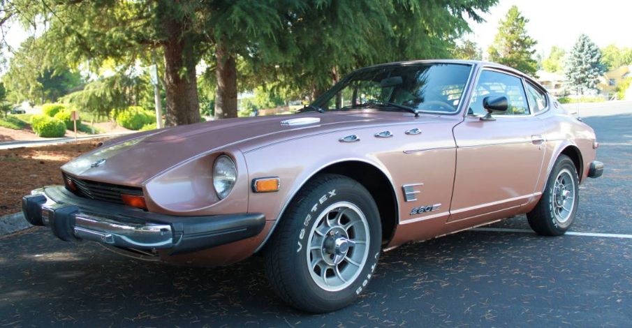

@Robert9790 Portland, Or. Craig's List "1976 Datsun 280z - $7500". Post id 6973601510. Interesting Z. It's an injected automatic but if the body is good it's reasonably priced. I hope the sidewall ventiports (Buick's name for them as I recall) and other decorations on the fenders are just glued on. The wheels are A.R. Vectors.
