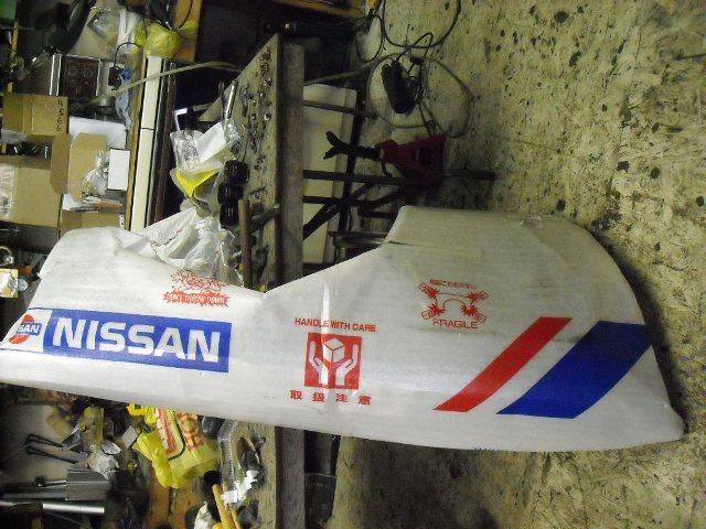

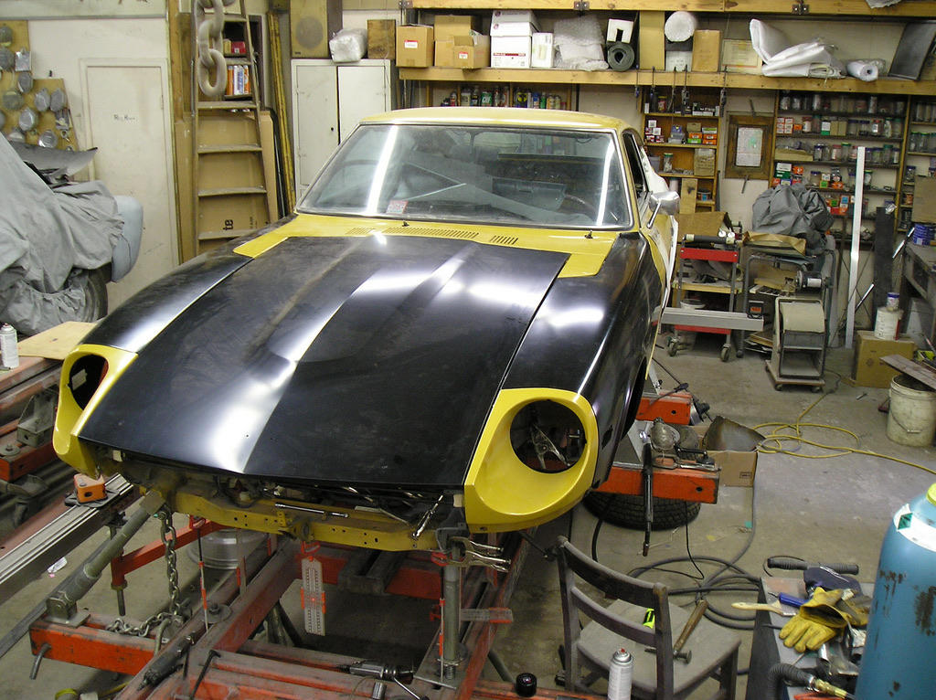

Well just to make it more difficult, I bought two new front fenders from Nissan back in 2012 and both were black and both were re pops.  Well done re pops but still not pressed out with the Nissan molds.  I wish I had taken more detailed pics but parts were still plentiful back then and not expensive.
