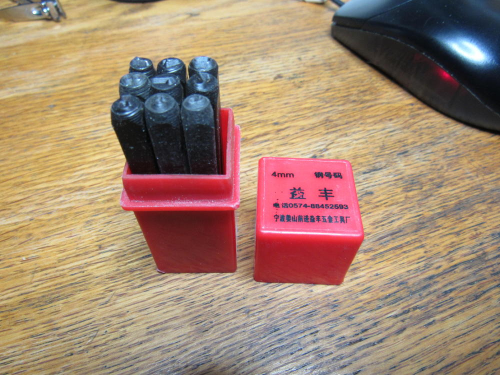

April 19, 20196 yr comment_573638 Mike, You are looking for 4mm punches, I got these on Amazon for $8. Nissan's spacing is closer together than the punches so you can't just stack them side by side. I tried making a jig so I could get the consistent look of the original but it didn't work well so I guess I will just have to free hand it. I haven't done mine yet, still practicing on thin aluminum sheet. I'm going to document it and include it with the cars papers so some future owner can't be accused of doing something fishy. If you come up with a better way than free handing please let me know. Link to comment https://www.classiczcars.com/forums/topic/62024-replacement-door-plate/#findComment-573638 Share on other sites More sharing options...

April 20, 20196 yr comment_573747 On 4/19/2019 at 7:32 AM, grannyknot said: a better way than free handing please let me know. Dig around on the web for input on this. Engravers have been making indexing fixtures for this sort of thing forever. With a little creativity, I'm sure you can come up with a way to index either the stamp or the target less than the width of the punch shank. Link to comment https://www.classiczcars.com/forums/topic/62024-replacement-door-plate/#findComment-573747 Share on other sites More sharing options...
April 20, 20196 yr comment_573768 What about grinding the punches, so they are narrower? Link to comment https://www.classiczcars.com/forums/topic/62024-replacement-door-plate/#findComment-573768 Share on other sites More sharing options...
April 20, 20196 yr comment_573801 5 hours ago, Patcon said: What about grinding the punches, so they are narrower? I like the way you think Charles, just wish I had thought of it first? Link to comment https://www.classiczcars.com/forums/topic/62024-replacement-door-plate/#findComment-573801 Share on other sites More sharing options...

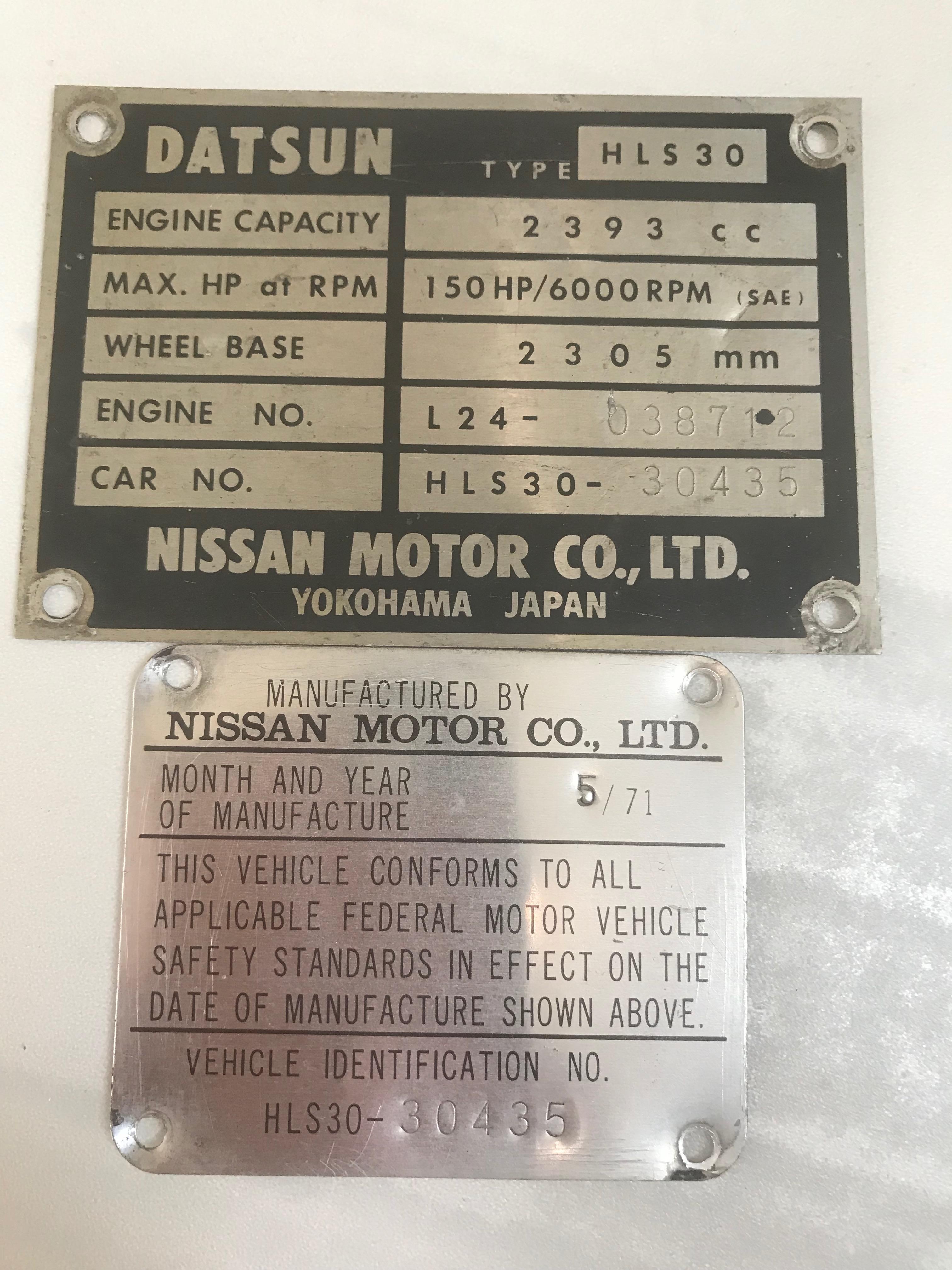

June 9, 20195 yr Author Popular Post comment_577243 Well, I have some EXCELLENT news! While going through my files trying to find some other stuff, I ran into a box with my original 1971 radio and at the bottom of the box were these: Link to comment https://www.classiczcars.com/forums/topic/62024-replacement-door-plate/#findComment-577243 Share on other sites More sharing options...
