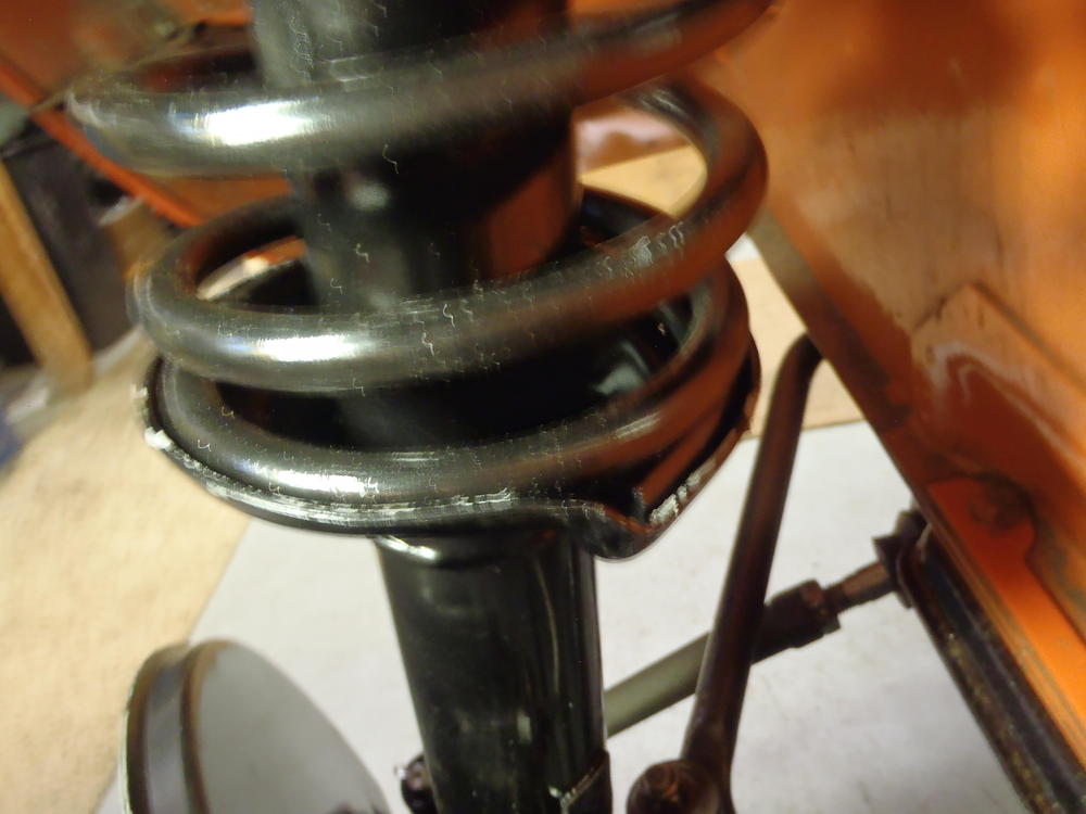

Yes, this is a stock, non-coil over, setup.  My intent was to replace the 48 year old strut with something from today.  Direct replacement.  I'll have to recheck the springs but I'm pretty sure they were against the bump in the upper and lower cups.  But if it's the springs, I'd have to have screwed up the same on both sides as it seems to be level.  Nothing obvious, it may be a little while before I get to tear back into it as I've got another car I have to get prepped for a trip in July.

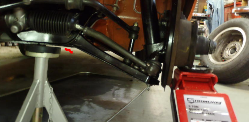

I jacked up the lower control arm to the point the car just started to lift off the jack stands then tightened the control arm bolts.  This should be pretty close to tightening them with the car sitting on the ground (minus the two people).  I took it around the block again this morning and the wheels are still pointed in at the bottom.  I'll take it apart tonight and post some more, better pictures tomorrow.
OK, here's how I set the suspension when I tighten the lower control arm bolt.  Minus the two people sitting in the seats.  You can see the gap between the jack stand and the sub-frame.

Here are some pictures of the suspension as it sits now.  See anything amiss?  It looks like the springs are all the way in position in their cups.  Also, the upper bearing is set with the fixed or cup side up and the rotating part of the bearing down against the doughnut?

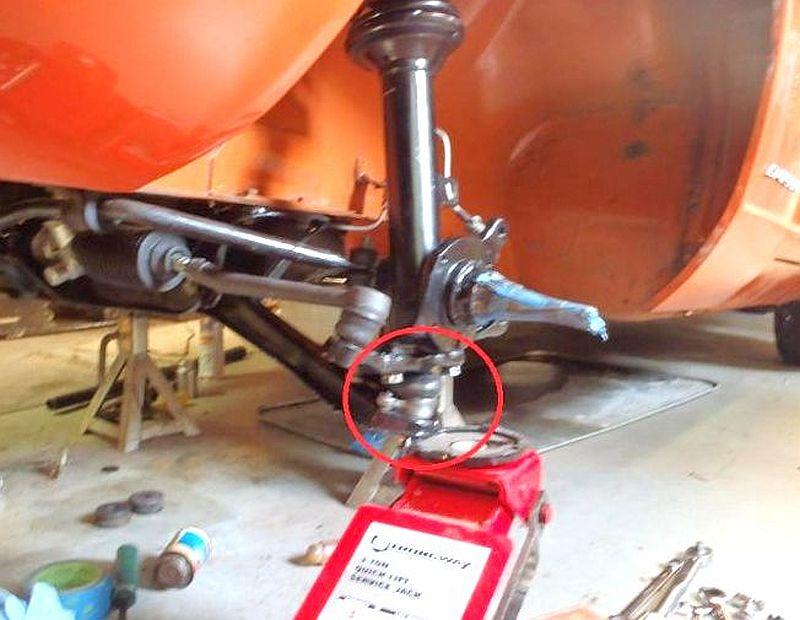

I see two things potentially wrong... First is that the floor jack appears like it could be pushing inward on the rotor and helping limit the natural outward movement of the hub as the suspension tries to move upward. Might be better to rotate the floor jack ninety degrees so the little wheels on it will allow it to move easier inward and outward with respect to the center of the car.
The second thing? I can't see the right side front wheel but I suspect it's hanging free? If that's the case, then your sway bar (roll bar, anti-sway bar, etc) is fighting you. Just like it's supposed to do. In operation, the sway bar tries to keep the levels of the two front wheels the same. So if you've got one hanging and the other being pushed up by a jack, you're twisting the torsion spring that is your sway bar.
You might try temporarily disconnecting the sway bar. Or better yet... Just lower both front tires onto a pair of roller bottom moving dollies. That will allow them to squirm to their proper position and then tighten up the transverse link bushing bolts while the suspension is loaded.
