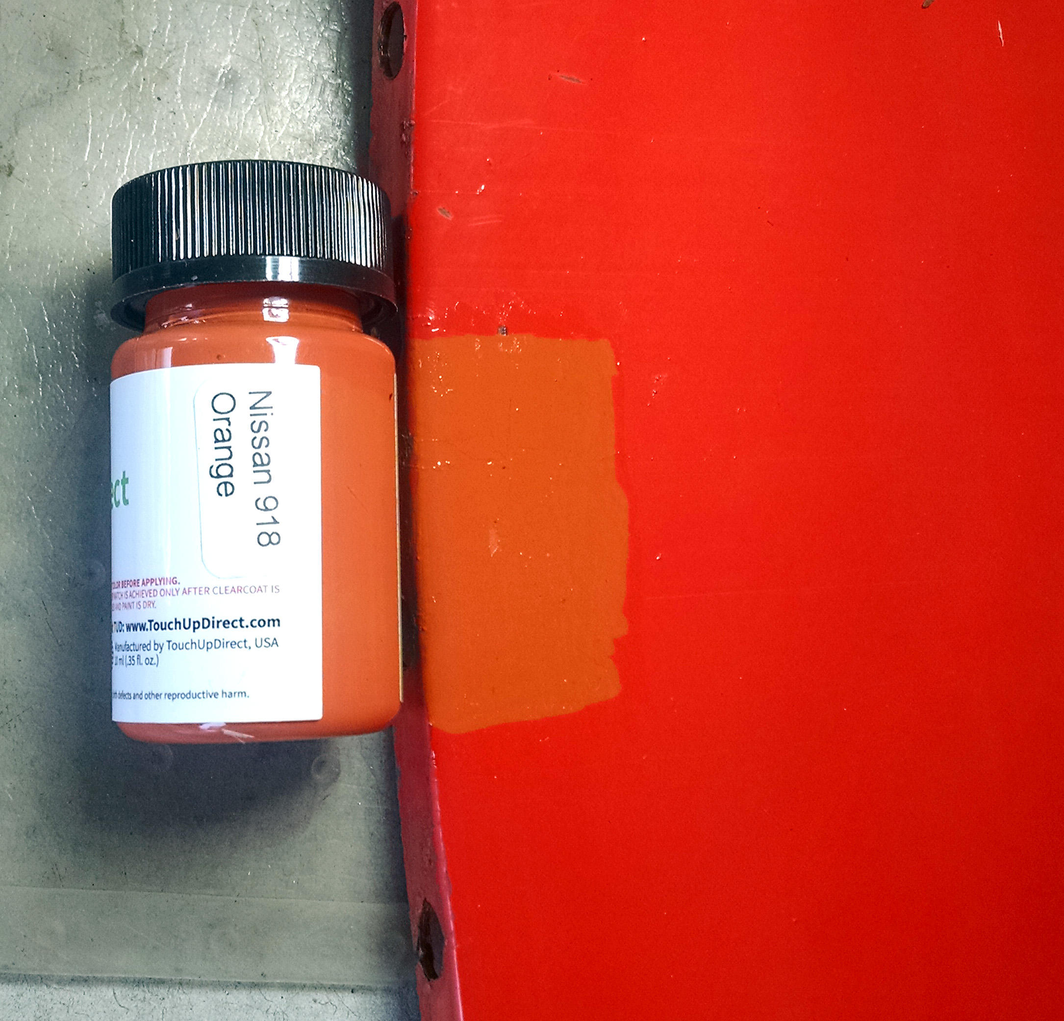

I did order some touch-up paint from a PPG supplier and it was not even close to the original on my car, hence the question.
aut
Yeah, that's not even close. I wonder if it would look like that if you went to an actual PPG autobody paint supplier? Not a third party vendor

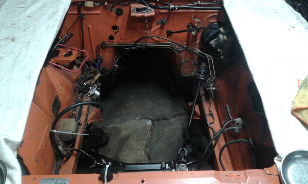

The silver sticker says 918. Pretty sure it's original. Here's a shot of the engine bay which looks more orange than the other shot.
That's a tough call.   know the sticker says 918 but it sure looks like 110 to me as well.  I bought some touch-up 918 off amazon.com and it matched perfectly.

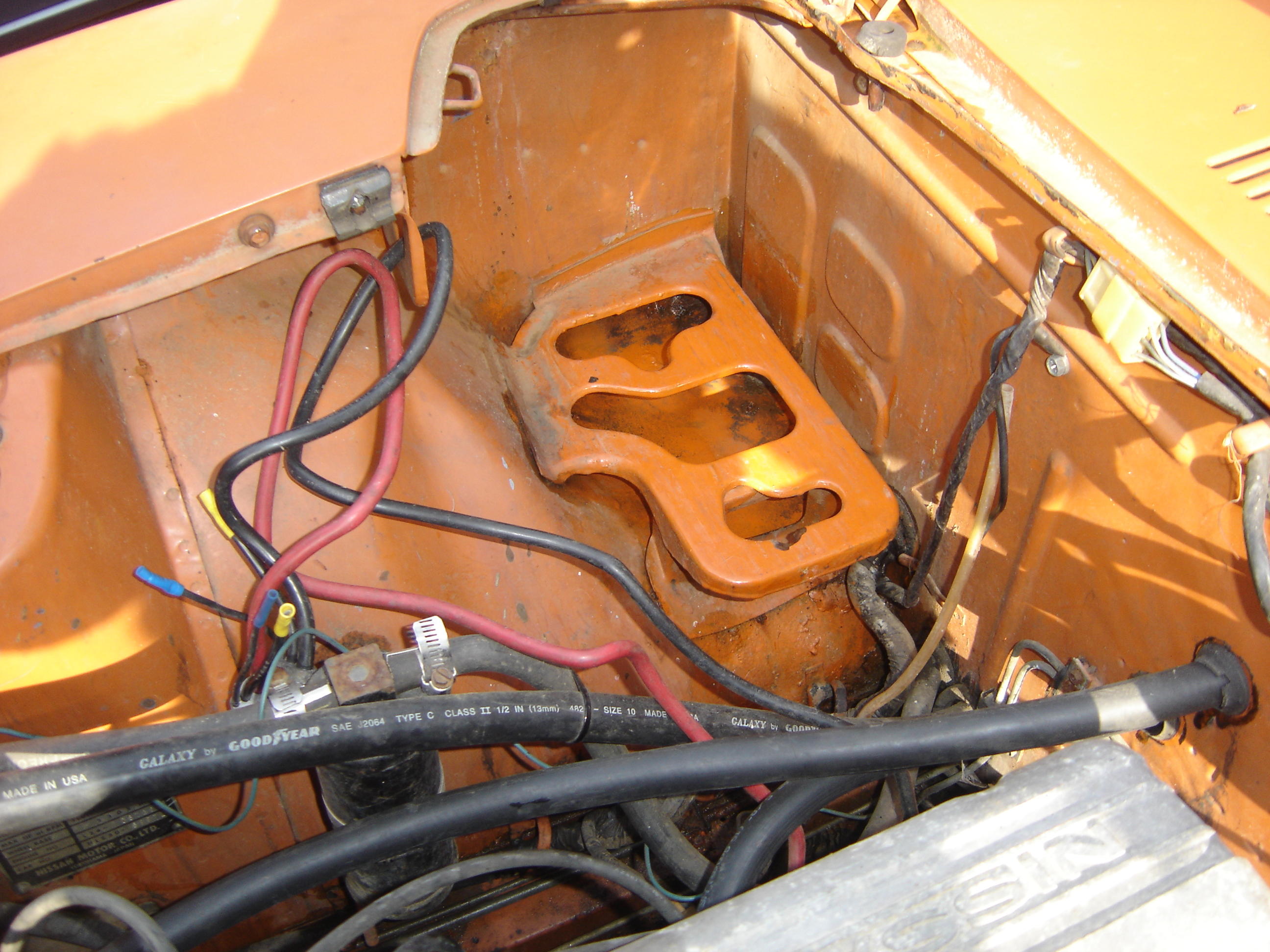

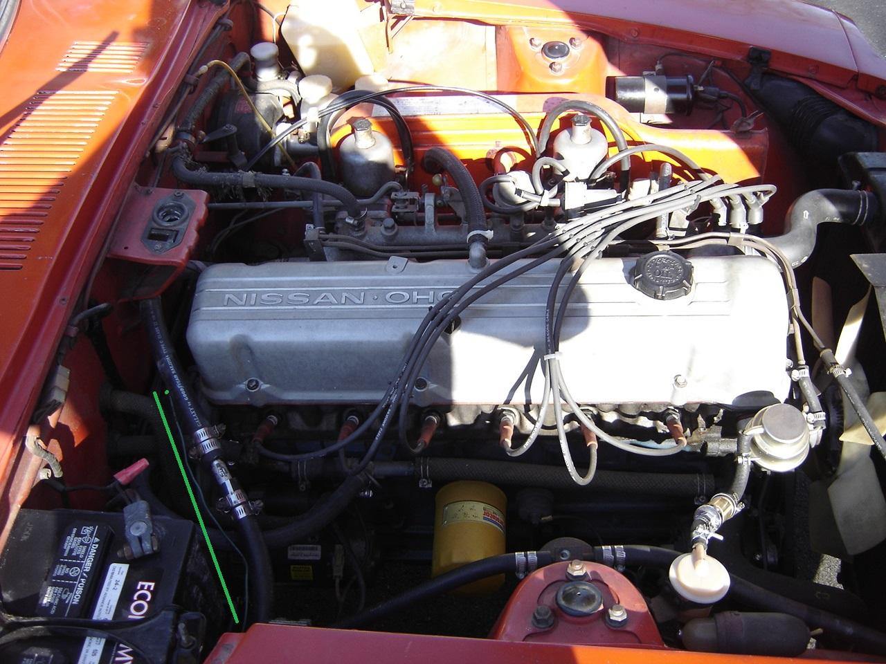

Here's some pics of the two I've owned, 110 and 918.
918 original single stage paint from '72 in different lighting...
110 original paint from '72...

I agree.  (and, 110 oxidizes toward orange over the years - even so, it's always completely different than 918 which is definitely a "burnt orange" without any apparent red in the tint - and 918 would never oxidize toward red)
The engine bay is probably not the place to look for original color.  Best to look for the factory overspray on the interior of the car.  Check the spare tire well first, but it may have been shot over as well.  Definitive proof is usually under the vinyl on the pillars...
If it's 110 - oxidized 110 - the color you get from a supplier from their stock formula will never match the oxidized paint.  It will be a deeper red.  Remove one of your side maker lights and look at the paint underneath.  You may see that it's darker, more red.  If so, it isn't stained - that's the original unoxidized color.
