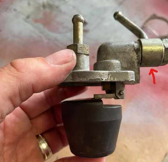

Where would the banjo fittings be that the last chance filter would be affixed to?
  1. Make sure you have rebuild kits on hand. You need to replace gaskets and crush washers.
  2. Attach the lid to the float bowl before you try to remove the bolt holding the banjo fitting in place.
  3. Here's the filter: https://zcardepot.com/products/copy-of-fuel-filter-carburetor-oem-240z-260z-70-74?_pos=17&_sid=da1c07df2&_ss=r

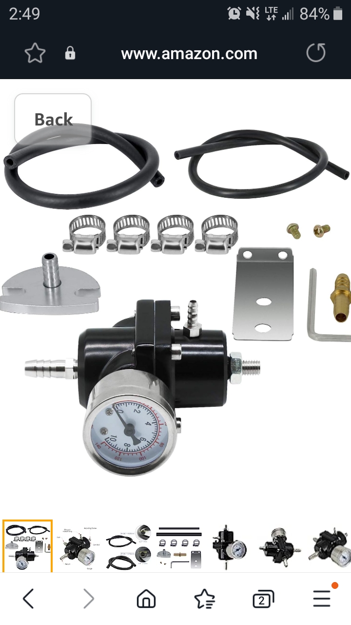

On 4/7/2023 at 6:52 PM, MM569457 said:
Could you adjust PSI on a mechanical pump? I’ll check the needle and floats
There isn’t any provision for adjustment to the stock mechanical pump, and electric pumps usually don’t have a regulated output. You need a fuel pressure regulator and a gauge (0 to 10 psi). The cheap regulators with the round adjustment dial aren’t worth the money or the trouble.
I recommend the Holley regulator (there are two, one for low psi settings, one for high psi, get the low psi one).
SU carburetors won’t tolerate pressure over 2 or 3 psi.
This is similar to what I have, 1 to 4 psi. The gauge can be plumbed into one of the outlets.

A few weeks ago the front carb did spit out fuel through the vent hose ontop of the float chamber. I'd assume the best place for a regulator would be after the mechanical fuel pump before going into the fuel rail?
