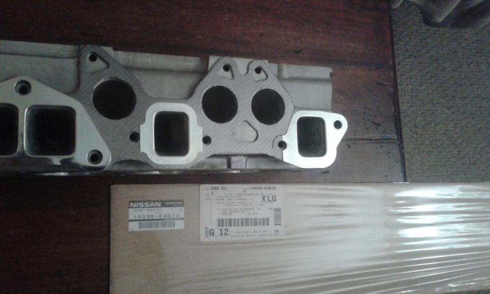

+1 on copper coat,  have used it also for many years.  Used it when I redid my in/ex gasket 5 years ago.  Used a Nissan gasket.

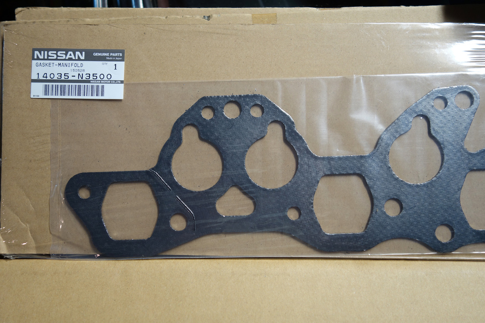

When my 240z was 37.. i only used a nissan gasket.. no sealers..  Personally i would not recomend any sealer there.. it gets very hot.. an extra resurfaced in/outlet side is recommended.  But as zedhead says, a good gasket is important.. there are more threads with this question.. what's the best gasket?

I also used that E4610 if i remember correctly.. :unsure: (in 2007... it's still in there today.. doing what it's supposed to do haha..) My car was running with just the one problem that all seals were bad.. so i bought a complete set for the L24 from Nissan.
