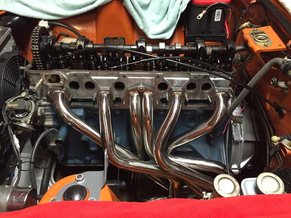

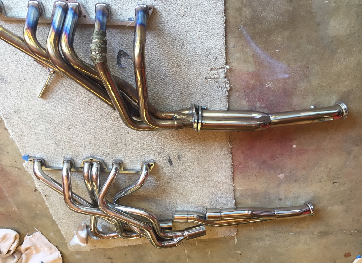

Trial fitted a new header.
Updated E31 ready.
Comparison of new and previous headers.
What gasket yiu going to use on the header? Or just RTV?
I've got the steel or chrome sided one from Nissan part number in my 240 file. The dealerships still can get them if you want it.
https://www.classiczcars.com/forums/topic/59544-intakeexhaust-manifold-gasket/?do=findComment&comment=542398
Sean at Zstory supplies the gasket. Worked well in the first header. These headers have massive flanges and seal up great.

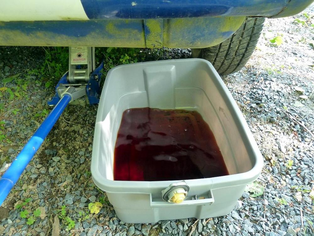

Did a few things this evening after work:
Drained the gas tank...looks like a nice dark ale. Vintage 2007.

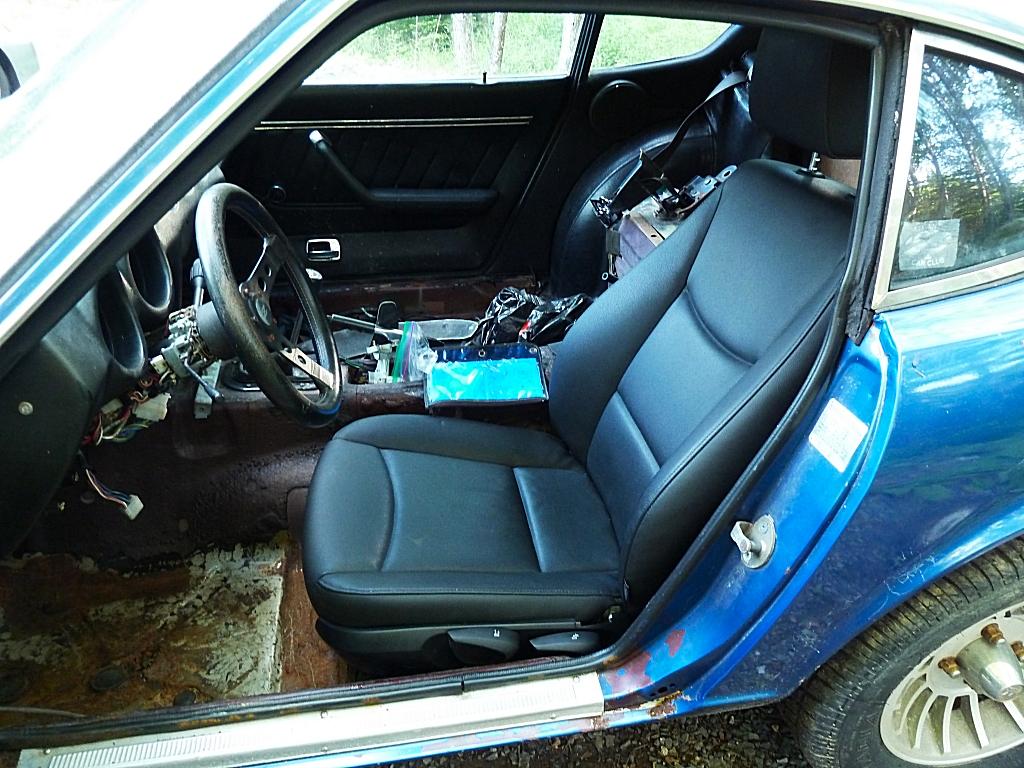

Removed carpets, removed the the tar barrier from the floor pans, vacuumed the interior and test fitted a BMW seat.... comfy!

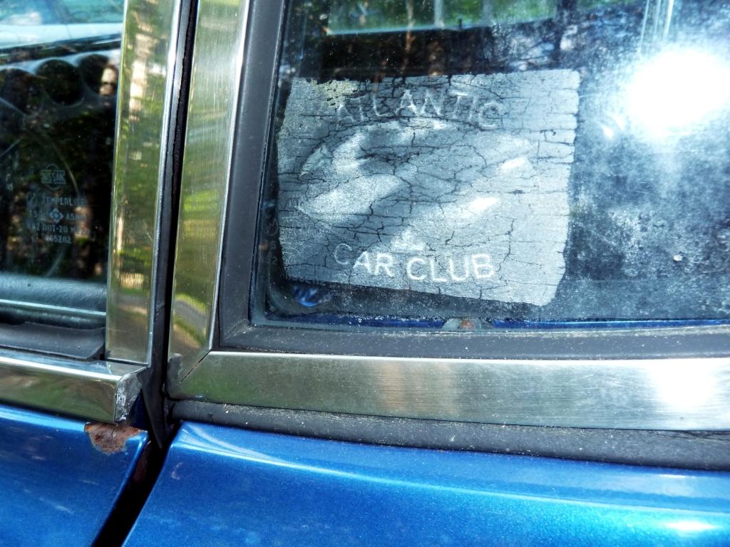

Looked at the past good old days before 2006 turned my life upside down.

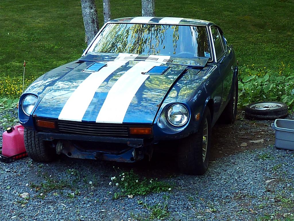

Good ol' Blue
