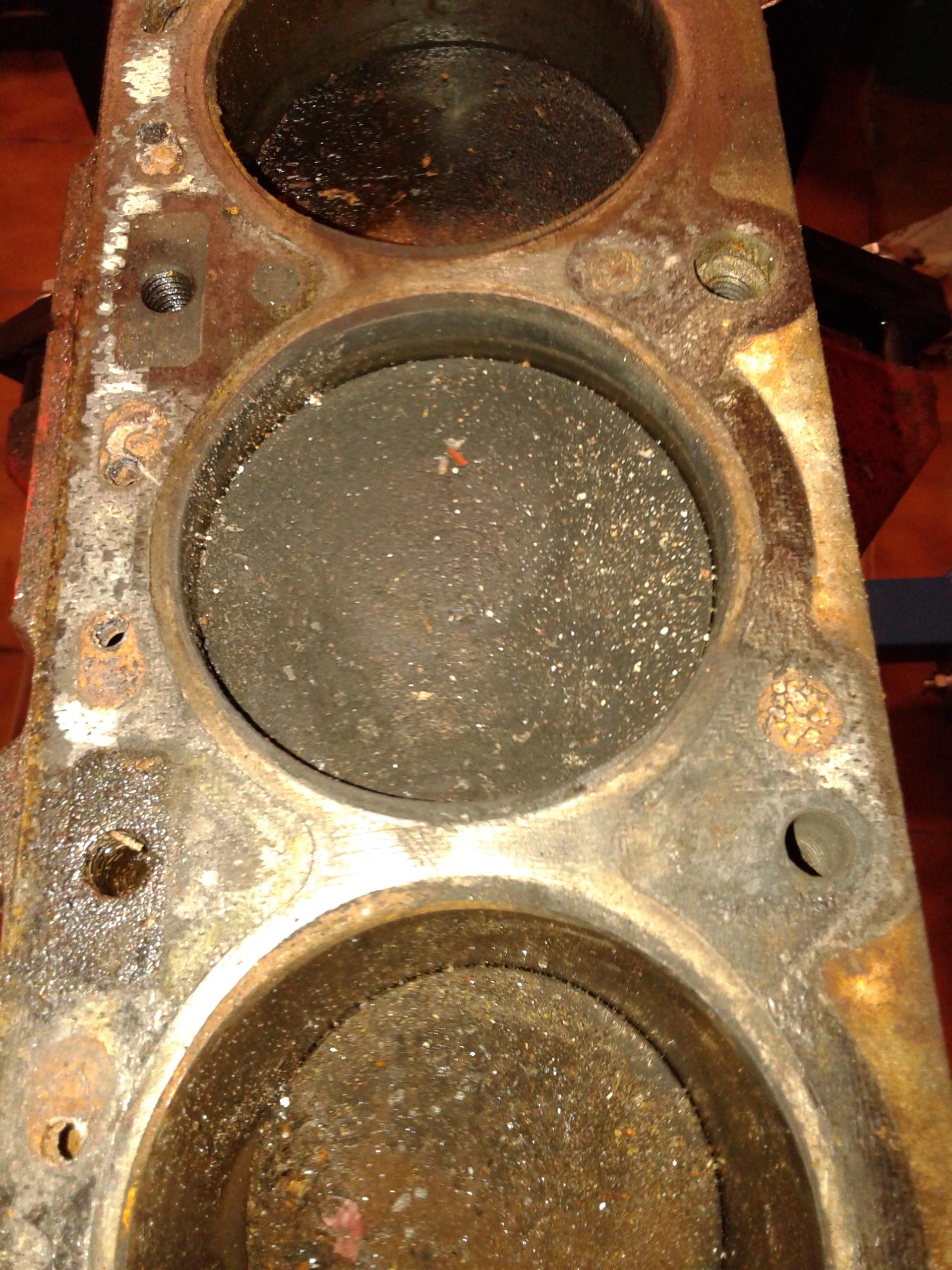

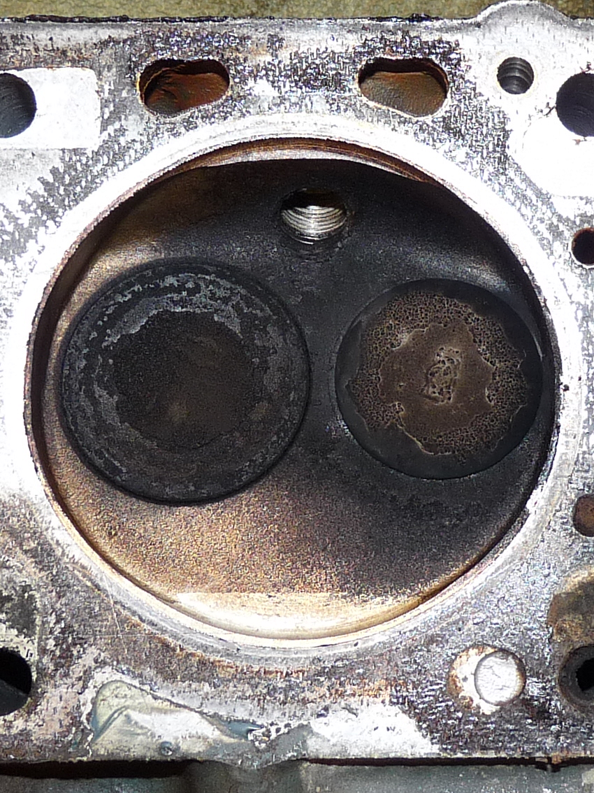

Below is photo of stock E88 combustion chamber from an earlier 260z.  It seems to have the deeper pocket for the piston.
I wish I cc'd it.  It is now at machine shop getting 1mm shave and valve job. I'll check deck height soon.

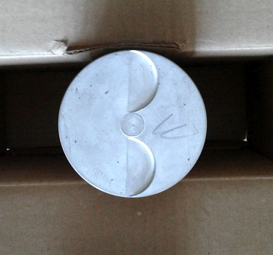

The pistons do not have fly cuts however the link below shows 260z pistons with fly cuts and 38.1mm compression height.  I wonder if the odd pistons were for 73 and part of 74?

The 1973 FSM gives a compression ratio of 8.8 to 1 so working backwards the volume of the 1973 E88 is ~49cc.

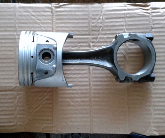

Glad you found these specs on the 73 Nissan piston Blue. I had noticed the taller piston back in 2012 when I bought some .040 over 73 pistons from my local Nissan parts guy (they were still available). I tried to find out more info, and no one could help.....not even Sam Neves (built Greg Ira’s car) or Dave Rebella. I shaved the pistons .015 inches just to be safe. If the gasket is approximately .055 inches and the piston comes out  .027 inches, you have .028 inches clearance. If that isn’t enough, you either shave the piston or use a thicker head gasket......question is how much (or little clearance) is enough.......anyone got that answer?

22 hours ago, siteunseen said:
Damn! Mine doesn't have those cut outs.  I'm guessing those are original equipment?  They look unburnt or just super clean.
Yes these are original equipment. I purchased them when they were still available.
The person rebuilding the motor wanted me to get these.
